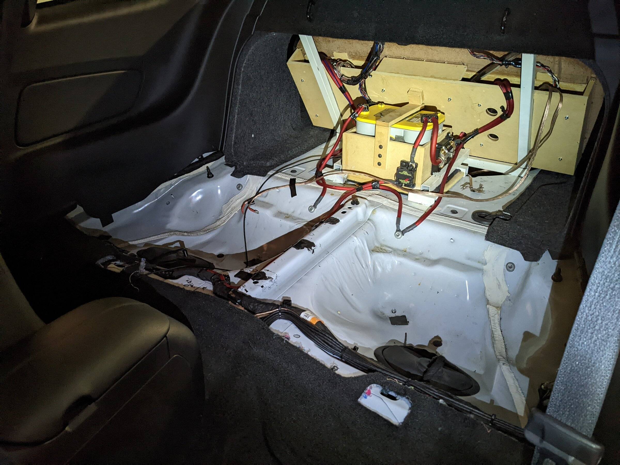

Bits of Stereo:
That's right, you can see 4 different channels in that second photo. There is a 5th channel installed up on the dash, in front of the A pillar, blocked in this view. The speakers are supposedly something really special, and was told the lower door speaker is something like $2k. I don't know, never confirmed it, but when I took the car to the audio shop and told them I wanted all of it removed, they looked at me like I just ordered them to shoot their dog. Long story short, they talked me into leaving it for the time being, and as we had #2 on the way in June 2021, I figured I could at least cruise around in the car with a thumpin' stereo until I got the go ahead to start going hard after our daughter turned 6 months old. And if those speakers really are that valuable, well I just got that much more money for modifications.
