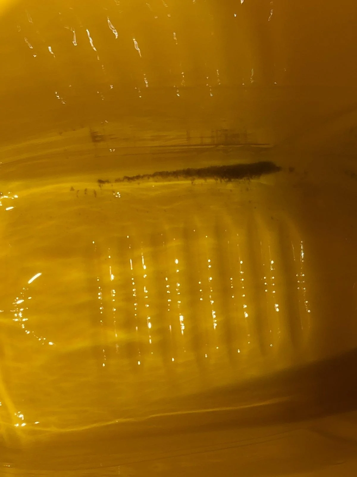

You're right. I was referring to the older test done on the version they had a few years ago. I too am going to switch to PUP 5w30 and a small amount of Ceratec to supplement to Boron content. But that's about it.
When I found out that the Mobil1 5w20 I put in, is marginally better than the Motorcraft 5w20 in shear strength, no wonder my BBQ tick didn't change much. Since it seems to be pretty much gone right now, I want to switch to something better like PUP 5w30, and hopefully never have it come back.
Remember to check for this when you get your Pup.
