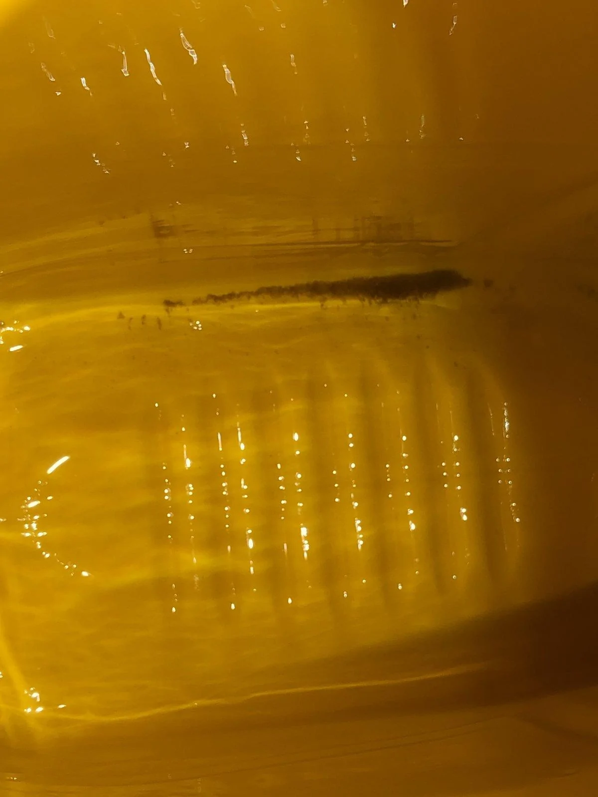

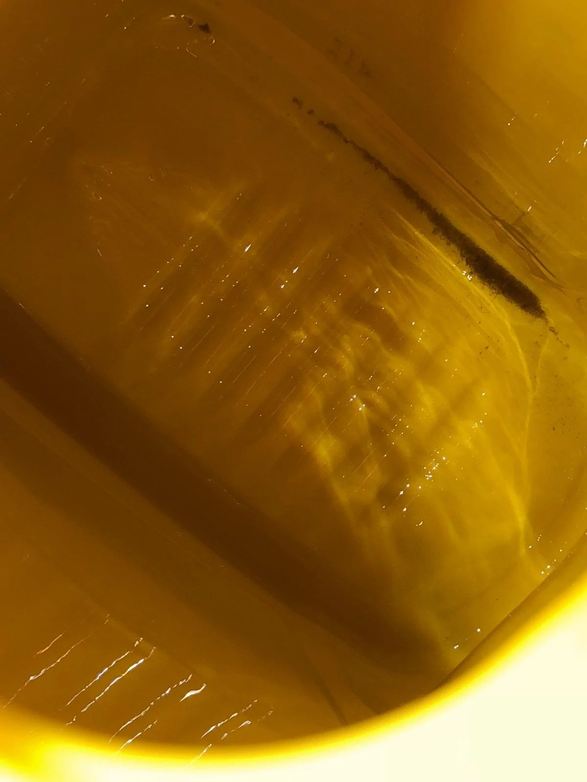

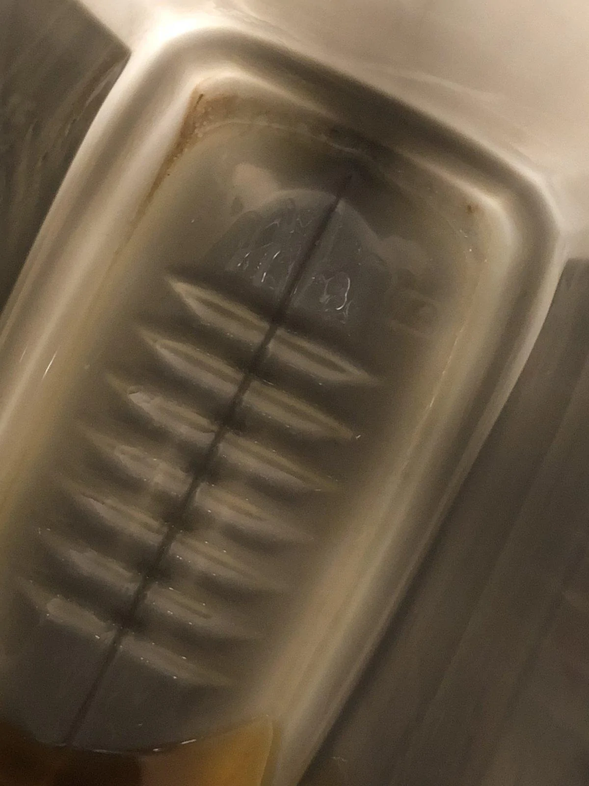

I had an interesting observation while changing my oil tonight, you have to SHAKE your jug of oil vigorously before completely emptying it into your car. Why? The additives are settling and they really STICK to the bottom. I watched this video (see bottom of post) a few days ago and this guy discovered the settling in his 10W30 Penz Platinum, Pennzoil responded that this is normal and I believe them. So when I changed oil I looked into the first 5qt jug (5w30 Penz UP) when it was almost empty and discovered this, a LOT of additives! Also, I shook the jug for about 10-15 seconds before I opened it. I had an empty jug of Mobil 1 full syn 5W20 from when I changed my Focus’s a few days ago and I looked into the nearly empty jug to see additives stuck to the bottom of it as well. Am I the only one who didn’t know you had to vigorously shake your oil before pouring? Could this small amount of additives be the difference between BBQ Tick and no tick? I am happy to report I do not have BBQ Tick after this oil change. I’m not sure if the TriboTex is still “curing” it or maybe the Pup oil with ALL the additives are helping.. or both.

I had an interesting observation while changing my oil tonight, you have to SHAKE your jug of oil vigorously before completely emptying it into your car. Why? The additives are settling and they really STICK to the bottom. I watched this video (see bottom of post) a few days ago and this guy discovered the settling in his 5W30 Pup, Pennzoil responded that this is normal and I believe them. So when I changed oil I looked into the first 5qt jug (also 5w30 Penz UP) when it was almost empty and discovered this, a LOT of additives! Also, I shook the jug for about 10-15 seconds before I opened it. I had an empty jug of Mobil 1 full syn 5W20 from when I changed my Focus’s a few days ago and I looked into the nearly empty jug to see additives stuck to the bottom of it as well. Am I the only one who didn’t know you had to vigorously shake your oil before pouring? Could this small amount of additives be the difference between BBQ Tick and no tick? I am happy to report I do not have BBQ Tick after this oil change. I’m not sure if the TriboTex is still “curing” it or maybe the Pup oil with ALL the additives are helping.. or both.
I saw it in the jug of my pup. I still have the jug. Will have to try to get it out and pour into the engine :)
Here they say it is not necessary to shake the jug:
https://www.bobistheoilguy.com/pennzoil-q-a/
That’s a good idea. When I started adding oil from the second jug I poured half into the first empty jug and the second jug had a lot of additives in the bottom of it too. So I shook the sh#$ out of it and then poured all the oil back into it, shook again and then went about adding the rest of the oil.

Notice in that UOA collection that Motorcraft and Mobil 1 seem to shear down in viscosity more than the other brands. That's why I went with Valvoline Advanced 5W-30.
Also, I looked into the 5qt jugs of Valvoline and saw absolutely no sediments on the bottom. Valvoline Advanced has some moly in it too, and a high HTHS and low Noack. It's also SN dexos1, Gen2. I researched 5W-30 oils a lot, and Valvoline was the best overall package IMO.
