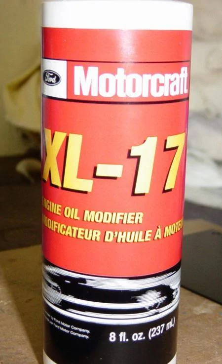

Ford use to have guys use this for the BBQ Tick ... which isn't made any more.
