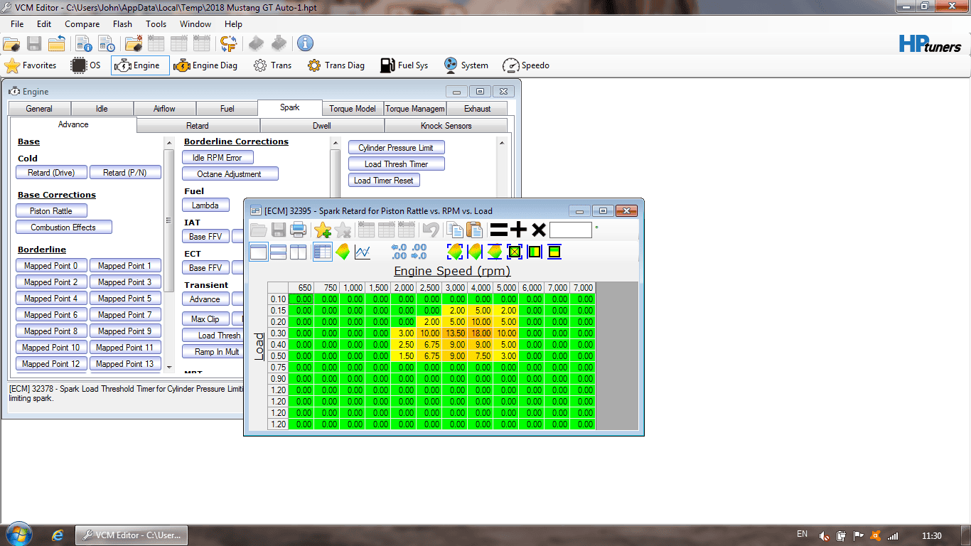

The data files show an adjustment for piston slap. I wonder if our lower power rhd cars have a more conservative map?
I wonder if knock sensor is fooled by the rod/piston/whatever sound and is retarding ignition.
That would mean engines with this issue might not be producing advertised power.
