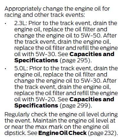

That is the perfect oil for these cars. Ford has even changed to recommend 5w50
Ford has not ever recommended 5W-50 for the Coyote. Look at any 2015+ Coyote owner's manual or service manual. The only time 5W-50 is recommend is when Roush puts a supercharger on a Coyote.
Not correct. They recommend it for track use. It is in the manual.
It certainly will not hurt the engine.
Which year(s), and which manual?
I know for a fact that the 2015 OM or SM says anything about using 5W-50 for track use. The 2018+ OM says to use 5W-30 for track use. And the 2015 OM says absolutely nothing about using any heavier oil for track use.
Yes, it won't hurt to use 5W-50, but that wasn't my point.
Snip-it from the 2018 Owner's Manual:
Just checked my manual (2020 MY) and you are correct. It was the Ecoboost where I remember seeing the track use of 5/50. Nothing worse than being half-correct!
