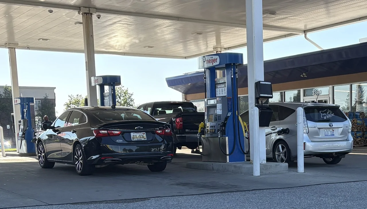

Even worse, the two stations in my town that have e85 pumps, only have one e85 pump, and it's always being taken by someone getting normal gas or just have their car parked there taking up space. Then you get to sit around for ten minutes while they are inside playing lottery tickets and shit

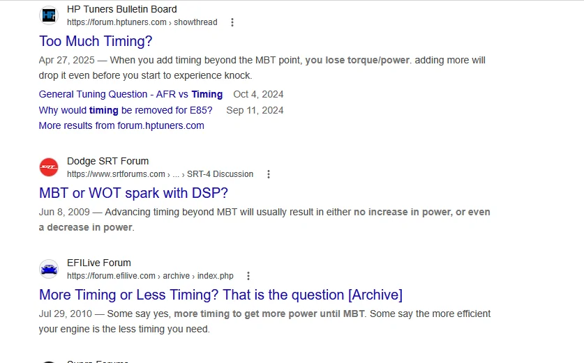

I have never seen an actual Wengerd tune so this may not apply;
If it will knock with with fuel below E70, the ign timing is over advanced.
There is a thing called MBT, too much timing and the engine fights itself.
If it will knock on E60 It is 99% over advanced, or the tuner (generic not Wengerd specific) wants you to think you have a special tune and sets the timing correctly.

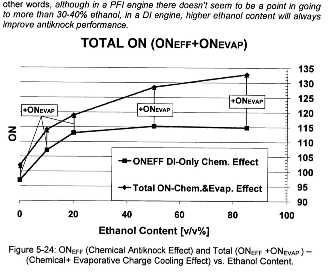

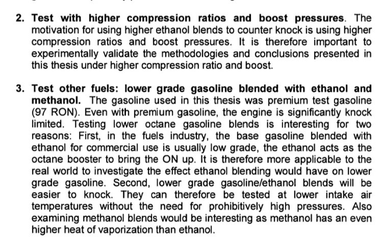

I believe oem calibrator Greg Banish, research publications on the matter, and my own personal experience over any popular coyote tuner. Unless you need over about 130 octane, which you don’t, e60 is plenty. But it’s your car and your decision. I just wanted you to know you’re unnecessarily missing out.
The ethanol blends in the test were created using 100% ethanol mixed with government-certified high octane gasoline. Let's see what gas station "e85" does at different ratios. They also used an old GM EcoTec 4 cylinder.
I'd like to see some testing done on a Coyote engine, aftermarket supercharger, higher boost pressures, real-world fuel. Are the numbers different on a 16 or 20 psi boosted coyote? Get some real-world data.
Not that a 'street car' needs e85R, e100 or e98, but what's gas station e50 look like vs gas station e85?
From the paper:
This graph piqued my interest based on that 130 octane rating, so I went and dug into the engineering a bit with the help of Gemini (I'm just a scrub on the fundamentals). Super interesting piece of education - I always thought E85 topped out at 105 octane - learned quite a bit. Obviously I dont have the expertise to independently confirm, but sharing for others:
1. Supposedly port injection benefits little from the evaporative cooling effect (top line in the graph). Port does benefit from the shear volume of fuel going in at full throttle(22-30% more than regular 93), but the evaporative part is wasted in the intake runner on the valves...it enters during the intake stroke and is reheated, negating the effect of that "cool mist hitting hot compressed air inside the cylinder."
2. I also didn't realize that mixing gasoline + ethanol would improve octane more than pure ethanol. When mixed, ethanol chemically destroys the unstable free radicals that cause engine knock in normal gasoline. This gives E85 more knock-resistance than either gasoline or pure ethanol could ever have on their own.
3. Part of what intrigued about the graph is high octane rating at e45 - the online calculators I've always seen used don't show the same octane rating at E45 vs E85. Apparently they're also using a basic averaging formula and they don't account for the benefits outline in point #2. they're just taking averaging the octane of the gasoline and octane of the E85 based on how many gallons of each.
Today I learned. thanks for sharing
Edit: oh, for those wondering why pump e85 is usually 105 octane and this graph is showing it as 115, it's because pump ratings are based off on averaging RON + MON octane ratings. The graph above is just using RON(which is the higher number).
