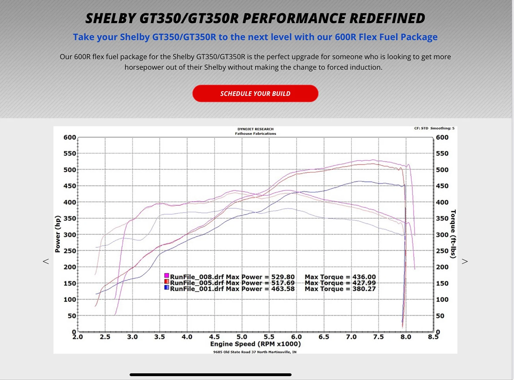

All that being said, Fathouse had the path to 600hp (flywheel not to the ground) until they quit offering it not long ago…
JLT Air Intake/Filter
Stainless Works Longtube Headers
Stainless Works Catted H Pipe
Custom Dyno Tune – Factory Flex Fuel
10 gallons of One Ethanol E85

oh cmon man, I love your contrarian style…
…but why would you e85 without a good tune 🤔
I'm just saying it's not worth 50hp if you compare to a 93 tune. Adding e85 in that case will get you 25hp.
Which, is 50hp compared to a stock car. Just adding e85 fuel on top of your already modded car doesn't get you 50 though
