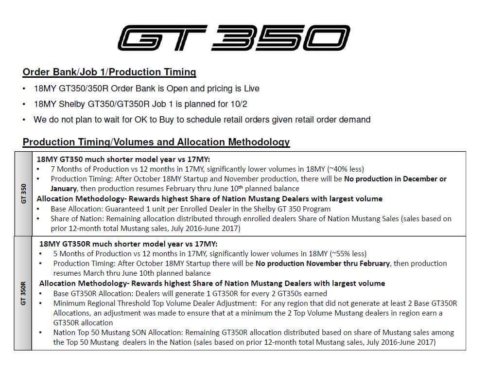

If you look at the allocation/Production Timing document I attached, it seems to state that MY18 production started in October of 2017 (and November for non-R's), then stopped for Dec & Jan, and then resumed in Feb 2018 through June.
So when was the piston and piston ring change implemented?
My car is a Feb 2018 build date, do I have old or new piston rings?

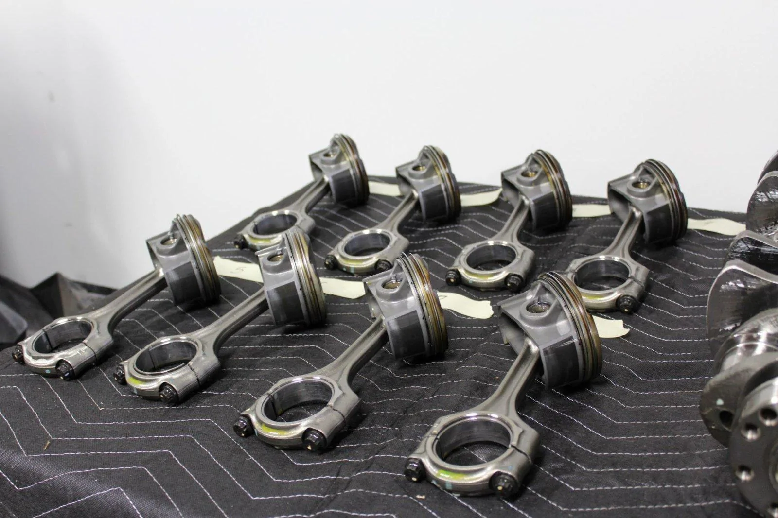

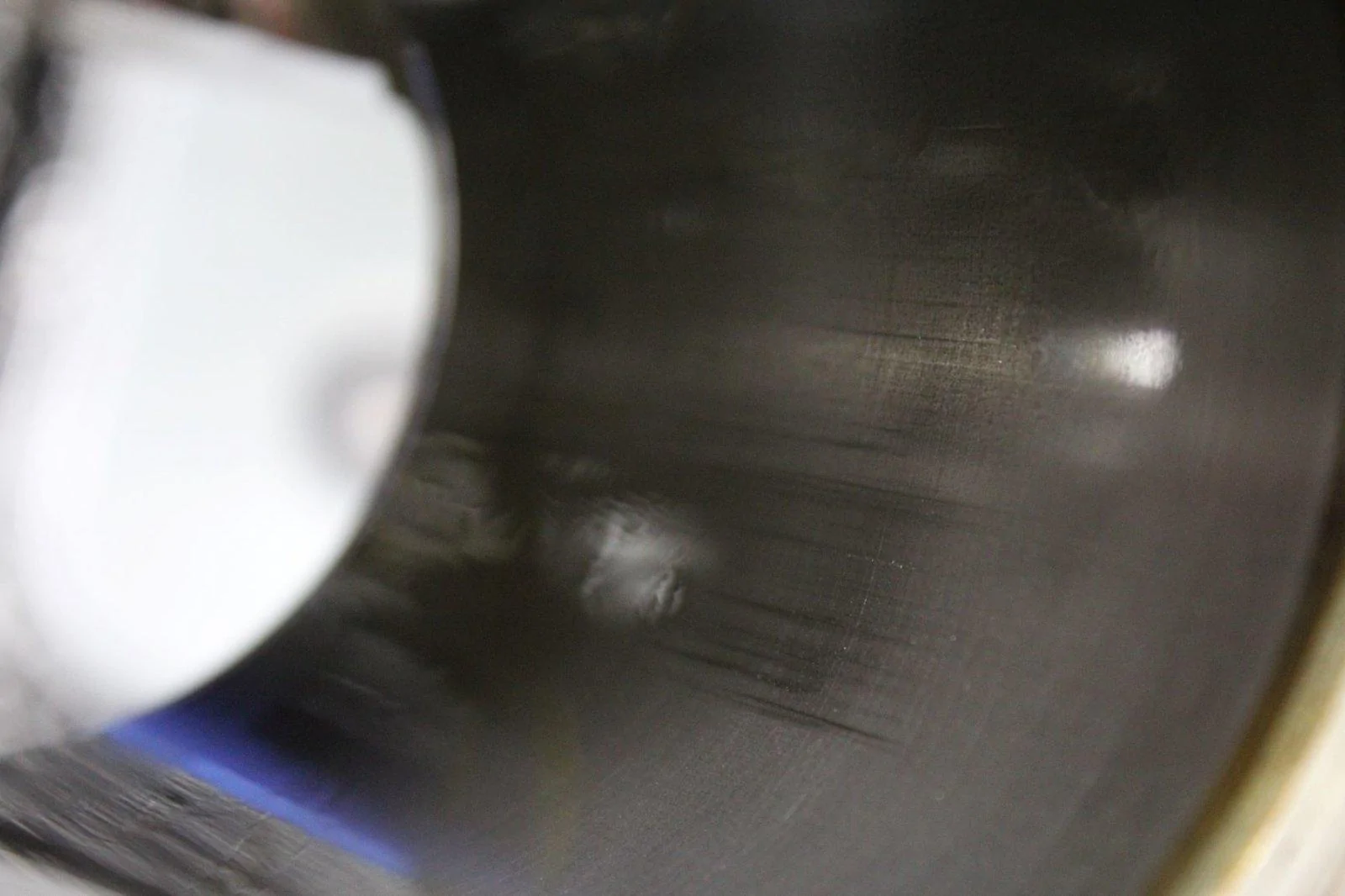

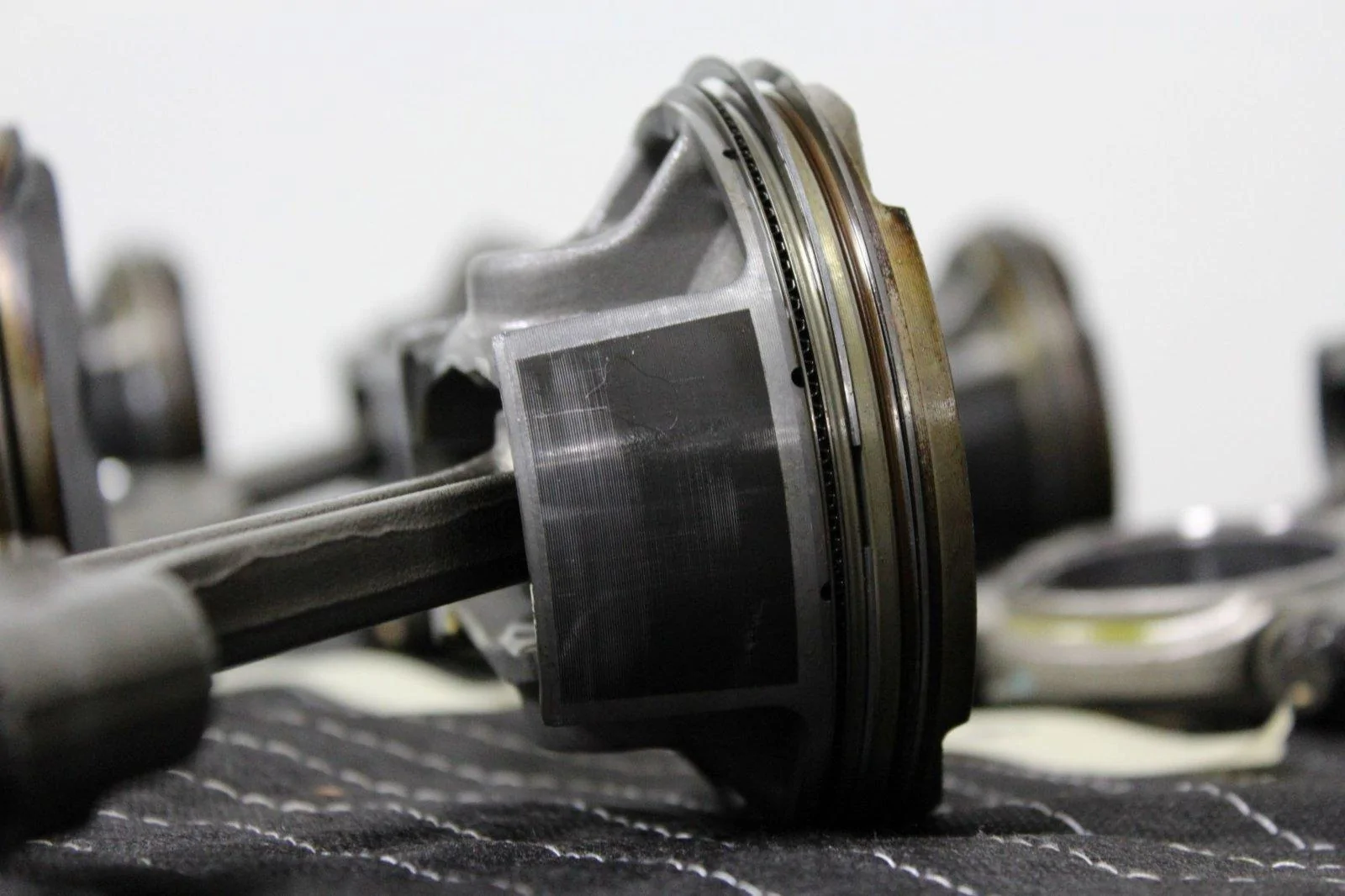

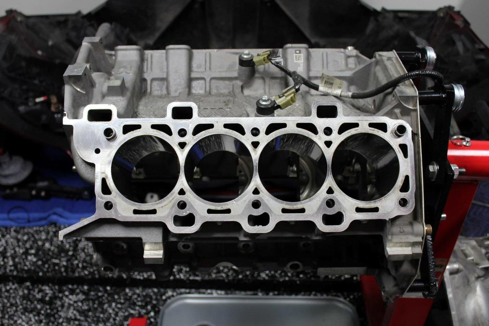

Had a chance to finish the engine tear down tonight. Everything looks fairly good me thinks. There is some light scoring on the cylinder walls, but nothing the fingernail can catch. Thinking of a quick honing, new piston rings, new main and rod bearings, a deep wash and I should be good. Am looking around a bit at pistons. @AceOne are there pistons that are OEM replacements worthwhile looking at?
Pics below:
Bit of skirt wear, but not bad

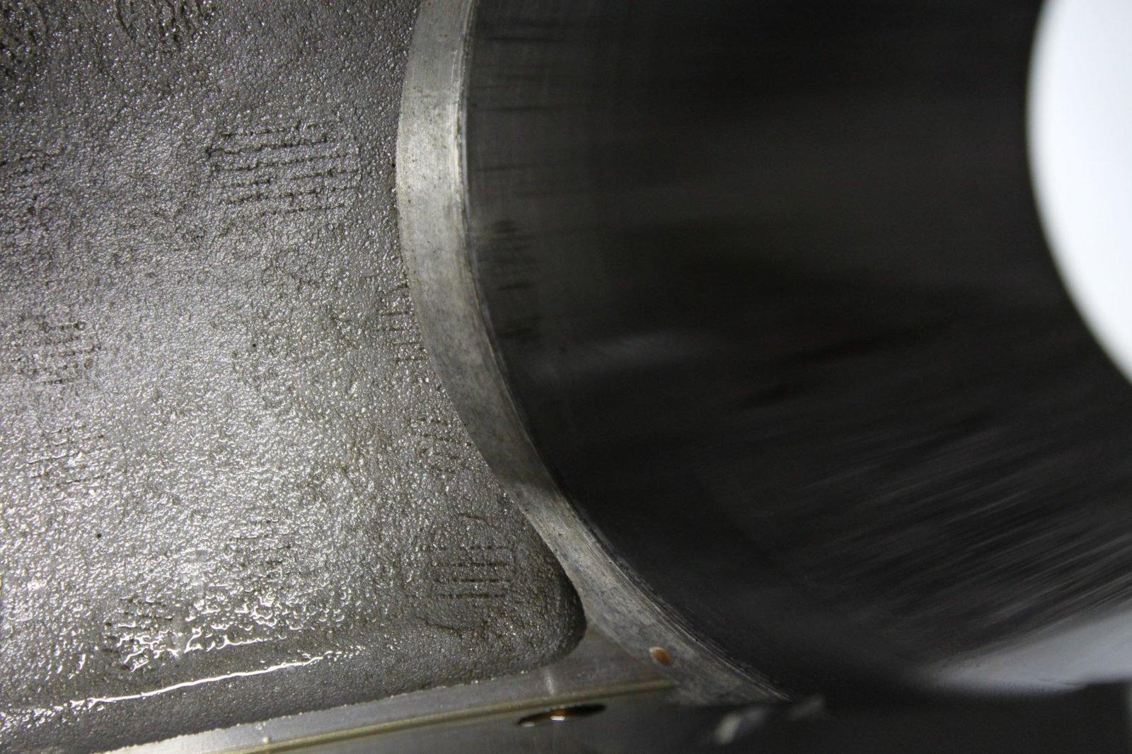

Piston slap wear. Slight - nothing that catches the fingernail. Consistent across all 8 cylinders.
Some on the very bottom as well

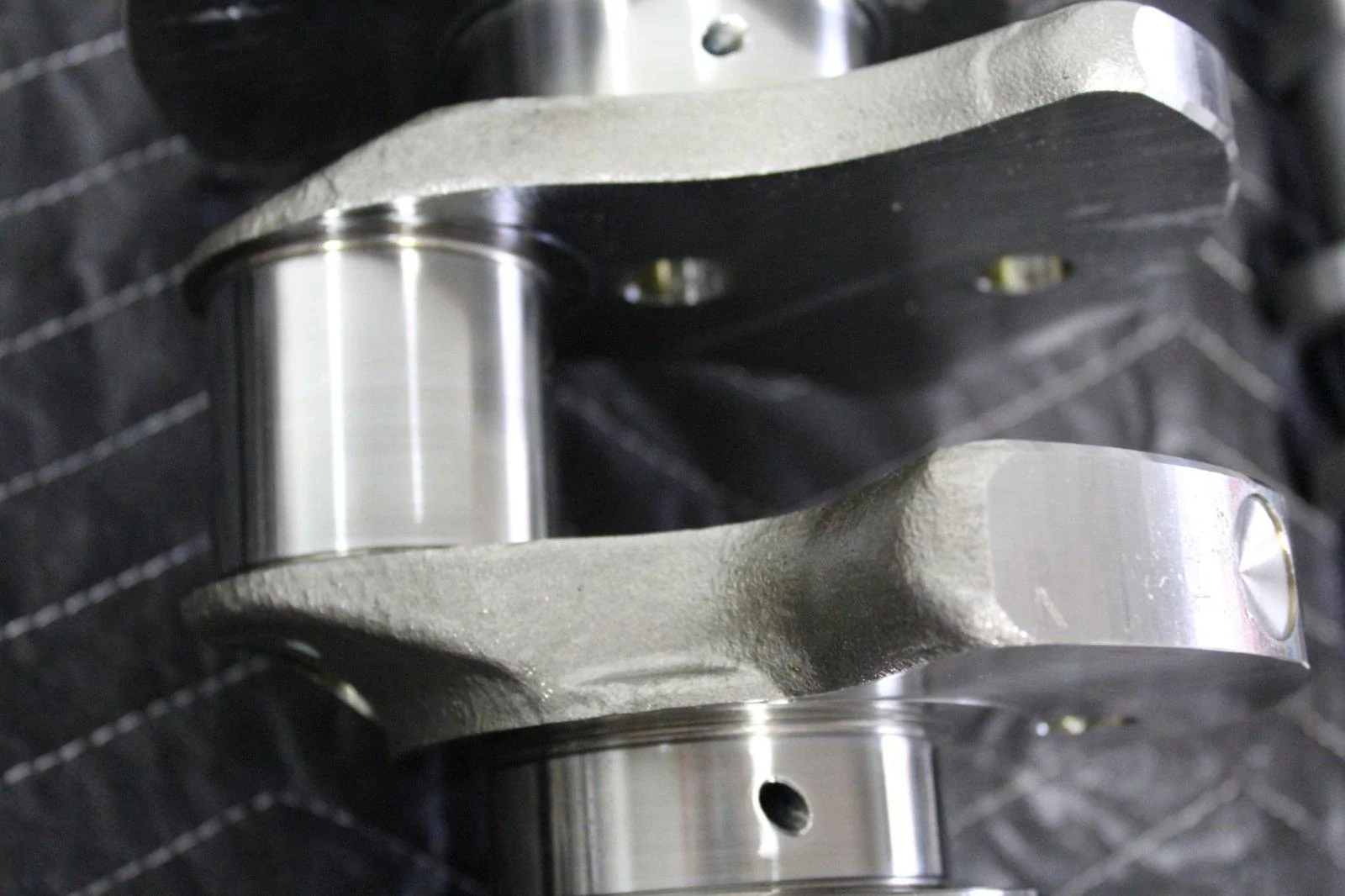

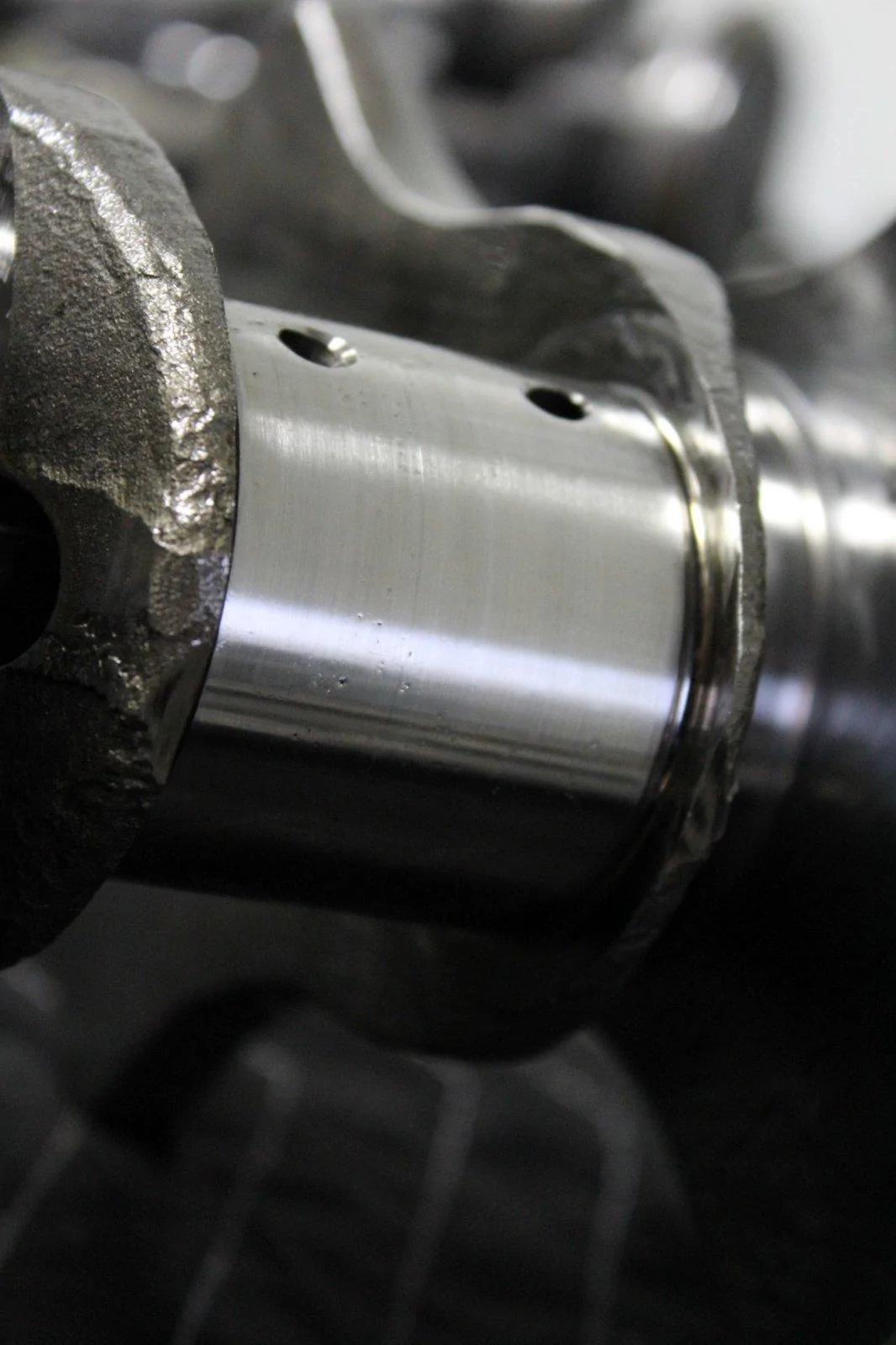

The big ol' FPC looks fantastic

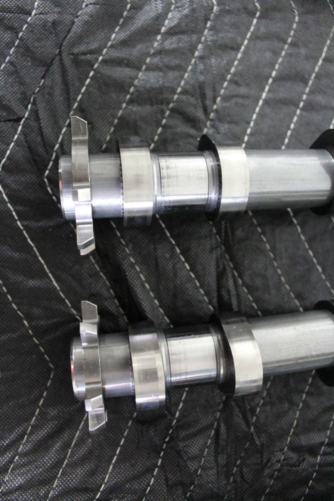

Cams look pretty good as well. Is a bit of extra wear on the back cylinder for each bank. #8 for example:

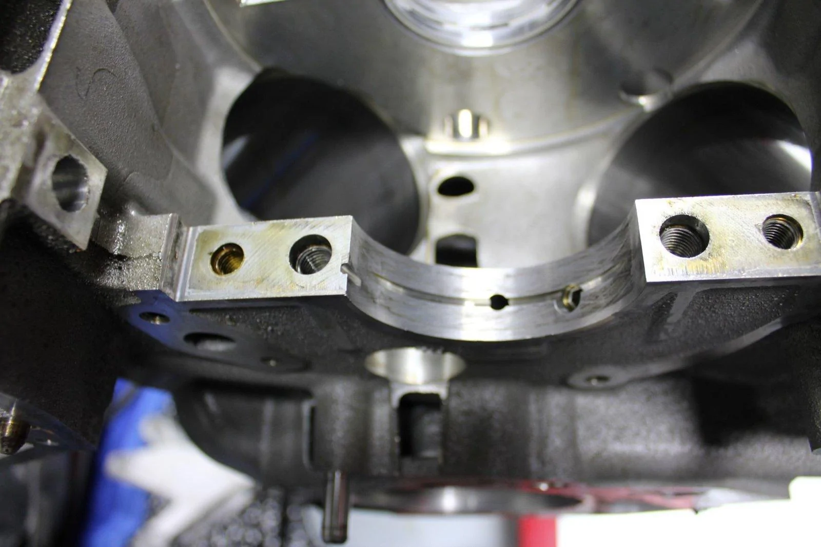

Underneath the main bearings....a bit of wear.
