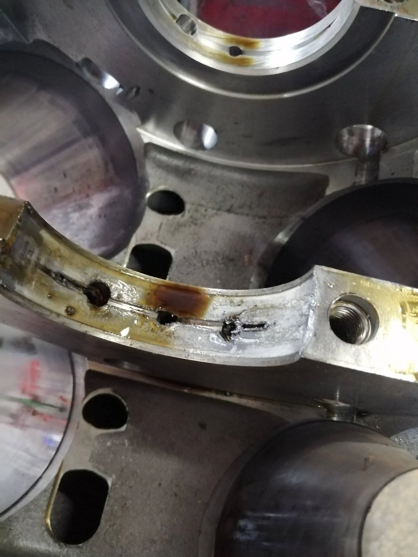

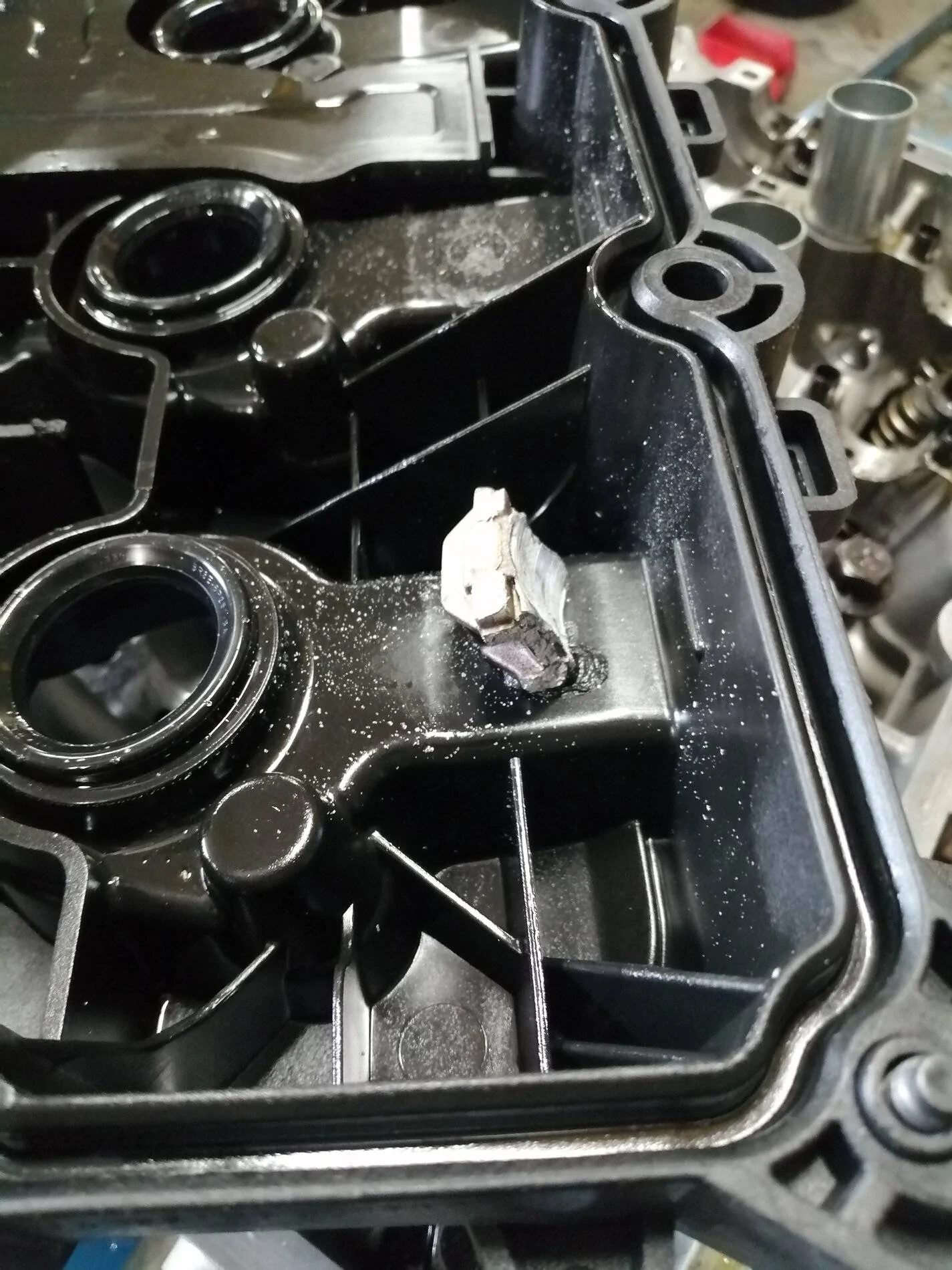

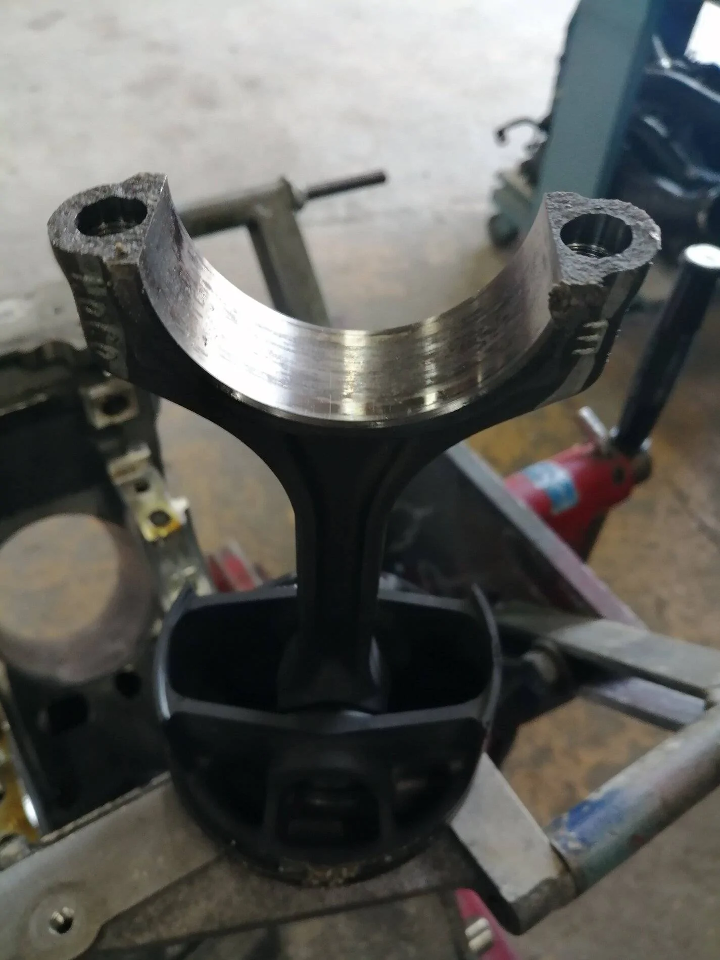

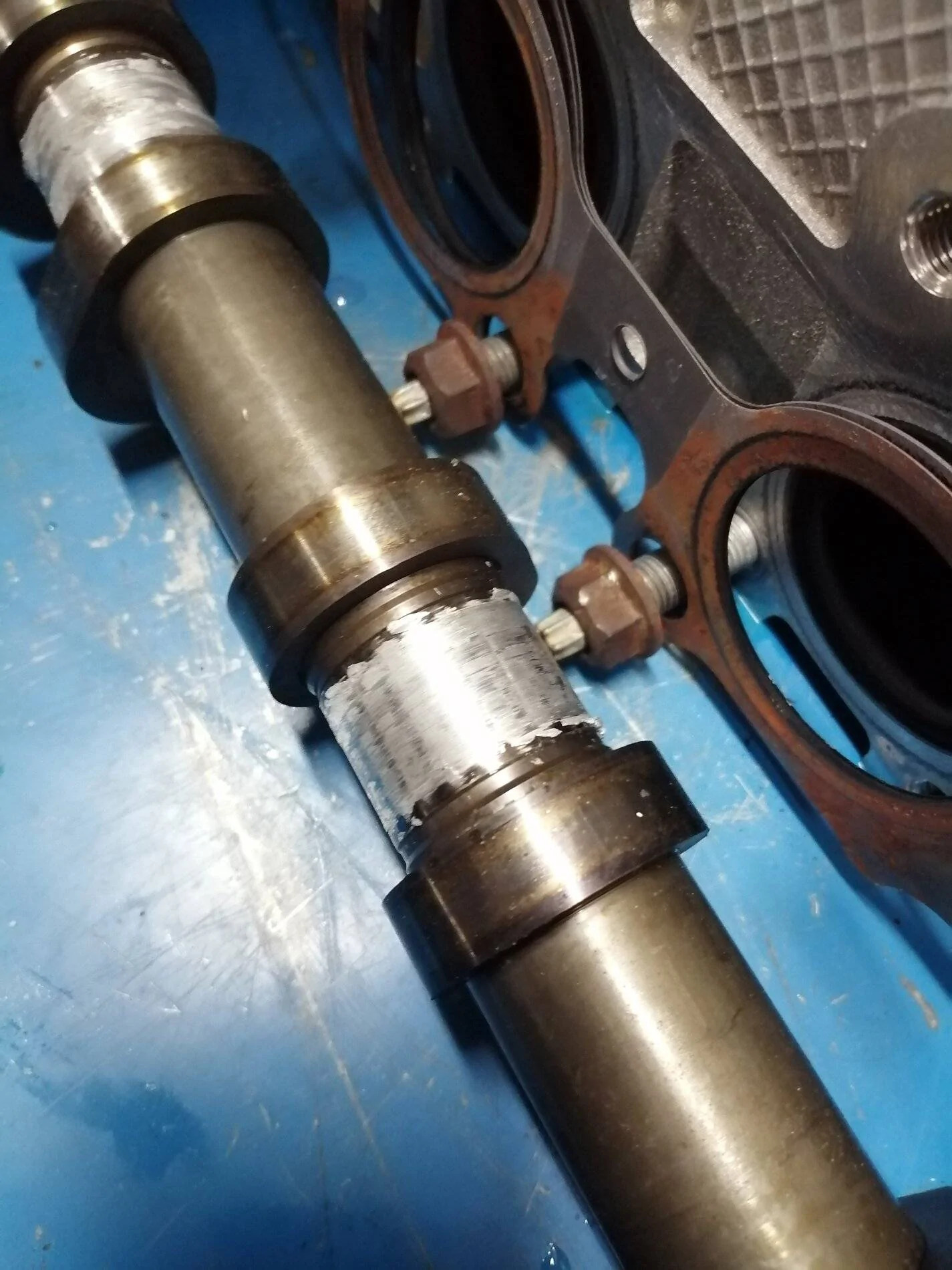

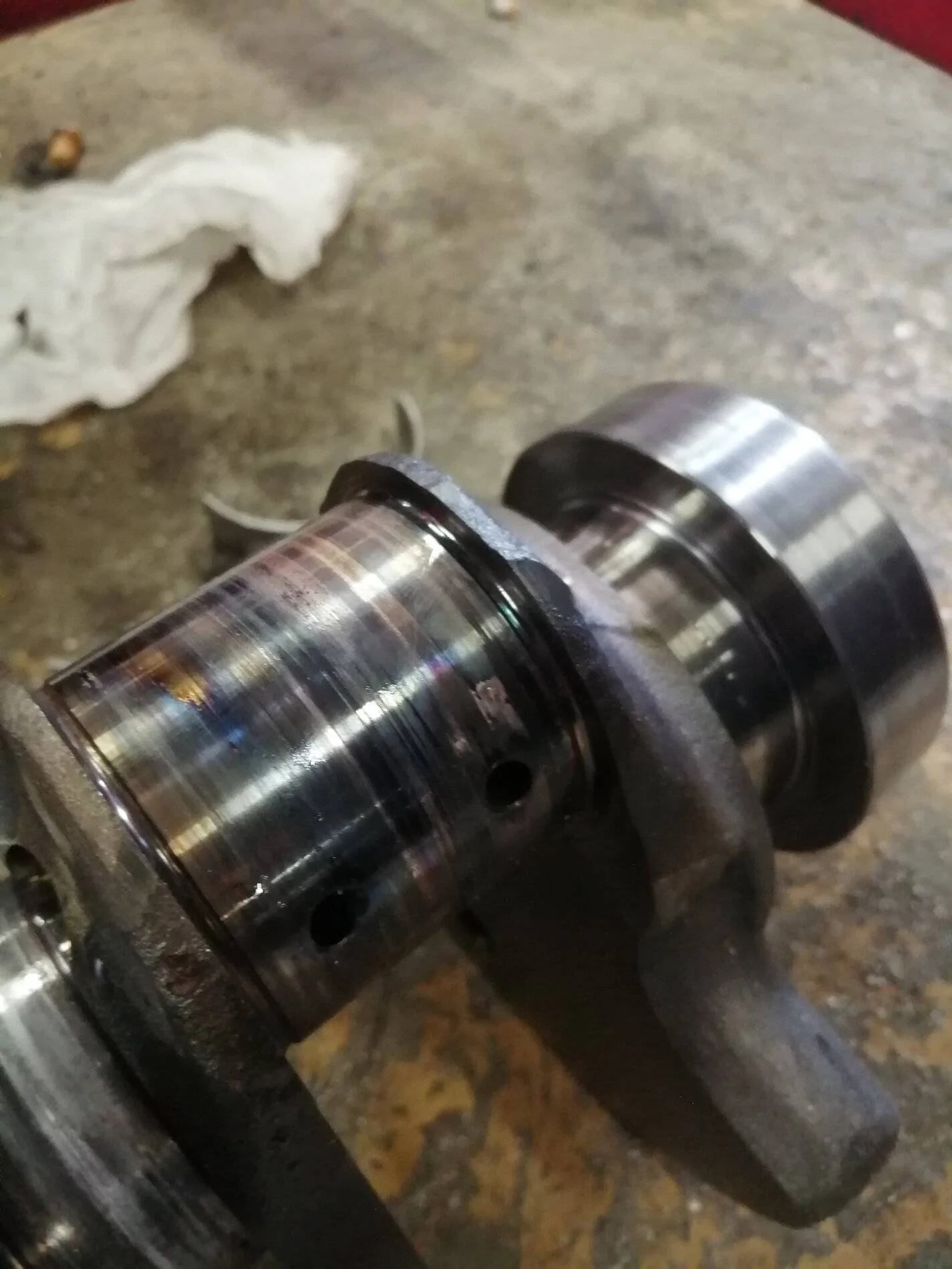

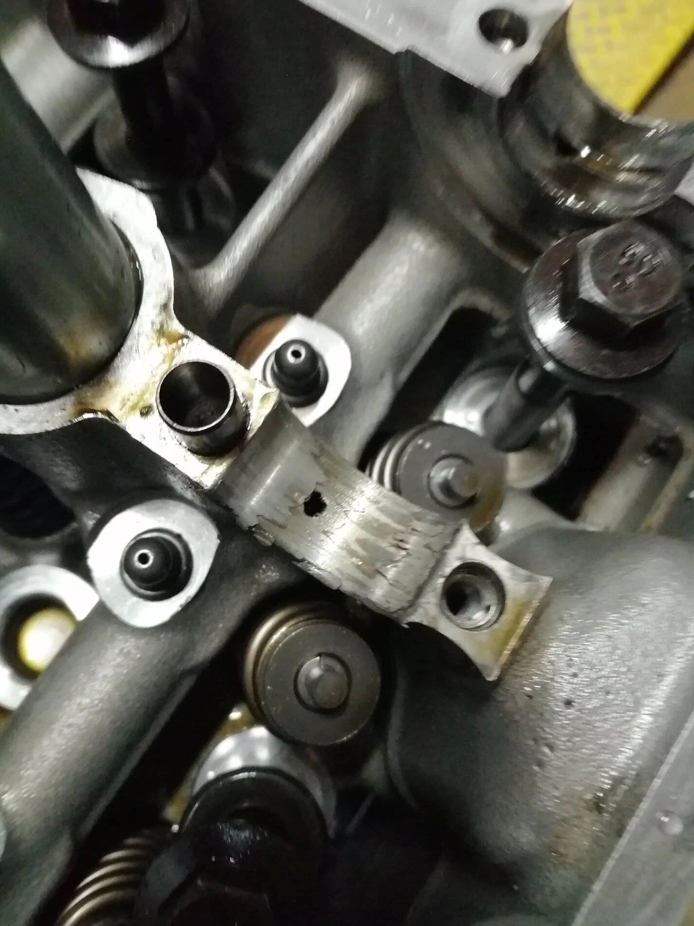

Well, I think it's beyond repair.... honeybadger, pls remove pics and/or post if you feel it has not it's place here
Ack! Damage to the cam, head, block and crank! Damn. That's nuts. Is the OPG still intact? That's definitely catastrophic oil starvation.
The block MIGHT be able to be saved depending on how was shaved off/damaged. You'll definitely need tog et the block checked by a machine shop. Do you have any history of what happened?

Ack! Damage to the cam, head, block and crank! Damn. That's nuts. Is the OPG still intact? That's definitely catastrophic oil starvation...
It's a mess alright. The other possibility is that the oil filter collapsed into a wad and stopped oil flow to the engine. Either way, there was a lube-free moment in this engine's past.
