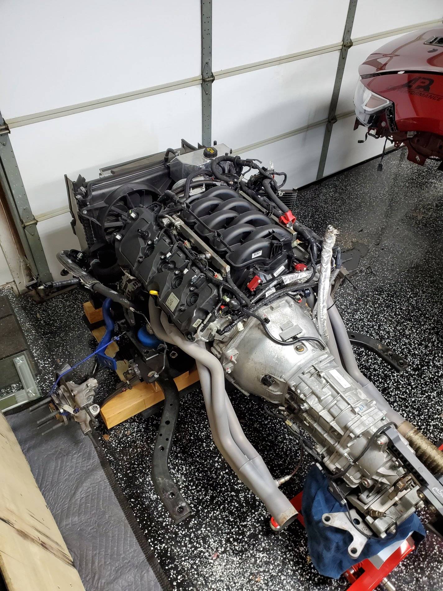

So I've mentioned that the new motor smoked a bit when cold before. Over the last 2 months, it's been getting a bit worse. Enough to catch my eye and get me thinking.
While I'm working on a heater core bypass between events, I decided to do some digging. I've noticed that it'll also blow a puff of smoke if I let it idle for too long - this indicates valve seals. I originally thought ring gaps because once it got hot, it went away. Today I pulled the intake off and looked into the intake runners and saw that some oil has pooled up on the valves. Definitely bad valve seals IMHO. Fortunately/unfortunately, I'm coming up on the 40 hour maintenance interval for the valve train. Looks like I'll add these to my list for winter maintenance. I'm planning on a full engine removal and investigation this winter, so at least we'll get to dig in and see how the built motor is wearing otherwise.

How long does it take you to drop the motor and gearbox now?
It's funny. I was making a video of the removal and I claimed I could do it in about an hour and half if I'm focused. Turns out, it's still like 4 due to all the mods I've made - radiator ducting, splitter, exhaust, etc. Sigh. Haha

Got the engine on a stand last night. Will be opening it up this evening and will start the thread once I have pics!
