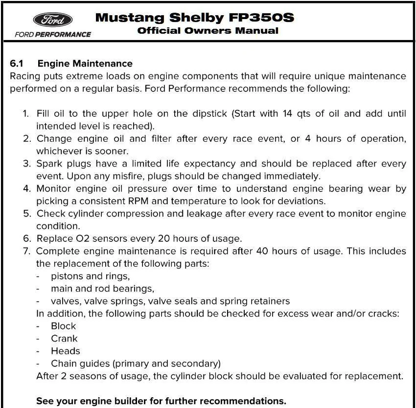

So @Epiphany dug this up from the FP350S owners manual. When we were talking, I'd estimate HB has 75-80 track hours on the engine at 2.5 hours per event with roughly 30 events. Given the 5.2L Voodoo and 5.2L Aluminator in the FP350S are very similar (with the Voodoo having more challenging variables when driven in similar conditions), this is quite insightful. Wonder what the balance is for us track junkies. If I push this car in 2019 as hard as I have the last 6 months, I will probably opening it up again to look things over.
I think that's quite an aggressive schedule and it would make more sense for guys who are in it for trophies and pay outs to abide by vs your average track day guy.
I don't think you need to be that rigorous.
Definitely agressive. But in similar driving conditions, the Voodoo is stressed more than the Aluminator (lesser cooling capabilities, more harmonics, higher RPM, etc.). If you're pushing this engine hard, it might not be a bad idea. Or one can rely on a warranty. My only concern with that is what happens if it doesn't go boom before the warranty runs out?
Well, yes and no for the voodoo being more stressed. I can see that, the other side of the coin is the aluminator is designed to run in wheel to wheel racing where it might be gulping down hot air for a sold hour behind traffic. Or where it may need to run for a 24 endurance race.
If my wallet could support it, I would be at the track as often as you are, and if my engine made it outside of warranty with 5 years of heavy track use, I wouldn't be upset about a rebuild at all.
I'm not going to fault you if you want to stick to that schedule. I probably won't, at least for now, I think I have about 3.5 hours on track with my engine. Although, I should probably start documenting this a little more.

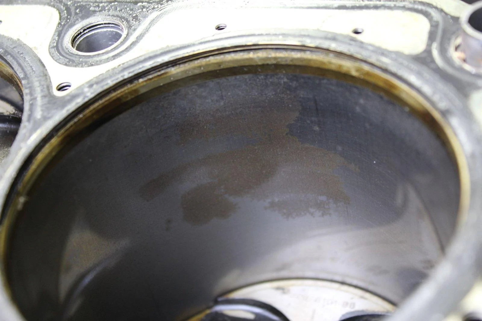

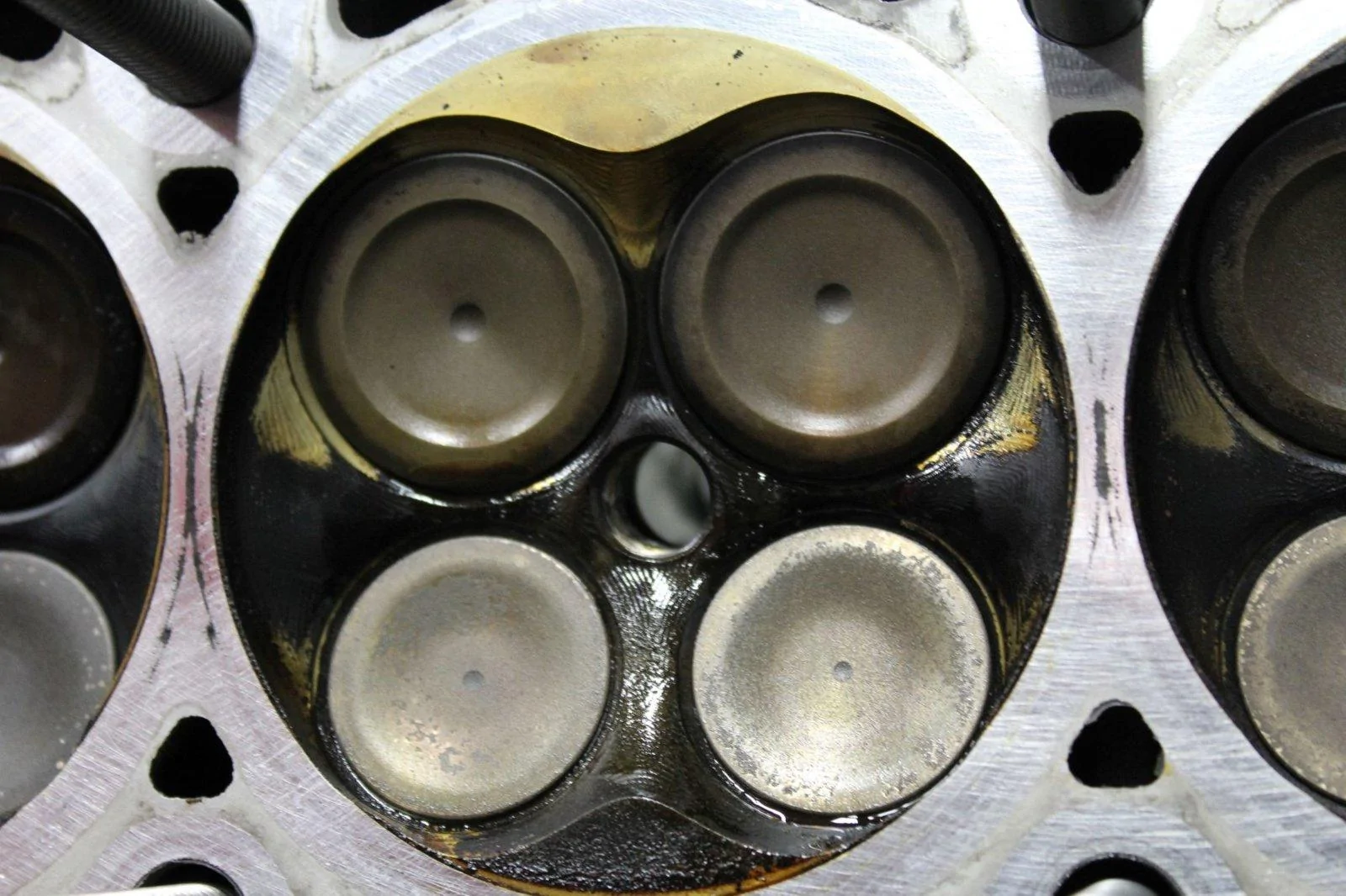

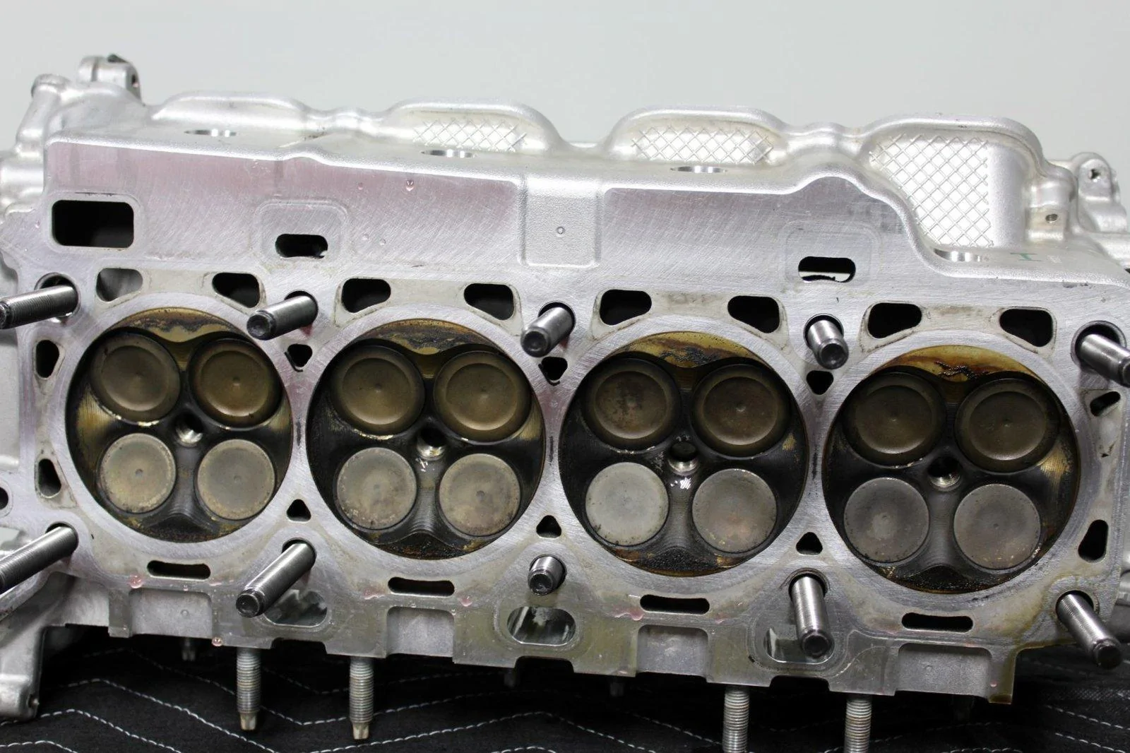

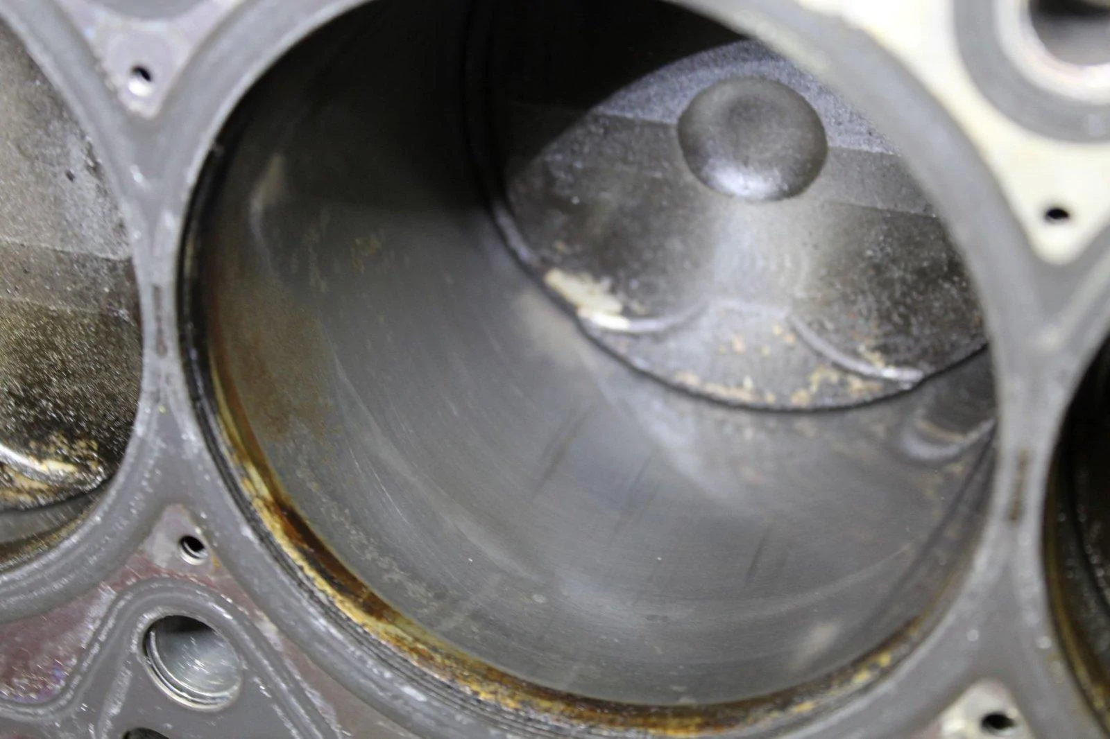

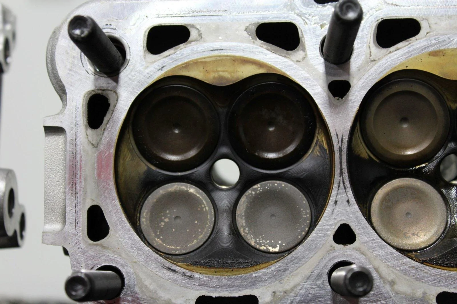

Took the heads off tonight. Not liking what I am seeing. Thoughts?
#8 is darker than the rest
Compared to #7

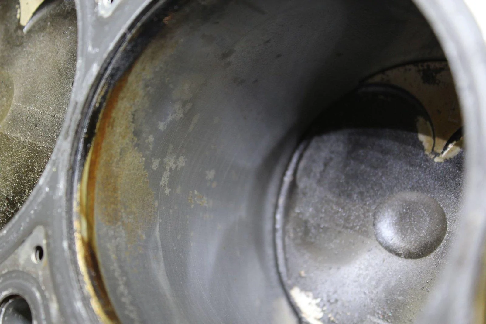

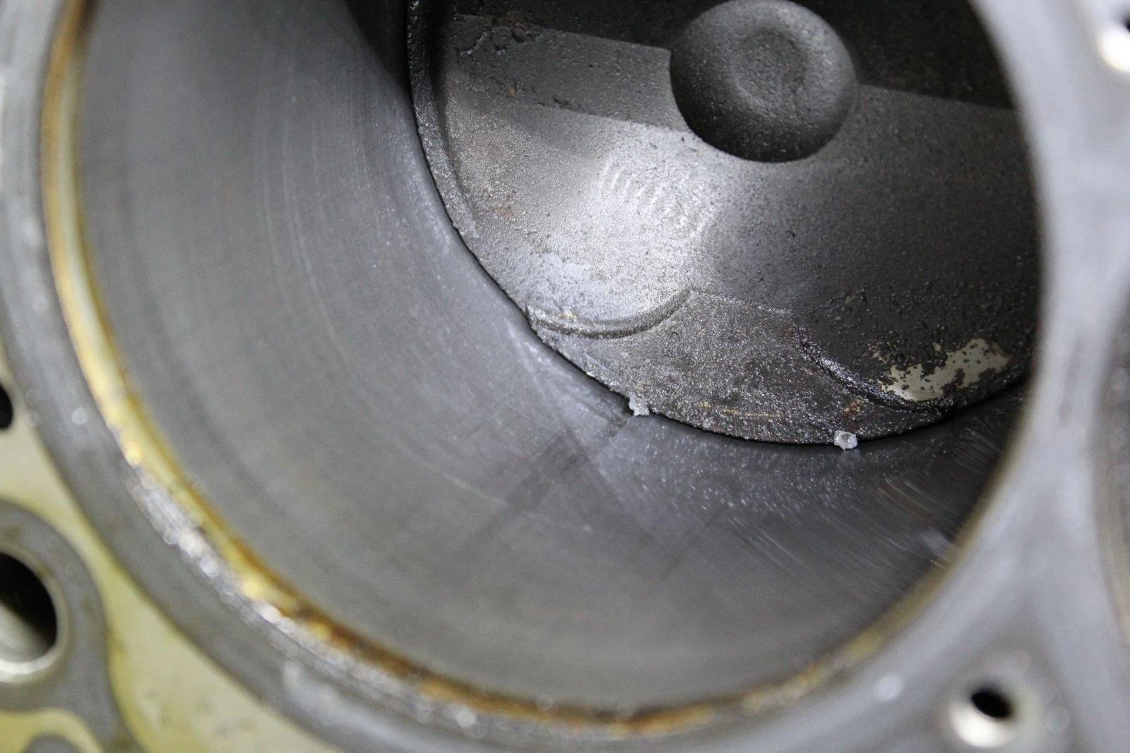

Some scoring on the walls. Piston slap?
Gunk is most of the cylinders (of varying amounts each)
#8 cylinder wall

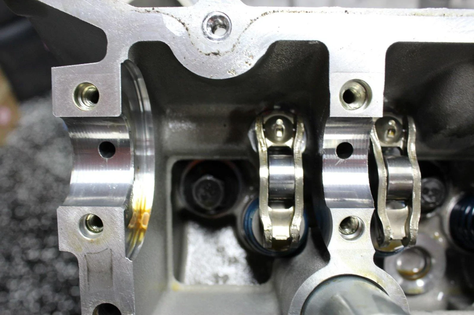

Cam journals
Compared to #7

Wow !! Is that gunk in the cylinders hard or soft? What the heck?
The really dark gunk is burnt oil. That's soft and removable. The bronze/brown stuff is hard and does not come off by wiping.

Just normal carbon there and can you feel those scoring lines with your finger nail? If not clean up the carbon and put a light coat of oil on the walls. if you can put the crank in just turn over the short block
