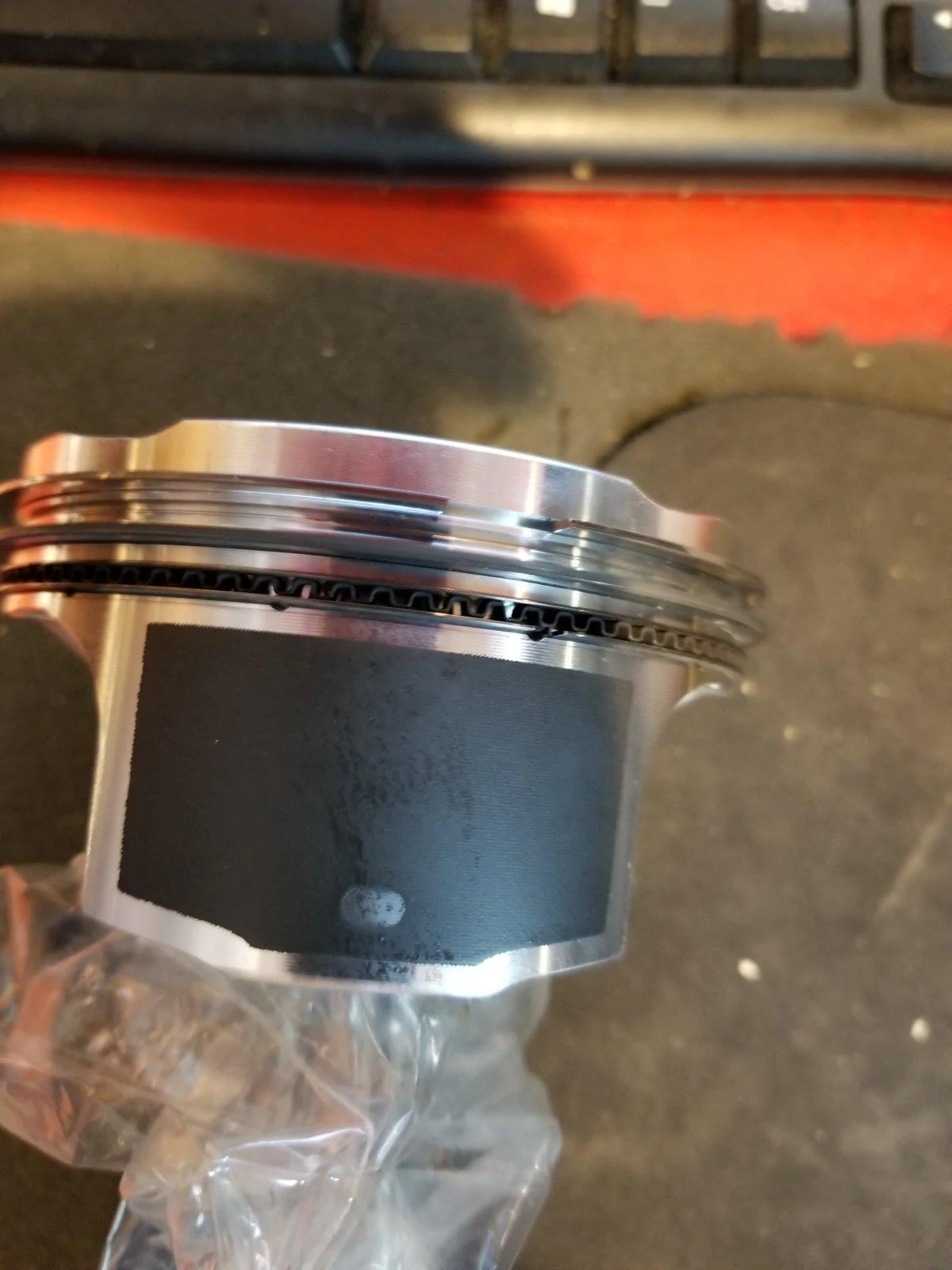

These are the J&E pistons, stock diameter and compression ratio. Part #345870 View attachment 331103

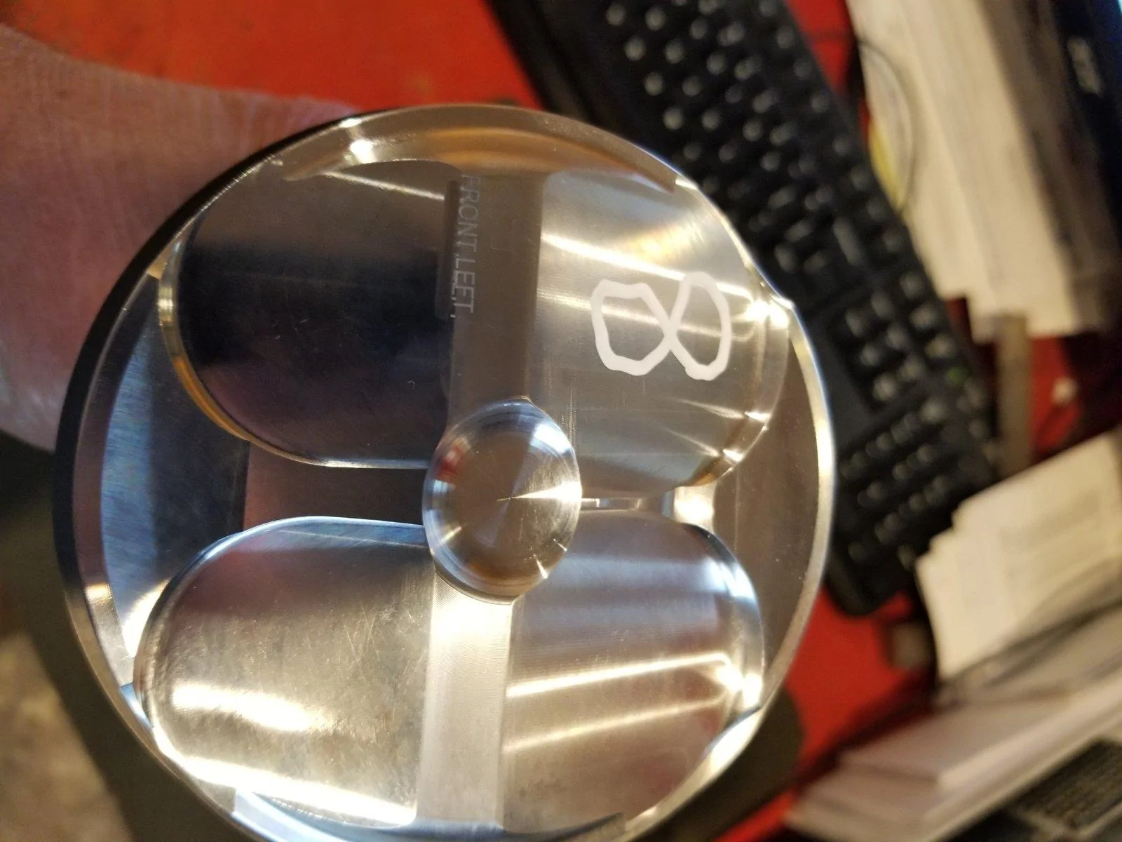

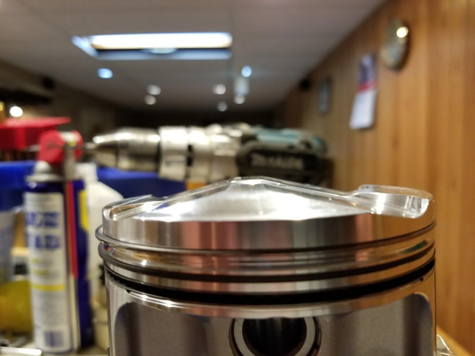

@honeybadger I was looking at the JE 834871 to get a little higher compression. @bauern Could you post a pic of the top of piston and best angle you can get of the dome? I'm still concerned if more dome will hurt the combustion flame front. Could you also mic the piston diameter and post it. Thanks in advance.
Manley 3.7 NHRA 3.701 piston has a 7.5 cc dome.

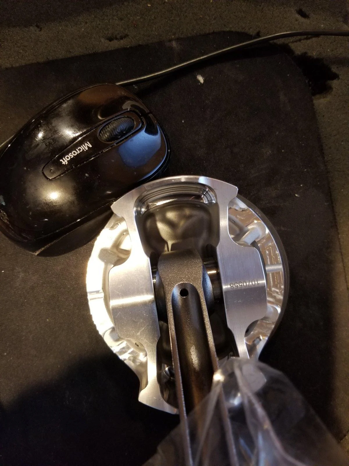

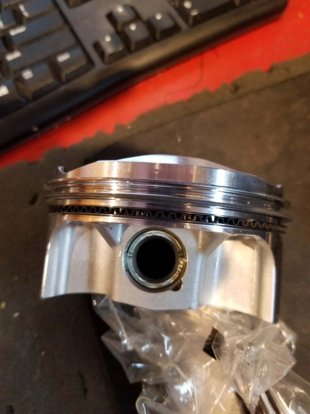

That JE piston is looking real nice. Pretty similar to the Mahle OEM ones. The valve reliefs edges look a bit sharp but the ring groove and pin area look very good. Did you get weight of pistons?? Are they as advertised? How the rib supports on the underside look? Was there a "good" spot somewhere on the piston to lighten it if needed for balancing. They should be pretty good out of the box. The Ford OEMs were pretty good but one was a bit off but I couldn't find a spot I was comfortable trying to drill a little to lighten it. I can't even remember what I did...I think I used my lightest pin it that piston.

Thanks, @bauern Any insight into the differences between the J&E pistons vs. OEM? Benefits? Risks?
J&E are slightly heavier, rings are thicker 1.0-1.2-2.8mm and they specify wider gaps, especially the top ring. The coating is designed to conform to the cylinder as it wears in so no slap, piston rock better ring control (so they say).

I weighed them before I sent everything to be balanced on the 5.2 CPC. I got 400g on each of them. The underside does not require the tapered small end on the rod (but they are assembled onto the Manley rods). The crank required two pieces of mallory to balance. It weighed 51 lbs. when I delivered it and 51.4 lbs when I got it back.

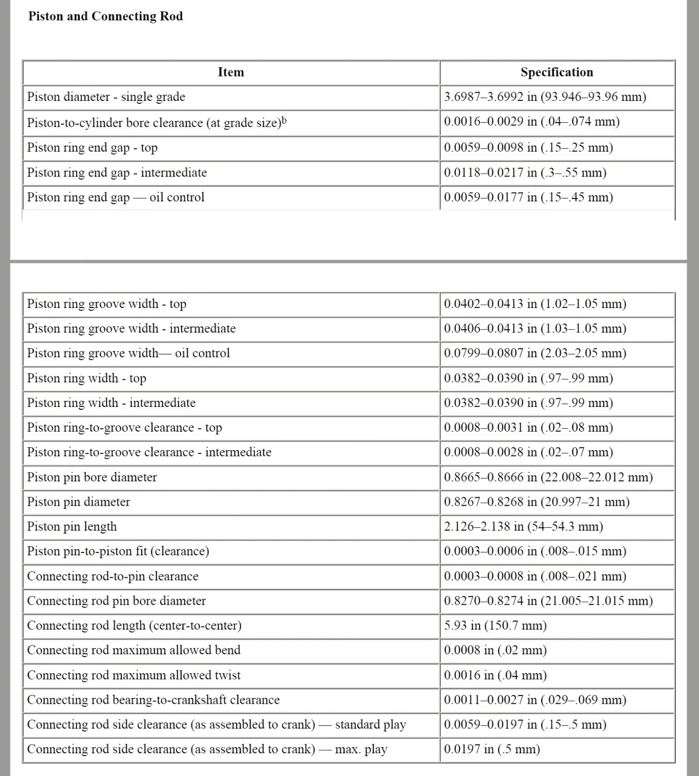

The piston dia. is 3.6982" at the bare spot in the coating and 3.7008 across the coating.

Thanks. I will see if JE will send me pics of the 8,9 cc domed ones to compare to your pics. Dimensions looks good new max cylinder with the plasma coating is 3.7013. if I calculated right you have 3 thousands to work with for honing it.
