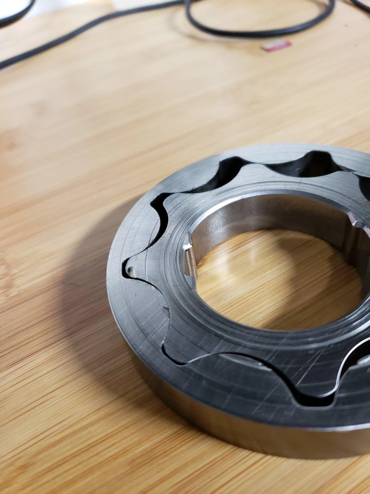

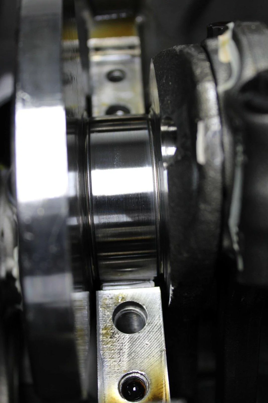

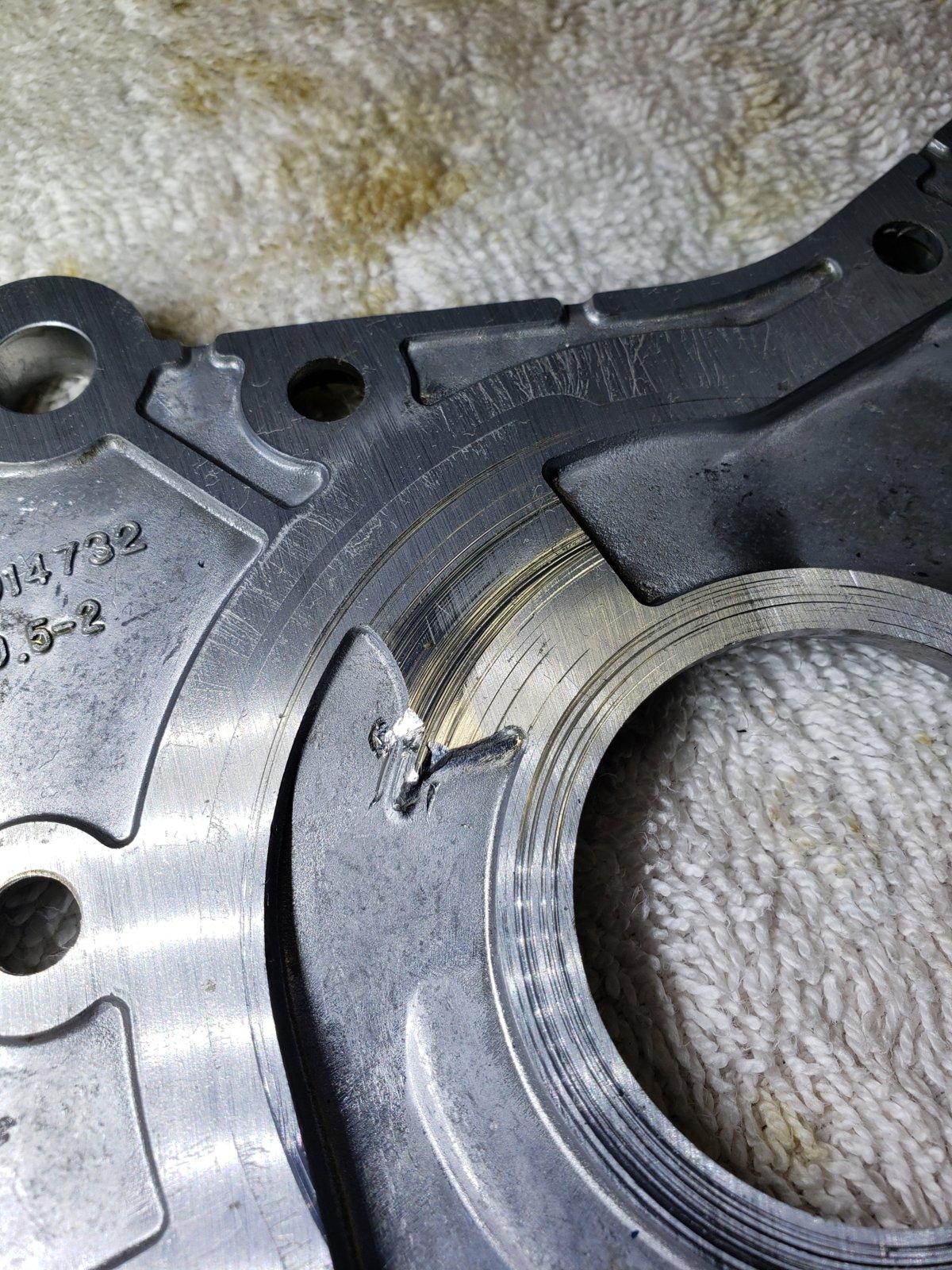

In case you haven't been in my thread, I was installing a billet OPG while I had the engine out of the car and discovered a chip in the housing and on the gears. So I dug around some and started doing some investigation on engine wear and tear.

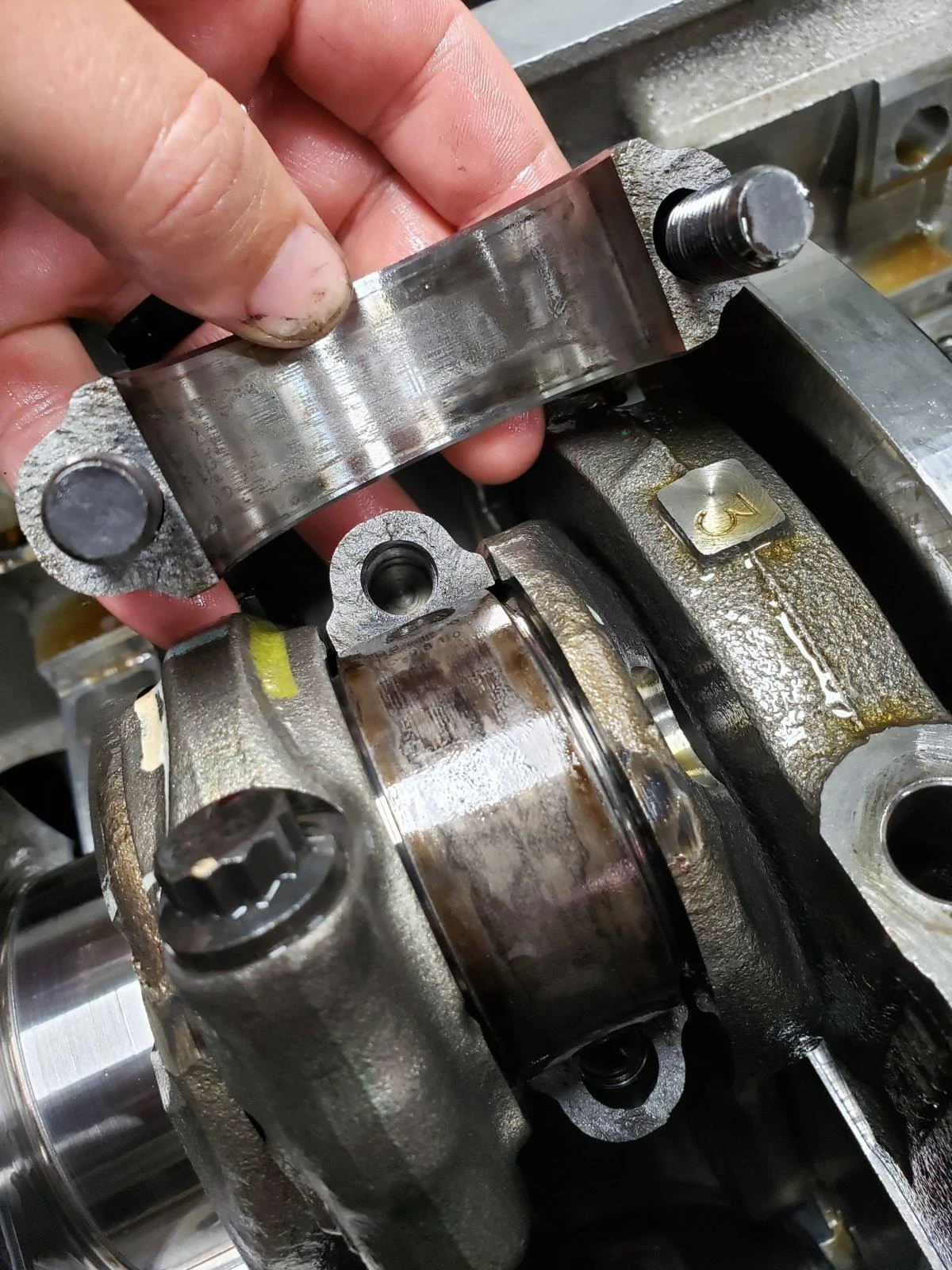

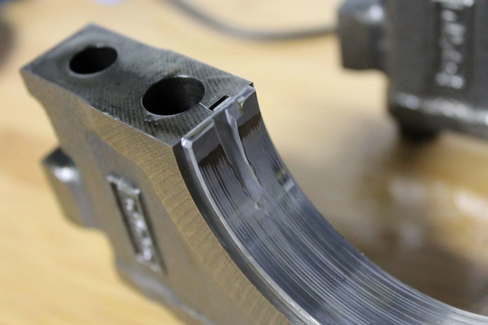

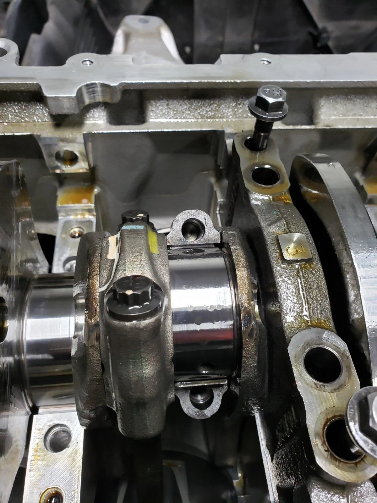

After 12k track miles (20k total), the crank and cylinder walls look great. The main and rod bearings have a good amount of wear, but nothing to be concerned of. I think this engine could have a good bit longer, but while it's apart and now that I have proof some metal went through it, I plan to refresh it before the 2019 track season.

Cap bearing
Crank
Rod bearings

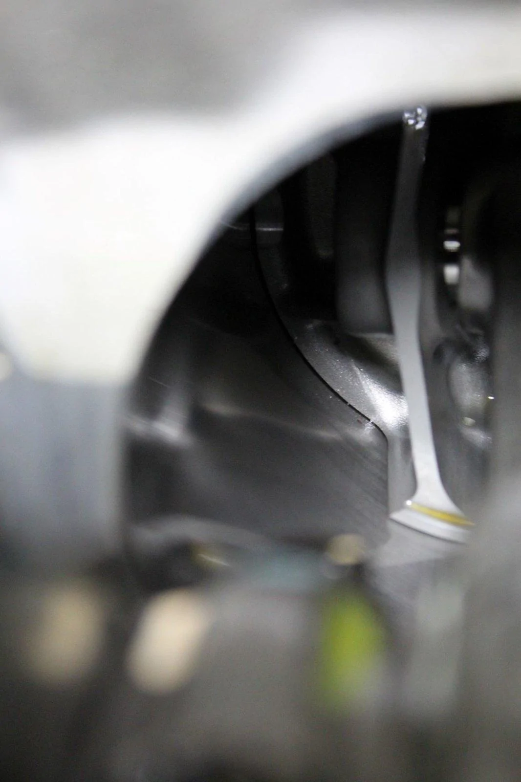

cylinder walls

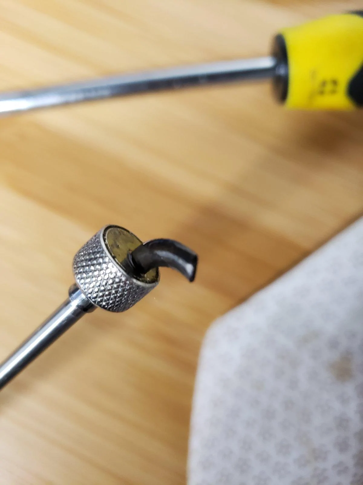

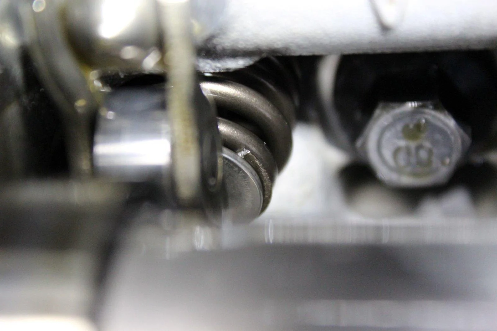

oil pump damage
Found in oil pan
Looks like it's from an exhaust valve

If you choose to keep going then I would first have the crank polished and balanced by a very reputable performance machine shop. I would also look into a better harmonic balancer not sure if anyone has one yet for the 5.2 FPC. The valvetrain is the only thing you should concentrate your money on since it does appear the stock beehive spring is what probably created all of the issues.
The bearing wear etc all looks to be from small metal swarf, for what your after in reliability I think your best course will be to freshen everything up and just improve the valve springs and maybe put in lighter valves and retainers. I think the rest of engine would have been fine for a very long time except for the swarf it was exposed too.

Think I have a plan in place. Spoke with a few trusted folks that have been kind enough to answer a billion questions and help me walk through the thought process. Looks like we're going to go with JPC/RGR's recommendation.
Going to take the heads off and send them to RGR for some head machining (porting, polishing, etc.) and a beefed up valve train using Ferrea super alloy exhaust valves and Ti retainers, PAC Racing valve springs, and custom bronze guides. These add a bit of weight to valve train, so RGR pulls some weight out of the head to compensate. They spin their development engine up 10K rpm using this build.
According to what I've learned, Ford lightened the valve train to handle the high RPM. However this creates a bit of weak spot when compared to the rest of the engine. JPC told me all of the engines they've rebuilt/refreshed saw the problems in the valve train, not the bottom end (outside of OPG failures, of course).
End result should be between 30-50 hp gain and a near-bulletrpoof valve train. Between this and the oil cooling upgrades I am doing, I am hoping to have covered all of the Voodoo weak points within a reasonable budget spend.

The crank journals appear fine from the pictures.
The one pix of a Rod bearing is actually the back of the bearing (goes against the cap). What does the side touching the journal look like?
Journal side looks identical to the mains. I'll pics next time I have it apart (currently wrapped up until I remove the heads).
I thought the bottom end looked really good especially considering the 12k track miles on an 8,000 rpm engine. :)
