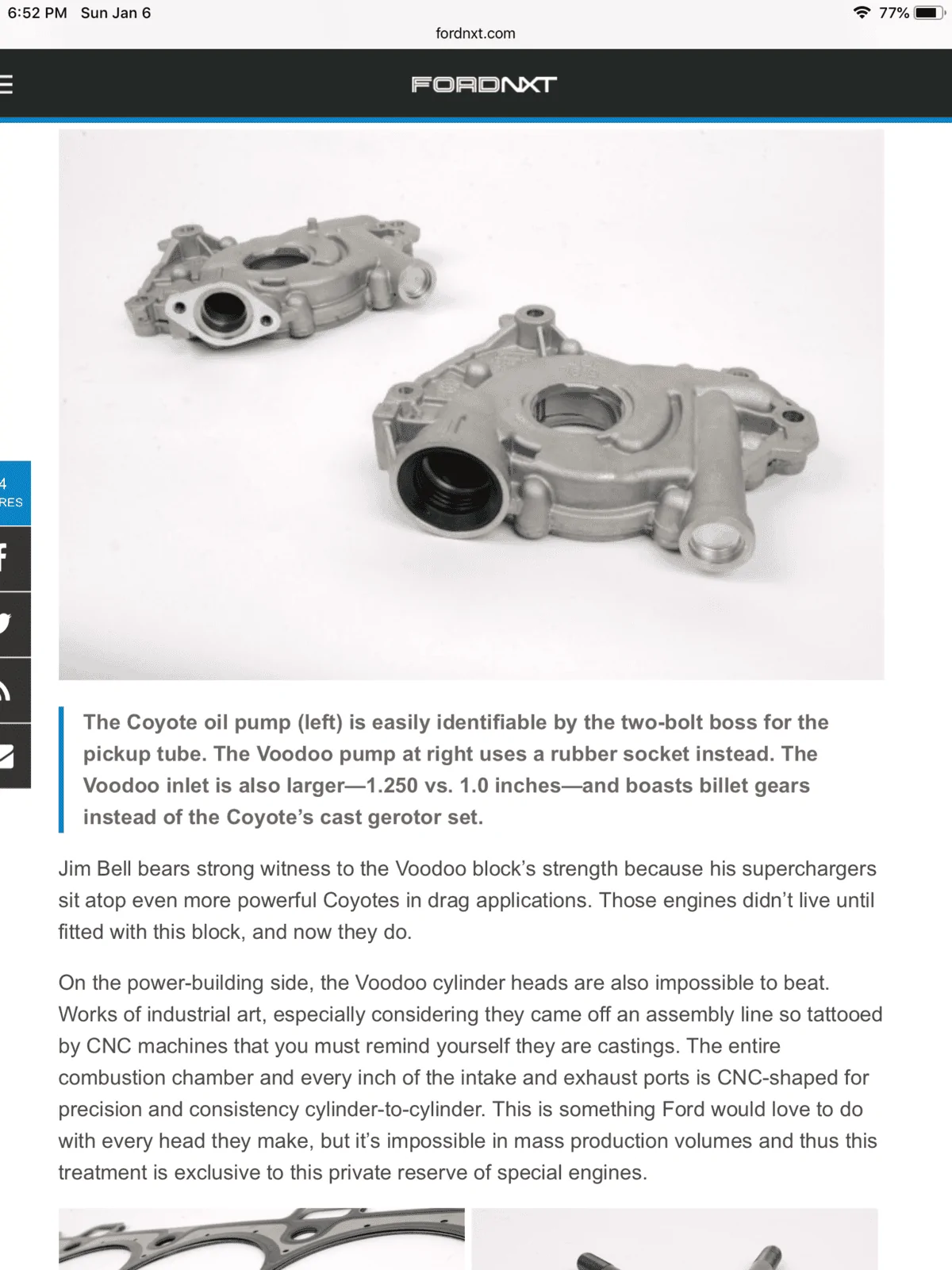

I’ve read that article before. Aren’t people swearing up and down the voodoo does not have billet gears stock??
Mime definitely does NOT have billet oil pump gears or crank sprocket
Article was wrong...Voodoo does not have Billet OPG. I believe Ford Performance started doing them in the Super CJ cars. FR does offer a set for purchase now though and I think I heard it can be a dealer installed option, maybe. I installed Boundry 4340 billet gears in my current one and am waiting on another set along with the crank sprocket from them. I think I got the billet Crank sproket form MPR for my current 5.2.
