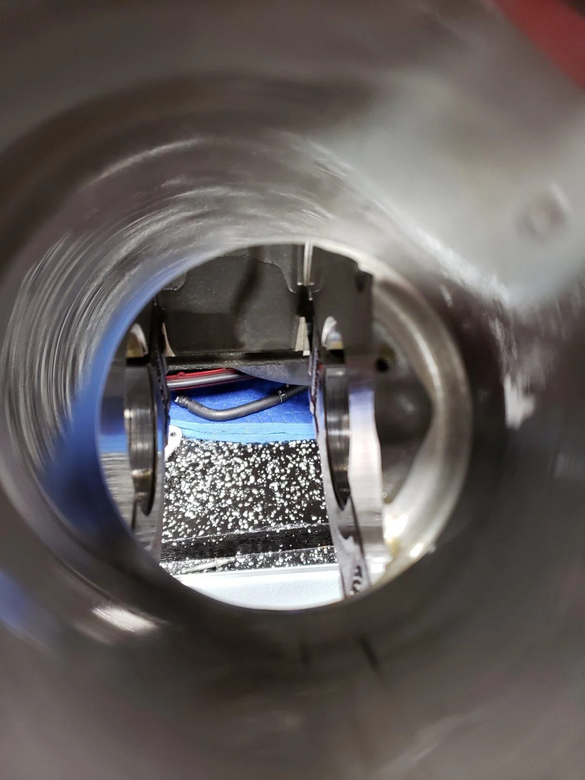

I did have a coupe of questions, based on work, as I didn't see some things I did in my NA build in I had done on an LS7 for durability and power... didn't notice if you chose special valve guides? In my build mold-star 90's were used, they're from F1, and the shop that did my heads made two big changes 1st- stud mounted roller rockers to make sure there was absolutely zero side loading on the valve stems..major issue on about 4% of LS7's in the early days of that engine; combined with the MS90 guides Kohle's claim was 100,000 street miles w/o any issues in the heads. The early LS7's could show issues at 18,000 miles on the street. When that work was done, I debated building a track LS7, but didn't; rather based the build to be used mainly on the street, so that I had minimal bottom end changes. However if I had gone for a track build I would have used piston squirters too as well as tearing into the short block like you have., I didn't see that you did that, or are you waiting for the next refresh - or did I miss them?
Great build! ..Larry
The valve guides are a special racing-spec bronze guide that RGR uses. I can't remember the brand off the top of my head, but I'll ask Aaron next time I speak to him.
Regarding the oil squirters (assuming that's what you're referring to at the bottom of your post), they'll be retained. According to Tim, he's able to keep them with the sleeving process and highly recommends them in road course setting. Here's a quick snap of the OEM one on cylinder #8 (tiny little hole at the bottom of the cylinder).
