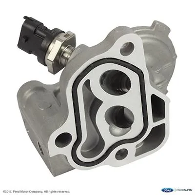

There's a "third port" on the oil filter adapter on the newer 5.2 liter block, which leads back to the sump, IIRC. It may be there so that unfiltered oil that overloads the filter pressure limit is bypassed back to the pan rather than being set free to roam around the engine and cause trouble.
Is that on the new canister-style OFA, or are you talking that's it has always been a part of the Voodoo?
I read about it in somewhere in an article or a post about assembling a Voodoo block, and they put the early gen oil filter adapter on and it leaked because there was a third port in the block and the early gen oil filter adapter only had two openings, not three. Unfortunately, I can't find it again, but I remembered wondering what the third port was for. So, to be precise, I don't know if it's on all 5.2 blocks or just the newest one, and I don't actually know what it's there for.
It's been on all 2015+ blocks, Coyote and Voodoo. It doesn't really lead anywhere, and the only way for oil to get there is to squeeze between the machined surfaces of the block and oil filter adapter. Here's a picture of the backside of the Coyote adapter which also fits the Voodoo block:
Thanks for clarifying - I appreciate your clearing this up - so it's vestigial or decorative at this point? Kind of like our appendix?
I wonder if the GT500 has created a use for it even if the GT350 didn't.
