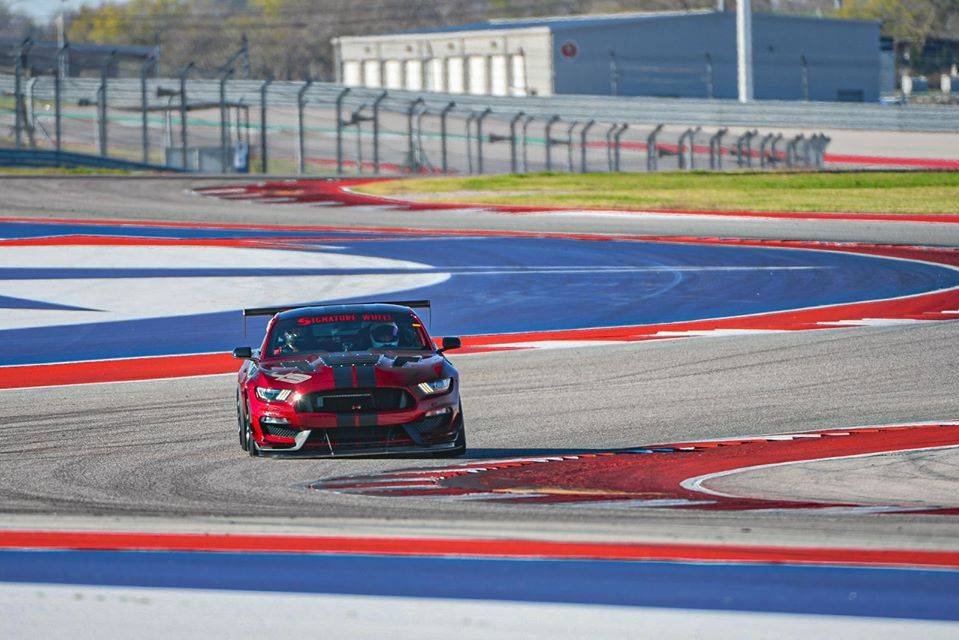

haha. It's pretty overwhelming to ride in HB these days. It's really, really stimulating with the sound and grip, and it's so easy for your senses to get overwhelmed.
It's funny, the organization I instruct with does lots of ride-a-longs/hot laps for people stopping by. They have me give many of the rides and I always warn people that it will be fairly overwhelming and then teach them the hand signals to communicate because you can't really communicate over the comms system at full throttle. It usually gets even macho guys to wince or "hit the brakes" going into turn 1 the first time. And 4 wheel drifting through the esses gets people pretty good, too. It's a ton of fun

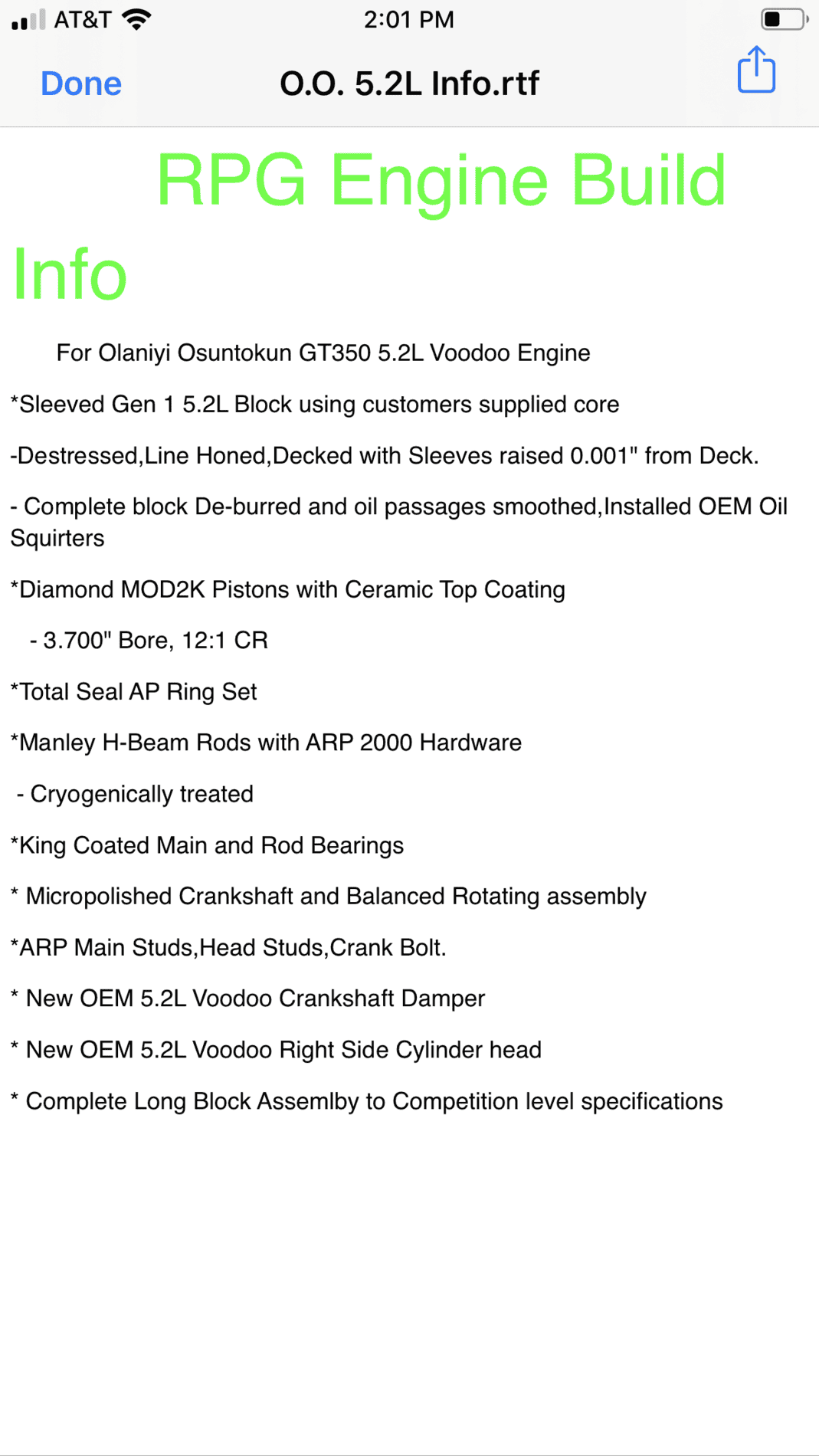

I know you had mentioned it could be blowing oil because of the diamond /piston combo in the past
I have the same pistons in my sleeved motor and I am also having oil consumption issues .
That's what Justin at JPC said, but am confused how that would result in oil pooling on TOP of the valves in the chambers? I've pulled the IM while the car is hot and I didn't see any amount of abnormal oil residue in the ports, so I don't think that it's "accumulating" in their and then dripping down. But not entirely sure. I still need to get the motor to Tim for a full investigation.
FWIW, I think he has changed rings, so it's possible it's contributing in some way. But I know of another engine that had the same exact short block build from Tim and they didn't have an oil burn issue. Hopefully we'll get it ironed out.
What rings are you running?

Thanks man .
I believe they are AP rings . Some details of my build below
