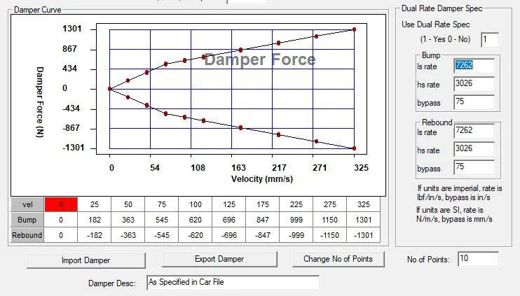

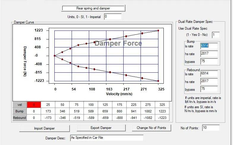

Factory is 1.3hz front and 1.5hz rear (springs) ride rate. What direction of weight transfer are you referring to? Lateral slaloms would mean a sway bar change, squat / dive would mean spring or shock change. The 350 has terminal understeer, which if you attempt to fight will throw the rest of the car off balance.
I am going to change my springs to 450lbs front and ~700lbs rear or 2.0hz front and 2.2hz rear(with a rear control arm change). The factory shock motion ratio is 0.7:1 which is pretty bad, that is how we can run 914lb rear springs and 194lb springs in the front (struts are roughly 1:1 motion ratio). My rear control arm change will INCREASE the MR to 0.77:1. (Plug** https://cortexracing.com/product/co...-adjustable-2015-2019-mustang-s550-and-gt350/ )
**Edit: I was corrected by Shogun** I misspoke when I quoted the shock motion ratio. I was going by memory and not what I wrote down. The factory shock MR is 0.7:1 and it is the factory spring MR that is 0.50:1. When the rear get swapped to the aftermarket control arm AND coilovers, the new shock AND spring MR will be 0.77:1
To keep things really short, a lower MR means the shock moves in this case 70% the distance the wheel moves. The less the shock moves the less distance and as a result less time to generate the appropriate damping forces. You have to make up for this by compensating / compromising other components and end up performing band aid after jerry rig after band aid etc.
I spoke with Cortex and they have the best customer service and knowledge base of any of the aftermarket companies I have spoken with. They also run a very similar spring rate on their GT4 car, and the shock forces I came up with are very near what they run as well. You could buy their off the shelf adjustable shocks and they will suit you plenty fine. JRI is made from former penske engineer(s) and you can request dual digressive and have the adjustments on separate circuits. Else they do a default adjuster that affects low speed Compression / Rebound and then High speed Rebound only. Which means you get some cross talk but it is a fairly standard way of doing things.
These are the shock forces I have for the custom valving cortex /jri will be doing for me(note* I have to adjust the fronts to reflect a small change in high speed forces I had to make in the rear):
Front
Rear

Except the MR of the shock IS currently 0.72'ish is it not? That the spring is 0.5 is not important.
uhhh, since when is there such a thing as 'high speed' Rebound? Compression, sure. The mass of the car is fixed and so it the wheel assembly. unless you're running multi-rate springs, the acceleration of the wheel assembly (or of the car) is directly proportional to the weights and spring rate and displacement. What have you calculated the max velocity to be from say a 1.5" displacement at the rear spring acting on the ~120lb wheel assembly mass?
I sure would NOT want to be in a car that had equal force curves for both compression and rebound!
I am going to change my springs to 450lbs front and ~700lbs rear or 2.0hz front and 2.2hz rear(with a rear control arm change). The factory shock motion ratio is 0.5:1 which is pretty bad, that is how we can run 914lb rear springs and 194lb springs in the front (struts are roughly 1:1 motion ratio). My rear control arm change will INCREASE the MR to 0.77:1. (Plug** https://cortexracing.com/product/co...-adjustable-2015-2019-mustang-s550-and-gt350/ )
To keep things really short, a lower MR means the shock moves in this case 50% the distance the wheel moves. The less the shock moves the less distance and as a result less time to generate the appropriate damping forces. You have to make up for this by compensating / compromising other components and end up performing band aid after jerry rig after band aid etc.
Front
Rear
All directions. Dives too much under braking, squats too much under hard accelerations, and rolls AND compresses too much under lateral load. You can try increasing sway bar, but it still won't respond just right because it's under sprung and dampened. I have mine very well-balanced for how soft it is - it's just overwhelmed with all the aero. My biggest complaint is that it really struggles with quick direction changes and medium-speed turn-ins. Just all around too soft. Hopefully will get a chance to fix soon-ish.
