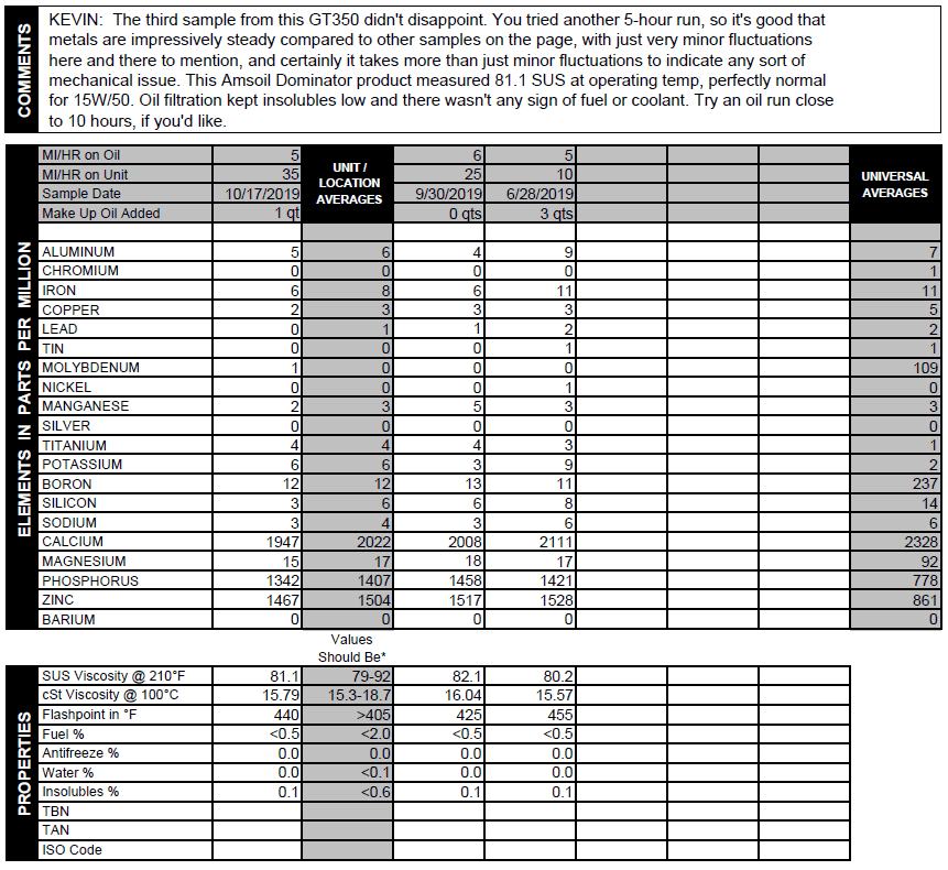

Got my second Blackstone Labs report back from my July track days. This oil came out after 2.5 days at COTA in 100* heat just being pounded. Looking great so far
Looking at these results, seems like you could get at least 3-4 events on a change, especially now that you've got your temps under control. Additive breakdown isn't a factor on this timescale and you're not seeing any reduction in viscosity or shear.
Agreed. I'll still change it every 4-6 hours purely because I'm on my own dime now and would hate a journey towards catastrophic engine failure to be accelerated due to oil breaking down or getting coolant/water/fuel in it (although unlikely).
But it is great reassurance that this Dominator oil is working well for me and I have a cushion.

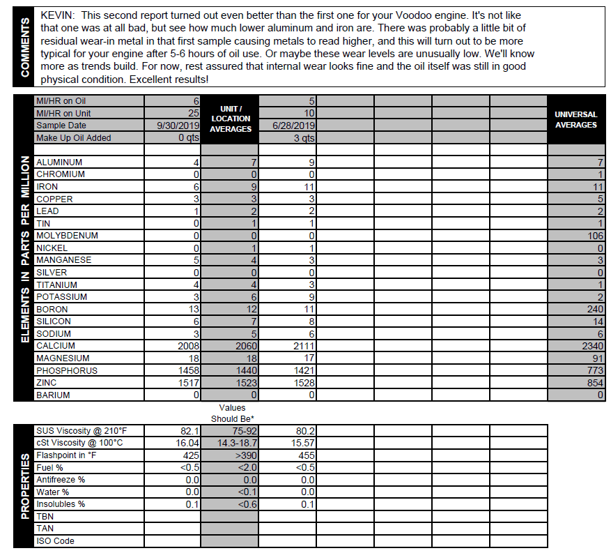

Another lab report. All is looking perfect. Motor has about 30 hours on it now. Debating on opening up the valve covers over winter to do retainers and check things out. Make a few other upgrades like a vacuum pump and the upgraded secondary tensioner.

Fascinating. Your used Dominator 15w50 is actually a smidge thinner than my last UOA of Motorcraft 5W50 with 6500 miles on it. As I'm sure you're aware, that's the oil that shears down to water the moment you unscrew the bottle cap. It came in at 16.0.

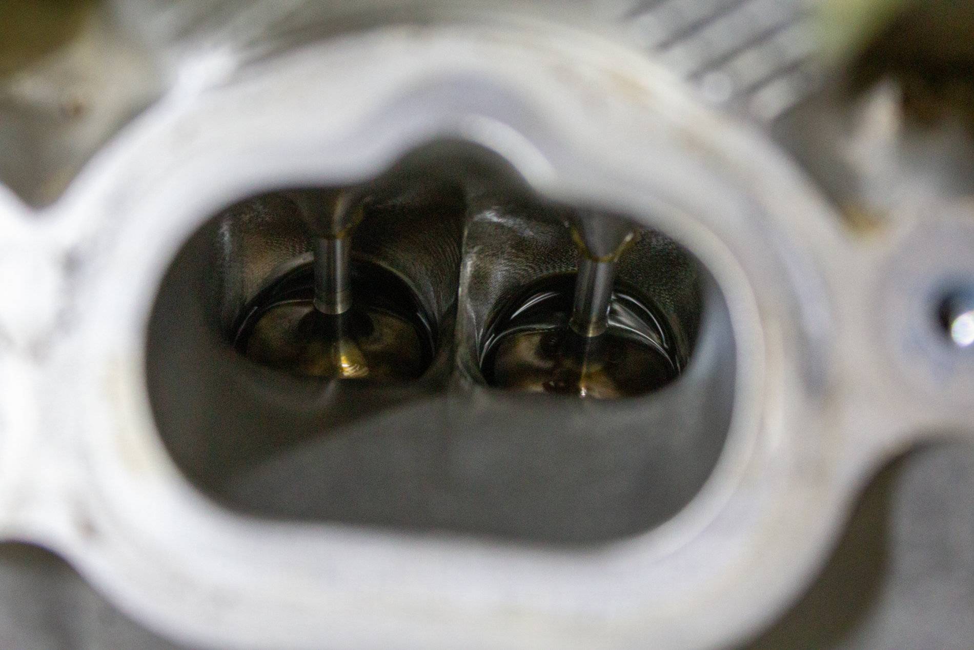

So I've mentioned that the new motor smoked a bit when cold before. Over the last 2 months, it's been getting a bit worse. Enough to catch my eye and get me thinking.
While I'm working on a heater core bypass between events, I decided to do some digging. I've noticed that it'll also blow a puff of smoke if I let it idle for too long - this indicates valve seals. I originally thought ring gaps because once it got hot, it went away. Today I pulled the intake off and looked into the intake runners and saw that some oil has pooled up on the valves. Definitely bad valve seals IMHO. Fortunately/unfortunately, I'm coming up on the 40 hour maintenance interval for the valve train. Looks like I'll add these to my list for winter maintenance. I'm planning on a full engine removal and investigation this winter, so at least we'll get to dig in and see how the built motor is wearing otherwise.
