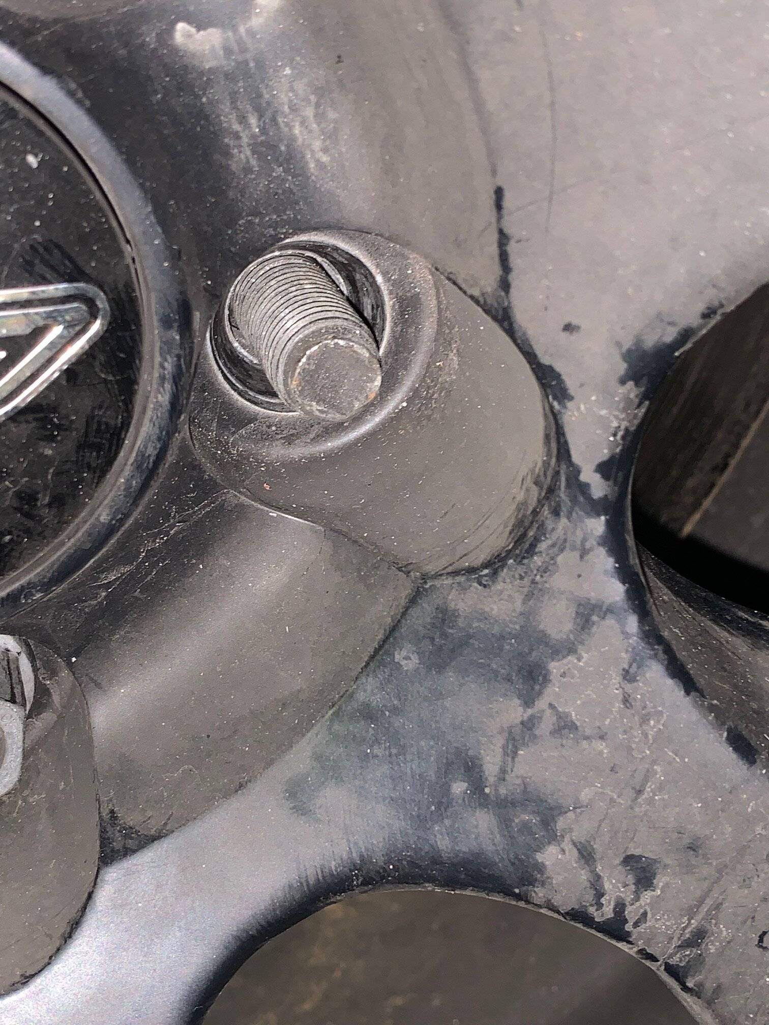

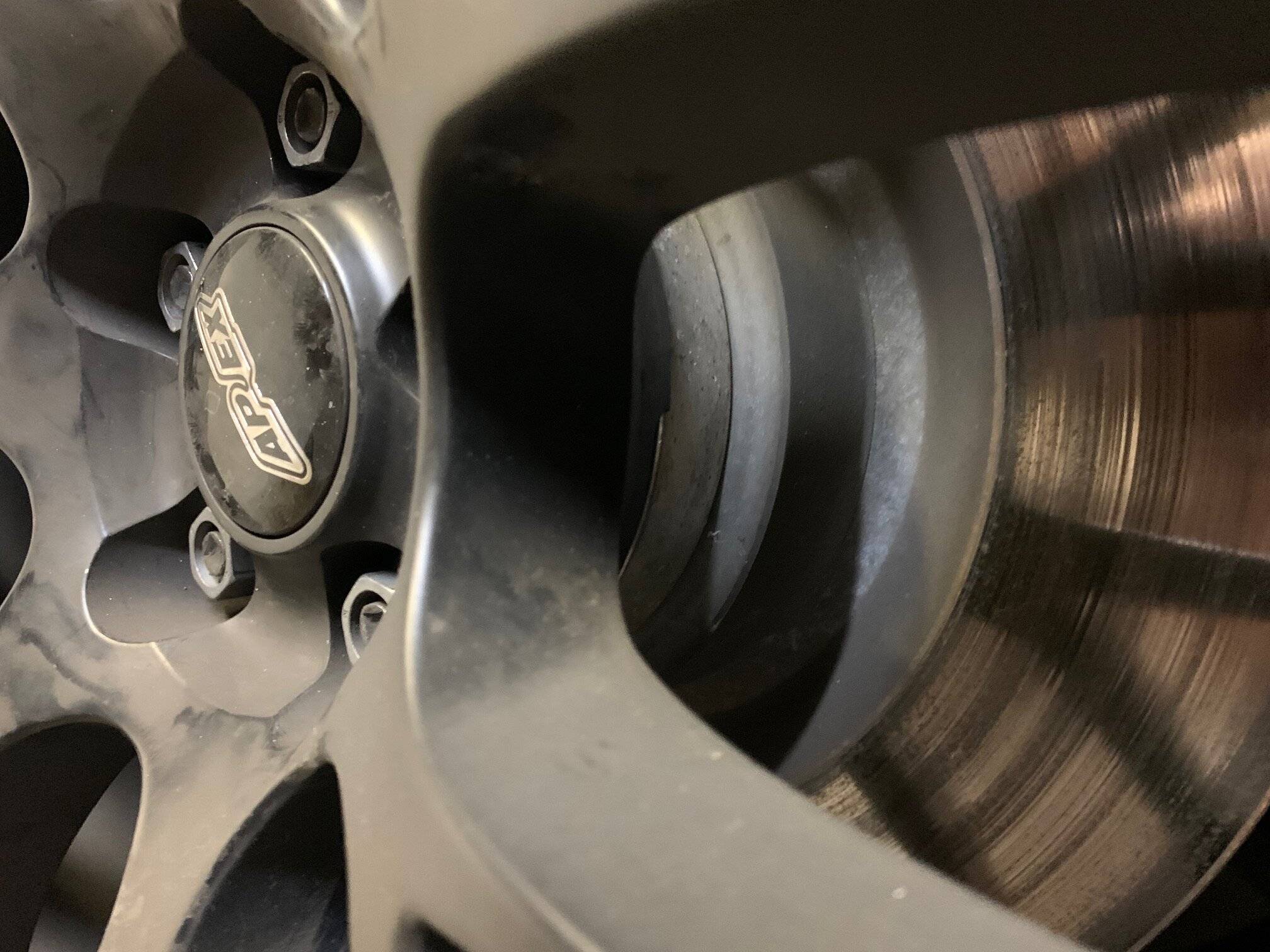

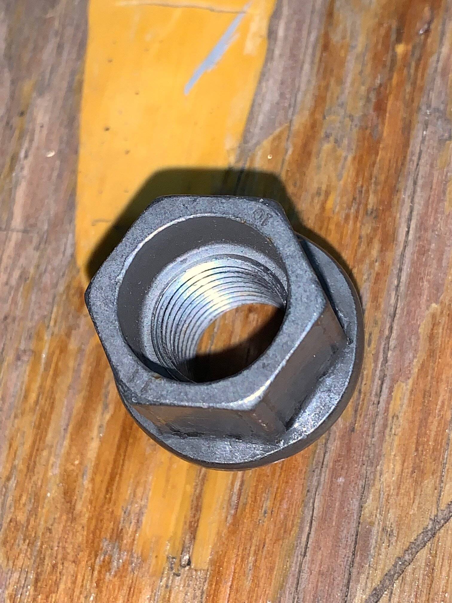

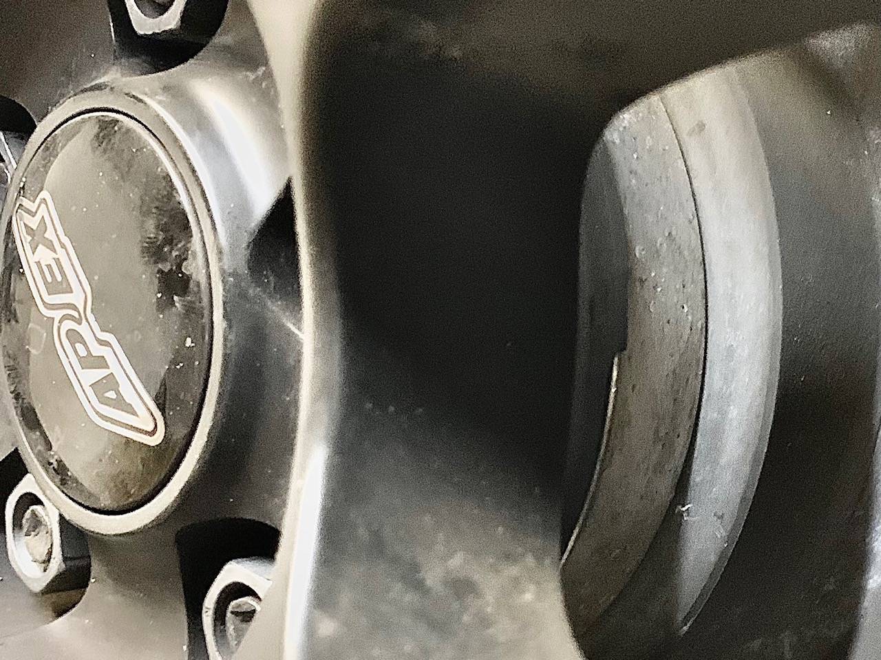

The images of the 610-333 are somewhere on the forum
images 610-530 below:
18x11 ET52 Apex with 24mm spacers and Ford Performance lugnuts (ten threads).
You can see the spacer between the wheel and brake rotor
lol, wheels are protected by a coating of brake dust.
