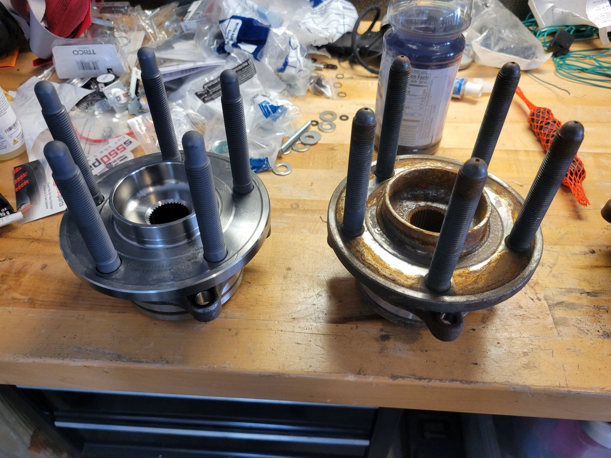

whats the difference between the GT4 studs and the R Spec studs. Wasn’t immediately apparent on the website
I just put GT4 studs in my new hubs after having R length in my old. Overall length is basically the same but the GT4 studs have a longer "nose" before the thread starts.

I run these up front and the corresponding ones on the rear. The MSI studs are true R length, so they allow 31mm spacers with 52mm offset 19x11 wheels. The longest ARP studs didn't lave much thread after torqued down--always made me uncomfortable. Not to mention they only allowed me to use a 25mm spacer.
