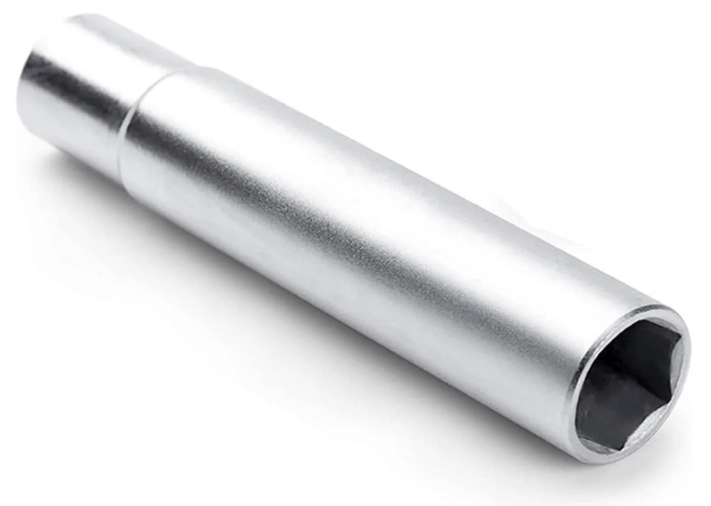

I went through your writeup on changing the front hubs and I've got two things to add.
First, you said you couldn't torque the back hub mounting bolts because a torque wrench doesn't fit in the gap behind the rear bolt heads. I've had mine on and off a bunch of times, and you can do it with a crowfoot socket on an extension. It's awkward because you can't ratchet the socket, but with a little patience, it works. Getting those bolts tight is REALLY important.
Second, you get a lot more room to work if you slide the caliper completely off the studs and hang it aside - I slide a broom handle through the front subframe and slip it through the gap between the pads and let it hang out of the way. Then you can use the steering wheel to turn the wheels in and out - you have more space to work and you can access the bolt heads much more easily that way.

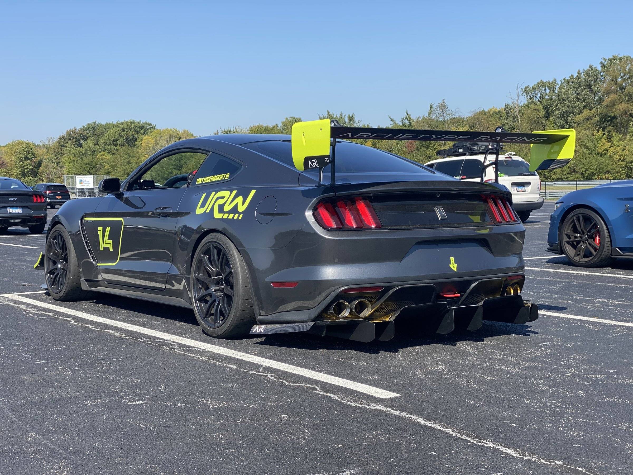

Apex 19x11.5 square et56 back spacing with 31mm op front spacer and op mustang gt4 studs all around.
fronts were super easy to do, about 30min with the stud installer from amazon $20. REARS sucked
