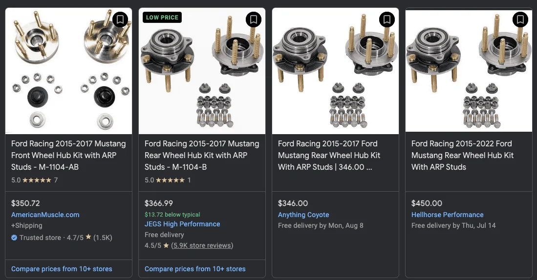

@TonyNJ The kits are super easy to install. The nice thing about them is that they don't require a press and pretty reasonable from a cost perspective.
Probably 30 minutes per hub. For example:
When the rear bearings go out I'll probably do the rear kit. Bearings on these cars need to be changed all the time and the FP kits are pretty convenient.

So, @TonyNJ said he wanted to install GT350R CF rims on his 2020 GT350. None of the parts in your post are useful for doing that. At the rear, the FP listing for M-1104-B specifically says they won't work on a GT350R, and that's because the studs are too short. So, they're no help. At the front, the part M-1104-AB in the picture and in the video is for a GT with a stub axle. They won't install on a GT350 because Ford didn't use a stub axle on the GT350.
What problem does @TonyNJ have to solve to get his R rims installed? Well, the GT350R CF rims are very thick where they go on the hub. The fronts are 1-1/2" thicker than a regular aluminum rim, and the rears are about 3/4" thicker. The factory hubs, FR3Z-1109-A for the front and FR3Z-1104-E at the rear, have the right length studs to make the CF rims work perfectly with factory lug nuts. There are aftermarket studs that are long enough - OP Mustang offers a selection and they come loose or installed.
