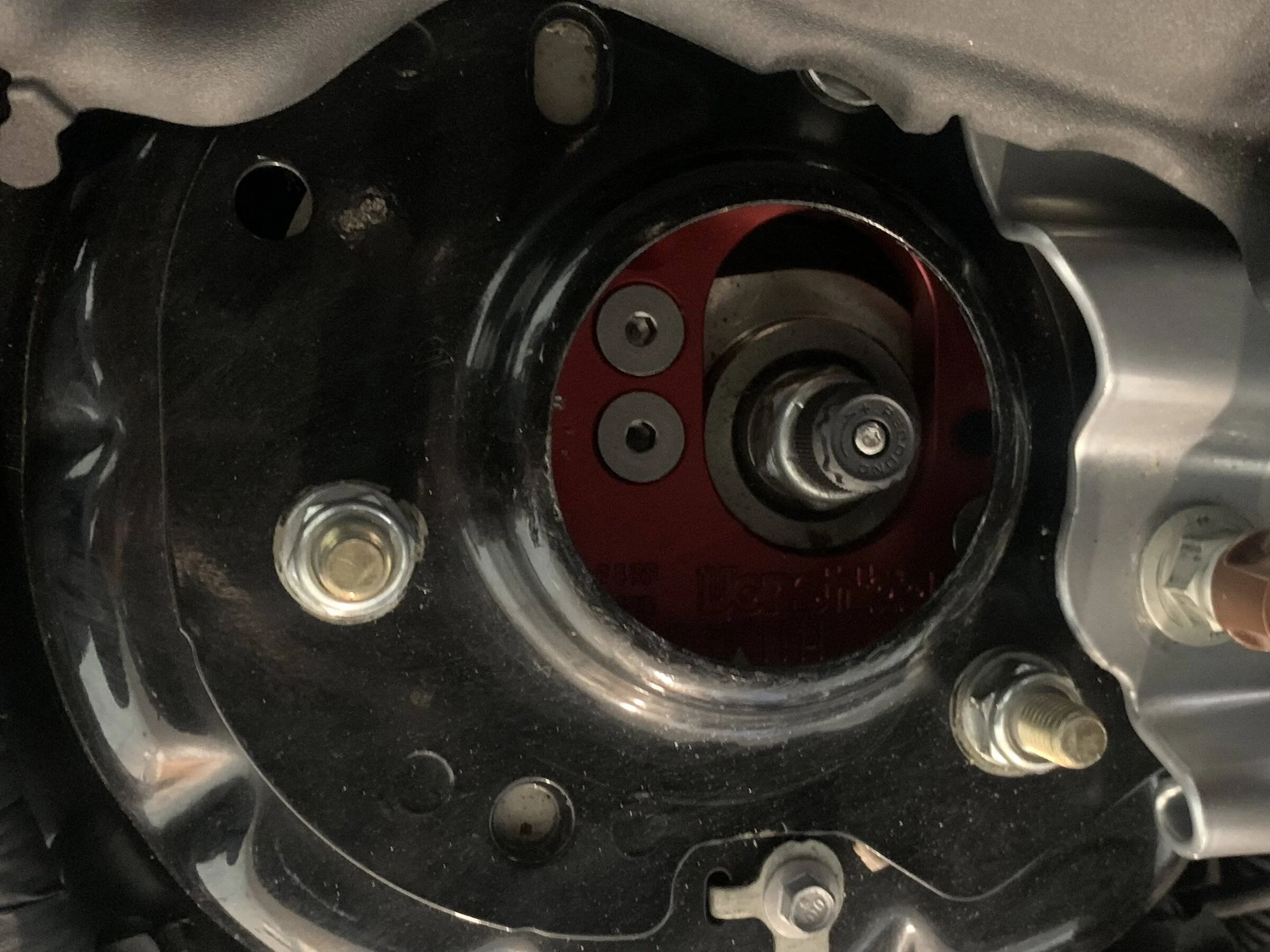

What camber plates are you running?
What camber plates are you running? The 35MM show out of stock now.
I'm using Steeda - wanted to keep a little rubber in it for NVH, but went back and forth between that and Vorshlag. I'm also using Steeda camber bolts. In-season I am staying at -3* up front and off-season more like -2*.

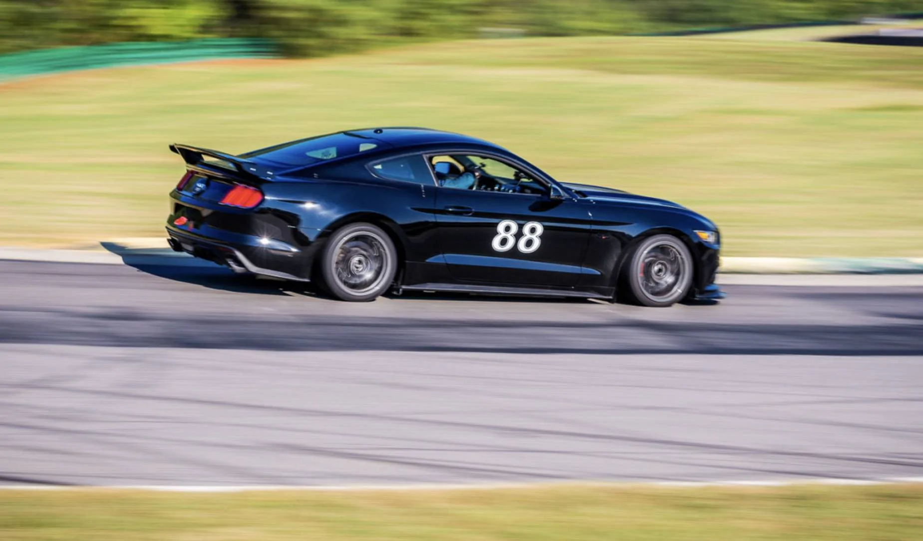

Vorshlag and opened strut hole for additional adjustment. Neg 2.5 camber all round. 295 x 18’s toyo RR’s.
Apex EC7 18/11’s 25mm spacers up front Ford GT4 extended studs..
