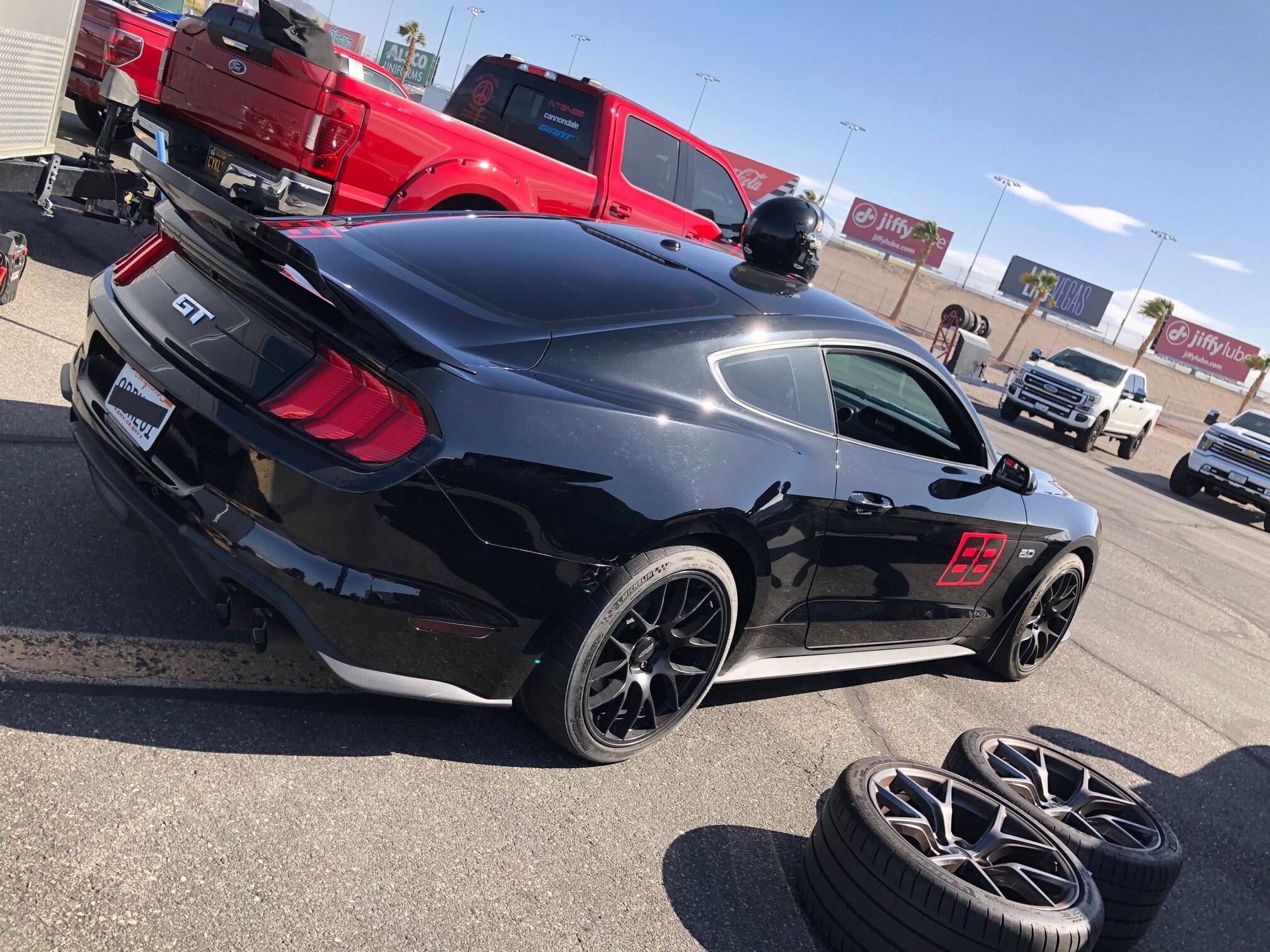

As recommended by Apex, 25mm front spacers with ARP extended studs, EC-7s 19x11 ET52 squared (only 24.5 lbs ea). Cornerweighted with -3.0 ft and -2.3 rr using GC front camber plates. I have used up the 305 Sport Cup 2s and now putting on GY Supercar F1 3Rs which are a bit wider in profile.
My PP2 is well balanced on multiple tracks here. Solid wheels and setup, can't complain. For more peace of mind, yes, rear extended studs are best but had no issues with stock with proper torqueing and rechecks between sessions. That would be my next step.

Quick offtopic question - do you see any noticeable improvement on track after installing this spoiler versus stock PP2 lip?
Not yet on this short handling track at LVMS, but will test it at Auto Club Speedway in Nov. I'm hoping should be noticeable at end of front straight, about 145+.
