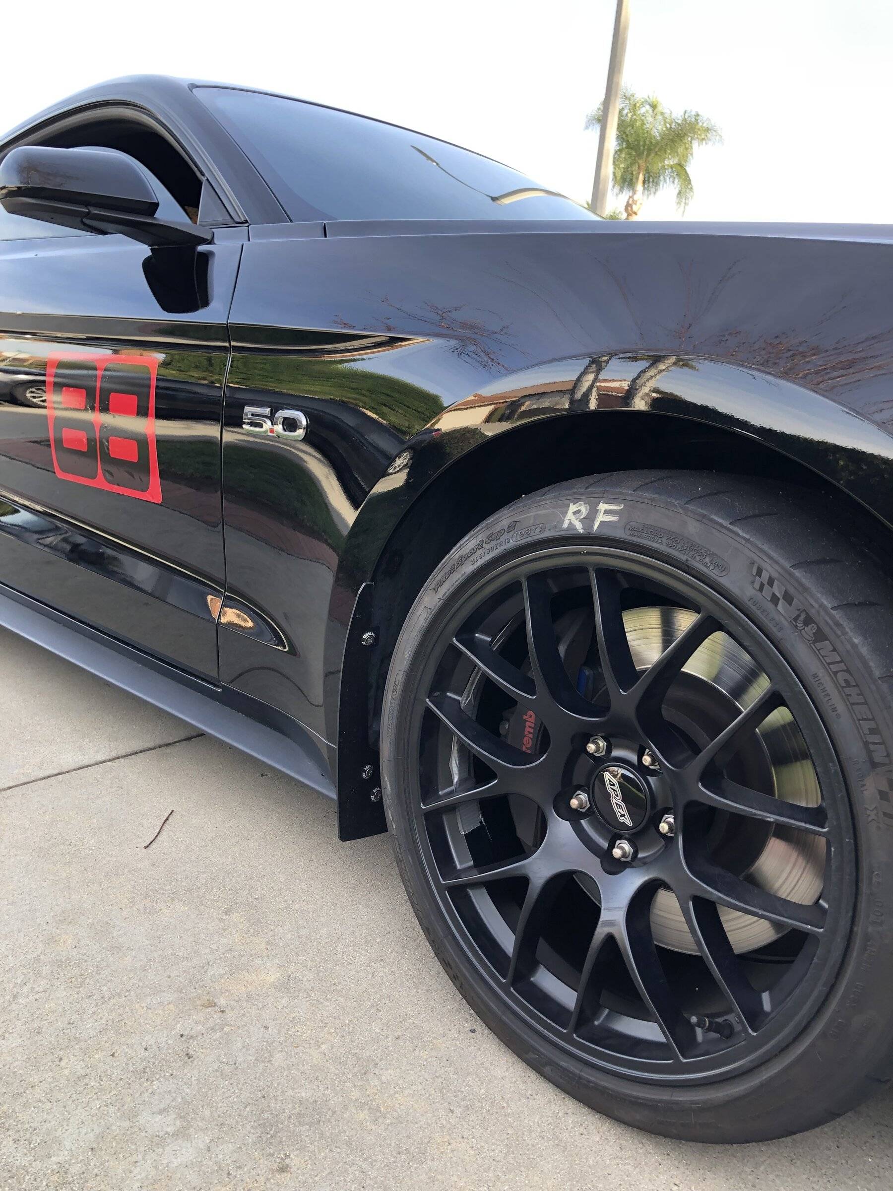

I've been tracking the M-1107-C with no issues on the PP2 which it turns out has the GT350 hubs. Run them with 25mm spacer front for the Apex 19x11 square setup, open lug nuts.

With the bullet ends on those do they give you enough threads to fully tighten down the lug nut with some extra threads to spare?

Yes, threads left over. Note that I’m using Apex track wheels ,other wheels may have diff thickness. Have to use open lugs, safer
