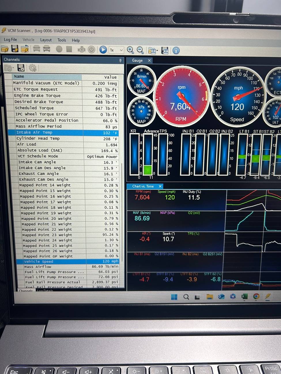

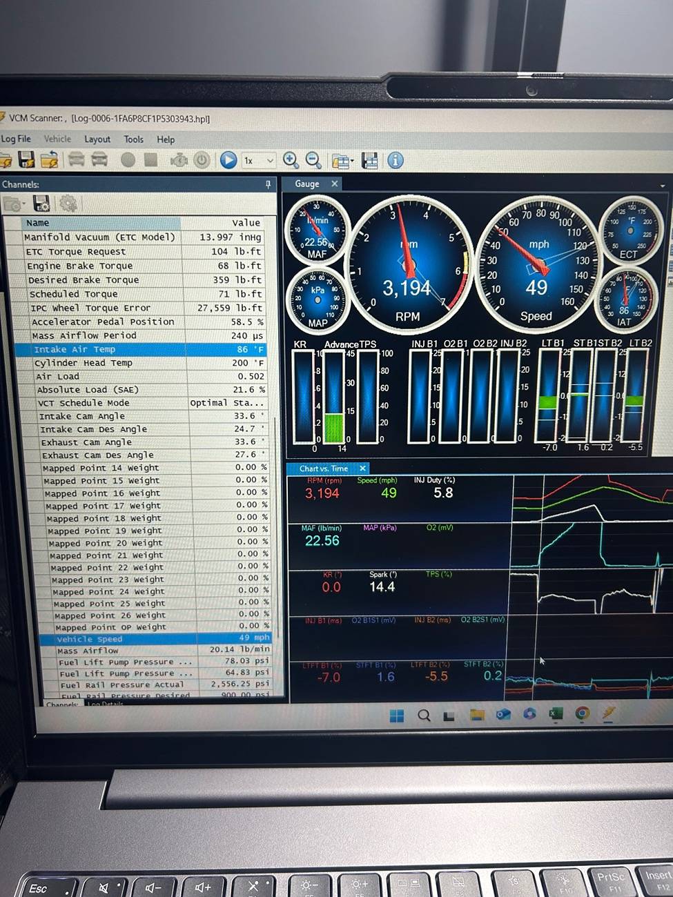

50 mph to 120 mph, i want to say 3rd gear but i dont remember
Summer day so maybe 80-85 degrees outside
Please apologize the shitty view, i really dont use vcm scanner at all so i did what i could, but i go from 86 deg farenheit to 102. About 15 deg raise. I cant see the map sensor readout here, so if you can tell me how to find it, i can check but heres my unrefutable data of a street pull on a g3x kit, 93 pump gas from shell, manual tranny, stock clutch, g4 intercooler, bap, stock fuel pump, 4k miles on the car, gt500 injectors
let me know where the holes are to be poked in this data gentlemen

I think you have mixed up what im referencing, our debate is if centri or pd are better thermally, i wasnt talking about flows, i know a whipple will make more hp than ess, but an ess wobt take a huge loss of hp on heat when a whipple will
either way, i posted my data, it supports what i said and claim for ess. I have an external boost gauge that shows 8-11 psi depending how high i rev and temp outside.
the only two reasons i can think of, besides a cheating argument of using ice or something else, is your data on the whipple is not showing true temps through the sensor location and whatnot, or because the water cooled system will hide the heat issue for long enough to show your one pull, and possibly after 10 pulls your setup will finally show what actually goes on heat wise inside the blower. As far as which way the data is skewed i cannot say, but im certain a whipple will not beat a centri for heat
