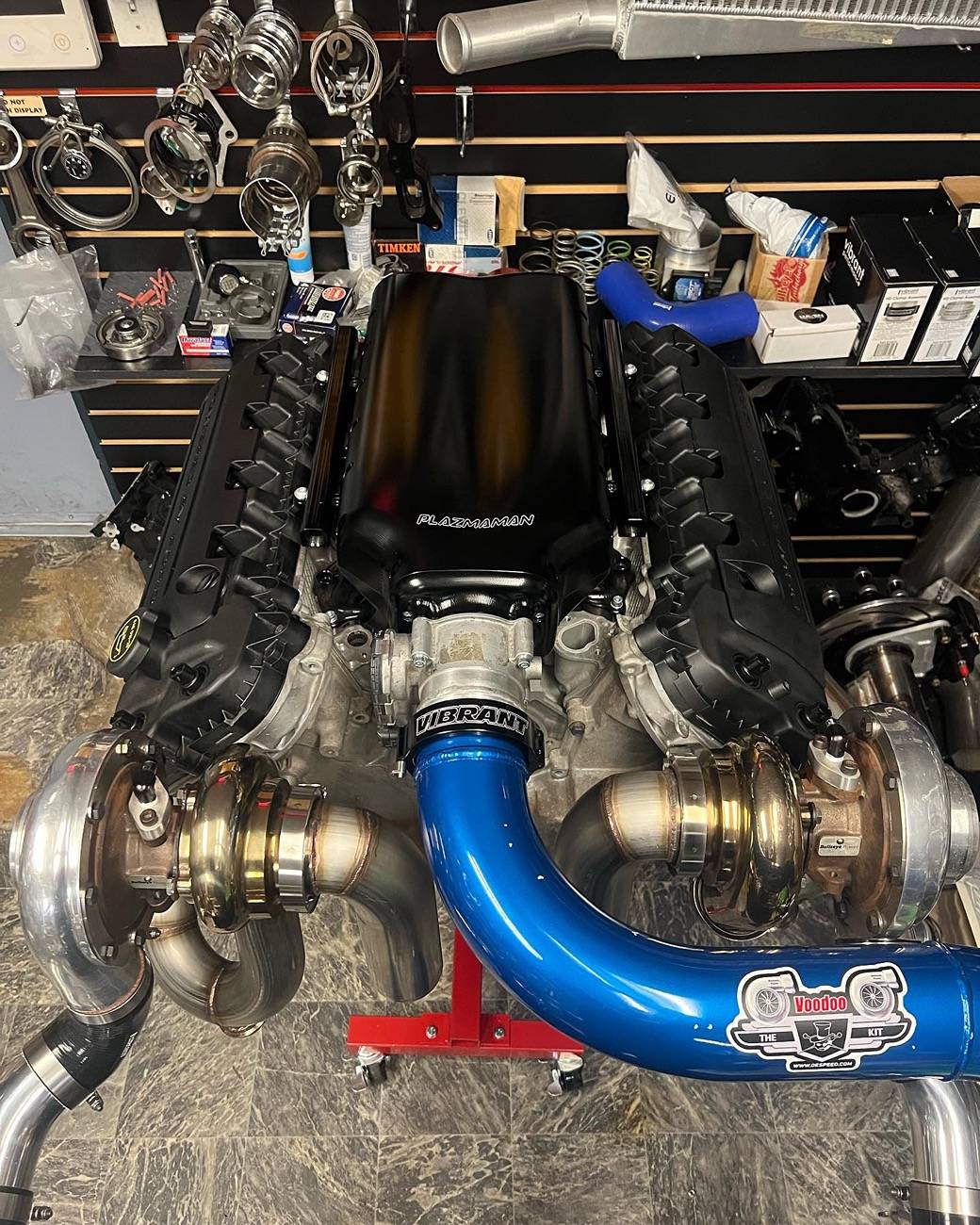

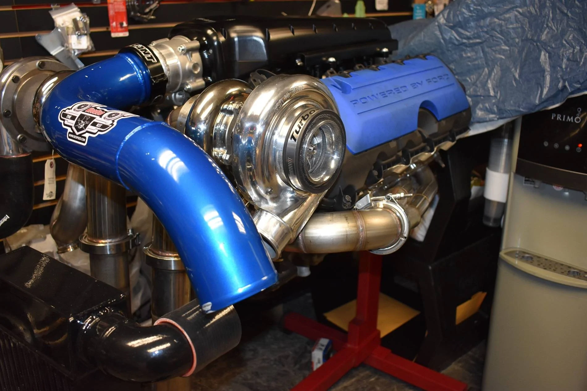

im pretty much sold on a single turbo set up ( custom build) with water to air. where I live and our condition's for 9 months a year leans me in that direction. Also I just love turbo’s , and totally agree on the controllability with boost ramp etc.
im lucky enough now I’ve been in multiple boosted types of coyotes. (1)2017 custom top mount 6r80 twin turbo (2)2018 Whipple manual (3) 2019 ESS g3 10 speed. (4) 2019 roush 10 speed. Listed my most favourite to least favourite. all 750hp Cars give or take a little.
now I’ve been able to go in all of them it cemented my goal to go turbo. As it just felt and sounded best to me.
There is Nothing really on the market that fits ozzy cars well or how I would like it. so I’ll end up building my own set up. Utilising some headers etc that are already available.
There's a reason everyone migrated to twin setups. A big single is a "race only" type application because once you put the car into a narrow upper rpm range, you're not as concerned about boost lag.
I suppose having a 10 speed now makes a big single more attractive for street use, but unless you're going to deal with big turbo lag or beat your motor to death with some sorta anti-lag, a big single makes steam, but takes the upper half of the tachometer to do so.
Maybe that's attractive to some, having the car behave very sluggish and pedestrian at the lower half of the rpm range and then like a maniac up top.
For a full on drag car, a big single is simpler and works. For a daily, I think I would prefer a smaller pair of twins for immediate response.
