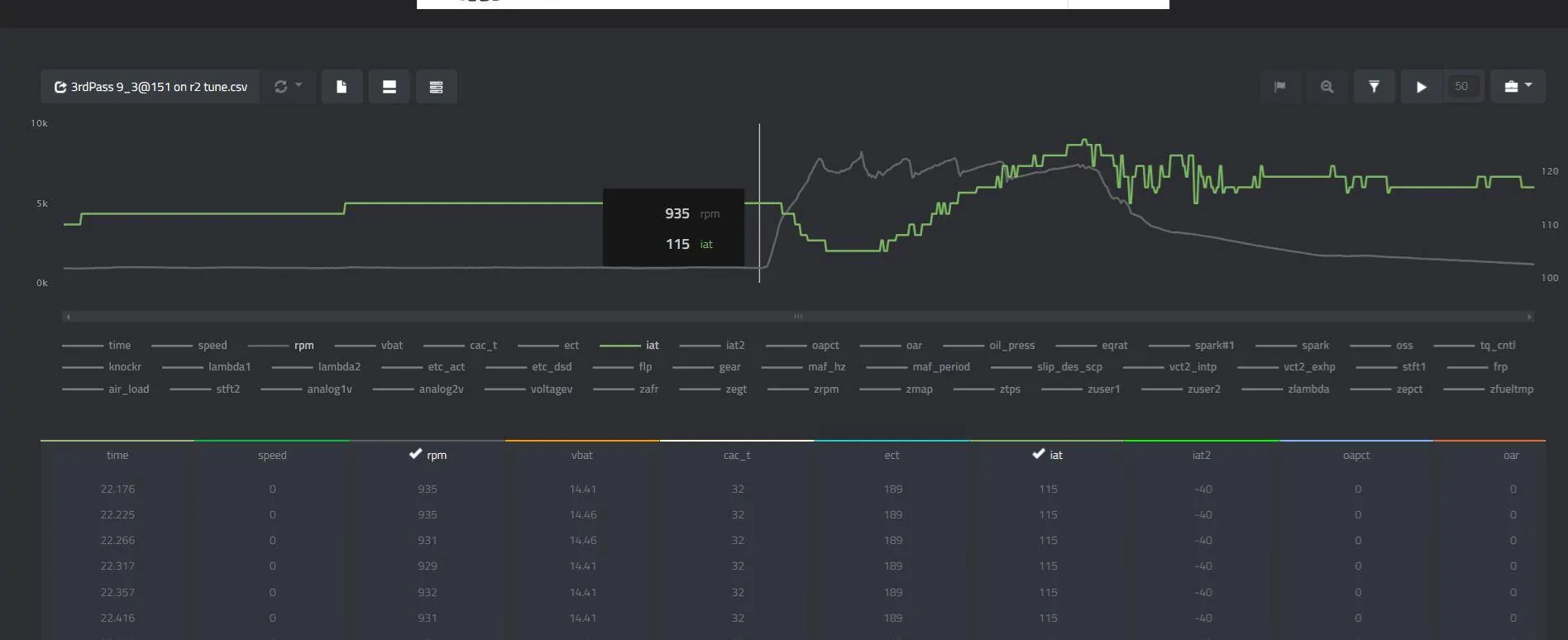

I dont know if this will add anything of value to this thread, but this is a log of my car, ESS G3 with G4 intercooler. I have my IAT sensor relocated to above the 8th cylinder in my Holley low ram manifold. This is on a 100mm pulley, on a 9.#@151 pass. IATs start at 115 and end at 127 at end of the pass. I believe the sensor gets heat soaked from sitting in the aluminum manifold. I used to run a GT350 manifold and I had my IAT sensor located just behind the throttle body. It would read 15-20 degrees cooler on that setup.
Very nice of you to provide data on the exact data we need, but never thought anyone had!

Please apologize the shitty view, i really dont use vcm scanner at all so i did what i could, but i go from 86 deg farenheit to 102. About 15 deg raise. I cant see the map sensor readout here, so if you can tell me how to find it, i can check but heres my unrefutable data of a street pull on a g3x kit, 93 pump gas from shell, manual tranny, stock clutch, g4 intercooler, bap, stock fuel pump, 4k miles on the car, gt500 injectors
let me know where the holes are to be poked in this data gentlemen
Thanks for finally posting up some real data.
You are running the 8 psi pulley, the largest intercooler they offer, and did a single gear pull from 3200 to 7600 rpm. That means your run started between 3 and 4 psi and ended around 8. So in about 6 or 7 seconds your charge temp rose 16 deg at an average of 6 psi boost. That sounds pretty believable to me.
Coincidentally, yesterday my buddy sent me a Whipple log at 18 psi to review. It wasn't quite as long a duration, but the charge temp was basically flat the whole time. <1 deg rise even though the boost was much higher. I checked some of my older single-gear pulls and found the same was true in them. And before you cry foul over the location of the temp sensor, it is definitely in the airflow path. For comparison, the Roush log I posted on page 1 has the MCT sensor tucked away deep in a hole (some Roush guys figure out ways to insert it deeper to get it into the airstream) yet it still showed the 35 deg gain in 6 seconds. Sensor response and accuracy isn't an issue here.
Thanks for the log. Nice run! Was this log with your Snow Meth kit active?

In your pass, the charge temp dropped after the pass started. This is pretty common because the IAT can be high idling in the staging lanes and staging, then when the IAT falls and the thermal capacitance of the intercooler is still working, the charge temp can actually go down initially before rising. I'd say your temp rise is actually a delta off of the min temp which appears to be around 105, for a rise of about 22 deg. That's pretty low for a full pass and an air/air setup.

Did you? Only thing I remember seeing was a single gear pull. Great log for your tuner to review but not long enough to provide any valuable data.
I did a 50-120 mph pull, as far as anything street related, thats 90% of any of our drives. Would you like me to log 10 consecutive pulls after each other? I didnt think thats what were looking at
Im running the max i can for pump gas 93, ive said this many times that im able to get these temps with my setups and yall said its not possible unless im making subpar boost
