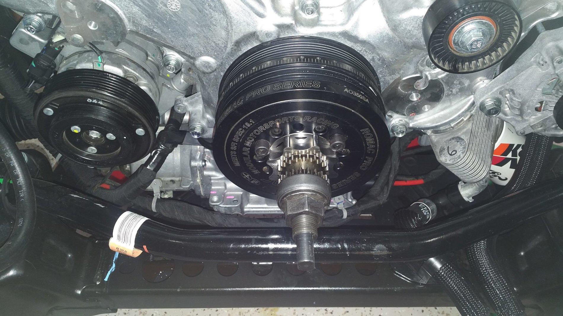

WIll at RPG tuning is almost done with the replacement 5.2 short block .
Gen 2 5.2 block with Manley H tuff rods / 11 :1 pistons .
I had another set of GT 350 heads I thought I could save but cams are scored beyond repair .
So will be assembling long block with new GT heads / stock cams and PAC springs .
Hopeful the longer 12 mm head studs will help with lifting and springs should take care of float .
Going it be using the the GT 350 spec phasers / Boss tensioners and new chains .

Plan on a long block or a lot of head machining. The valves will most likely still be intact but in my case none of them would seal properly. The majority of the rockers broke and the one hero rocker that held out resulted in a broken cam cap. Also, all that debris in the heads left scoring and gouges inside the heads and on some of the cam lobes.

No one mentioned sending that broken piece to a metallurgist, they can evaluate it and tell you exactly why it failed.
No reason to waste the money on shipping. That crack leading from the keyway is all that pretty much needs to be said.
Twisting one off is one thing, cracking it in half is a totally different issue. The key/keyway was obviously upset about something.
Either to tight, or two loose, or something.

Cracked keyway might just mean very heavy parts with significant inertia on opposite sides of the keyway wanted to be turning at different rates and the torque attempted to be transferred across the keyway grossly exceeded the designed capability.

Multiple scallops appear from cracks propagated from valve impacts binding the valve train. Each "self clearancing" event imparts force above the yield strength of the case hardened surface at the snout trying to turn the bound valve train. If you have multiple concentric rings in each scallop then you had multiple impact events at each angle. You can measure the angle of the scallops and work backward to see the same angle/timing on the cams. I had massive chain stretch/lash in the timing chain and evidence the chain was overloaded. Expect chips from the teeth of the timing gear. These are not clearance engines so if the timing chain rides up the timing gear teeth and then slips timing, you will bind the valve train and break the crank snout.
Now, I did get some advice about the wear patterns on the crank, timing gear, and damper: there was some localized strain hardening and compression damage on the case hardened surface of my crank snout. Evidently, the forged timing gear I was using is perfectly straight center bore with very sharp chamfer internal edges. As the crank had been flexing over time, these edges dug into and left long term surface compression strain hardening marks. The cracks look like they go from that surface damage immediately inboard thru the case hardening to the step in the crank diameter (stress riser).
I was advised it would be wise to substantially round the inside edges of the timing gear to increase the compression edge interface during overload to 10x as much area if possible. That would be a couple mm softer radius instead of a hard sharp chamfer inside edge.
Also, my damper was bottomed on the timing gear. ie the timing gear was sandwiched firmly between the crank shoulder and the inboard face of the ATI damper. This is very important. It means that IF the crank tries to flex to absorb shock, the TG/damper have a substantial longitudinal bending moment advantage - meaning all bending in such a stack up can only occur by lengthening the crank (guess how?) at the far side enough to allow the interface of the shoulder/TG and TG/damper to open. Basically, the sandwich makes for a freakn stiff ass crank snout that might be stiffer than even stock.
In the future, I would definitely make sure my TG longitudinal compression is exactly same as stock and that the TG can 'float' some on the crank (on the keyway) and that the snout can bend slightly without the TG/damper stackup binding. I will also ONLY use the FRPP forged TG going forward.

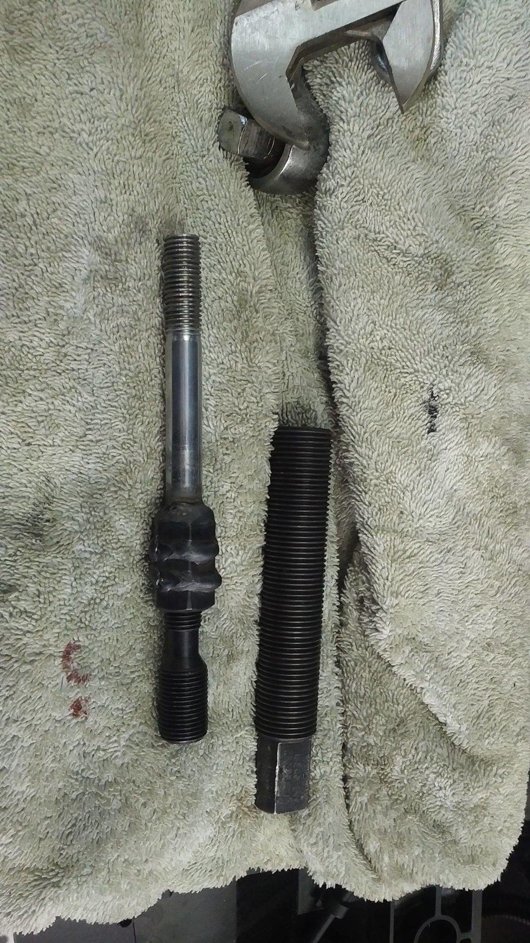

And using a bolt to try and pull on a balancer that’s too tight,or bottoming out said bolt. As said before. Proper interference fit, and proper installation tools.
Has anyone actually confirmed bottoming the install bolt caused their failure? I actually made this mistake and pushed over the first couple threads on the install bolt. I was able to chase the threads and start over and install the balancer. I was super worried about it and called MMR and they said I just ran it in to far and would be fine that they have never seen that cause a crank failure. Not much I could do now but I am just curious. I did it with a socket wrench not an impact I hope that is my saving grace.
Without hammering it with an impact or large breaker bar trying to force it on you should be just fine.

No way that the install bolt will cause a failure. If you bottom out the bolt you will strip out the threads long before fatiguing the snout itself.
I'd have to disagree. The bottom of the bolt hole, and the end of the bolt are basically wedges. Forcing the bolt into the bottom will stress the crank trying to wedge it open from the inside out. But also like you said stressing the threads tensile pull, and thread galling. Bolt loosens and balancer loosens losing it's absorption purpose. 99.9% of people will never know. Just assumptions. Most I've seen had an obvious crack develop. Longitudinal crack doesn't come from belt tension or load or anything like that.
