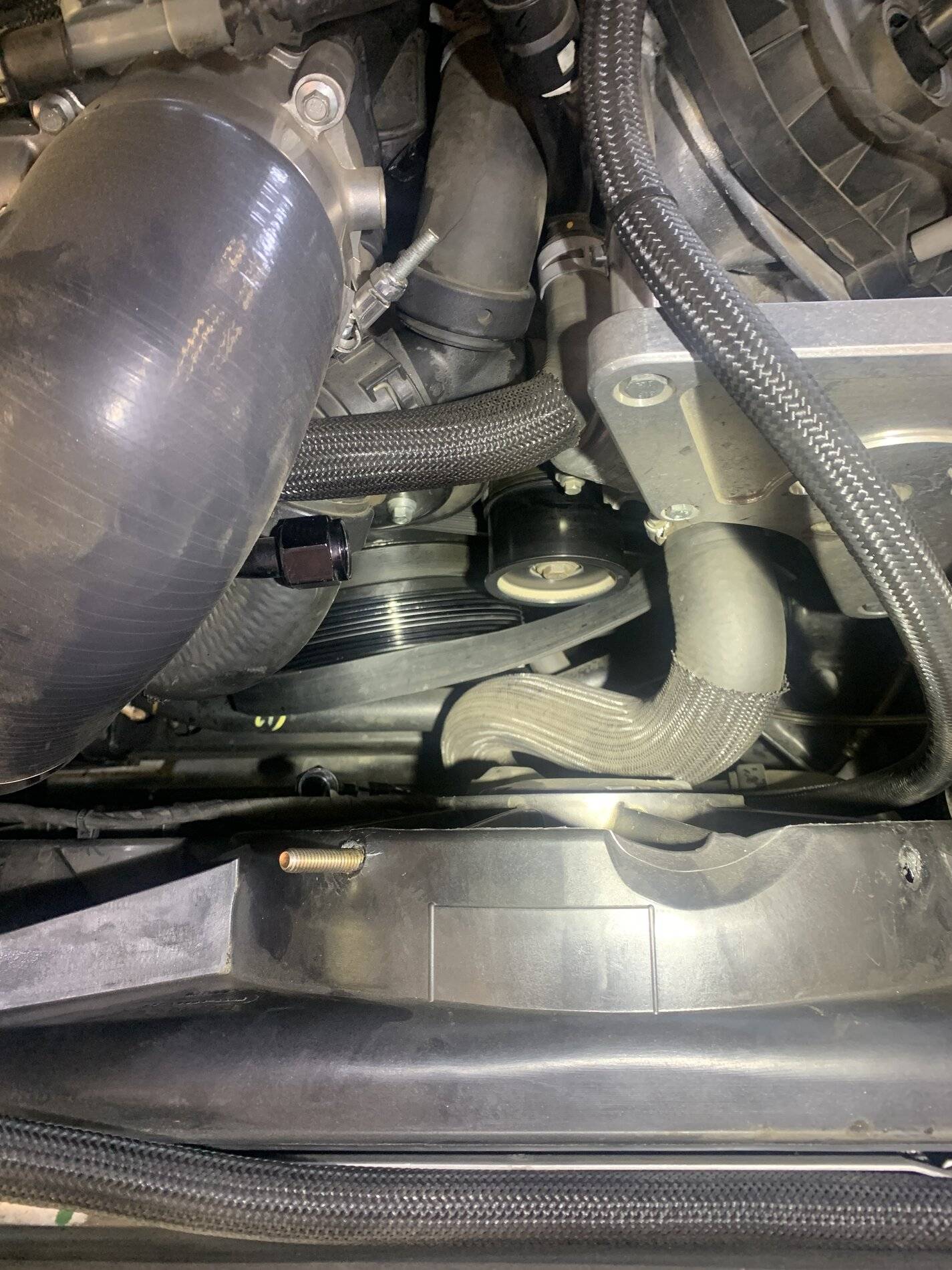

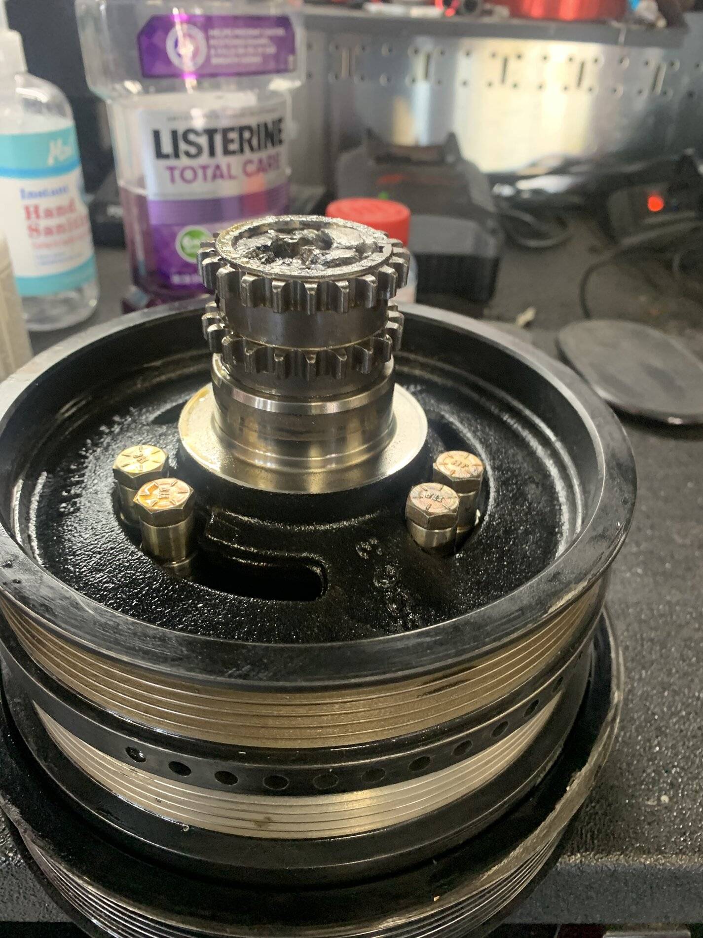

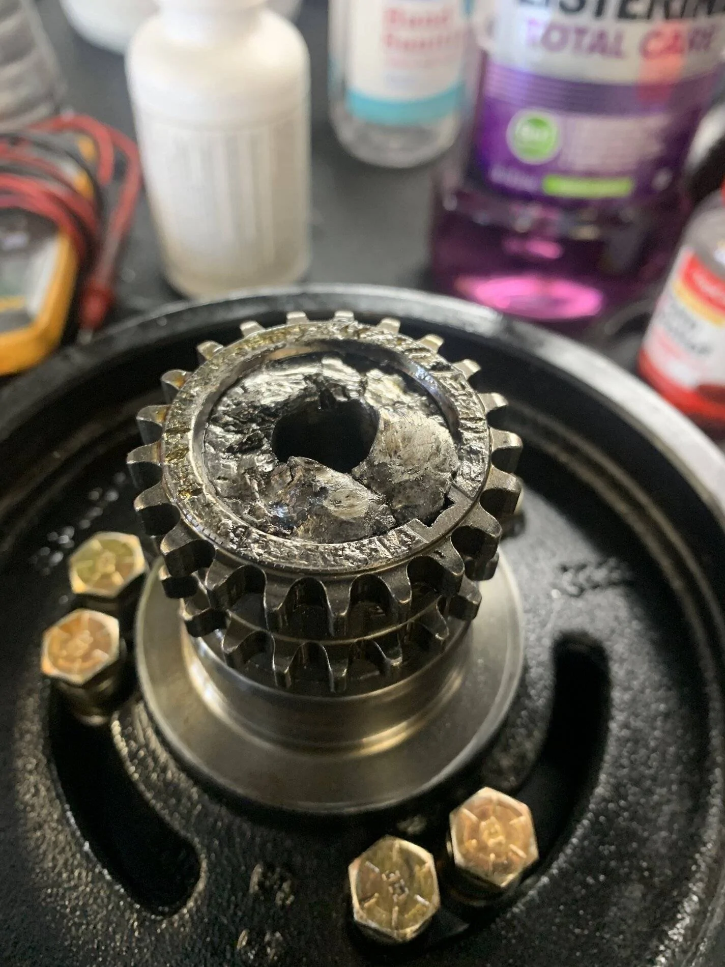

Broke my crank snout yesterday. I was pulling on the freeway, hit in second gear it spun a little, grabbed 3rd gear and then when the car shifted from 3rd to 4th the engine just shut off. I looked in the rear view and saw smoke. I knew it was fucked at that point.
I will say that I am not blaming the procharger at all. If anything it’s my bad for me torquing the balancer bolt with a gun. I love the procharger on this car and when it hits the streets again it will have the procharger on it. I will definitely be adding a crank support this time around. I’m not sure what I’m going to do for motor yet but I will probably make that decision after I get the current motor out. I want to see if the heads are messed up and how bad. I’m assuming the chains were thrown off but I’m not sure.

NOOOOOOOOOOOOOOOOOOOOOOOOOOO!!!!! Sorry man :( You used an impact to put on the damper and torque the bolt? How'd you get it off? Same way?
I have a righteous balancer puller and installler. Once installed I gave it a couple of taps with the gun. I’ve been using the same gun for almost 30 years. I know it pretty well. Never the less torque specs exist for a reason.

Really should not be much more than just the crankshaft and maybe some bent valves. A lot of labor but not to many parts. you can have it back up and running for under $1500 if you can do the work
I may go that route or just a new gen3 short block
Hopefully the heads can be rebuilt. What ever I do It will definitely have the crank support on it.

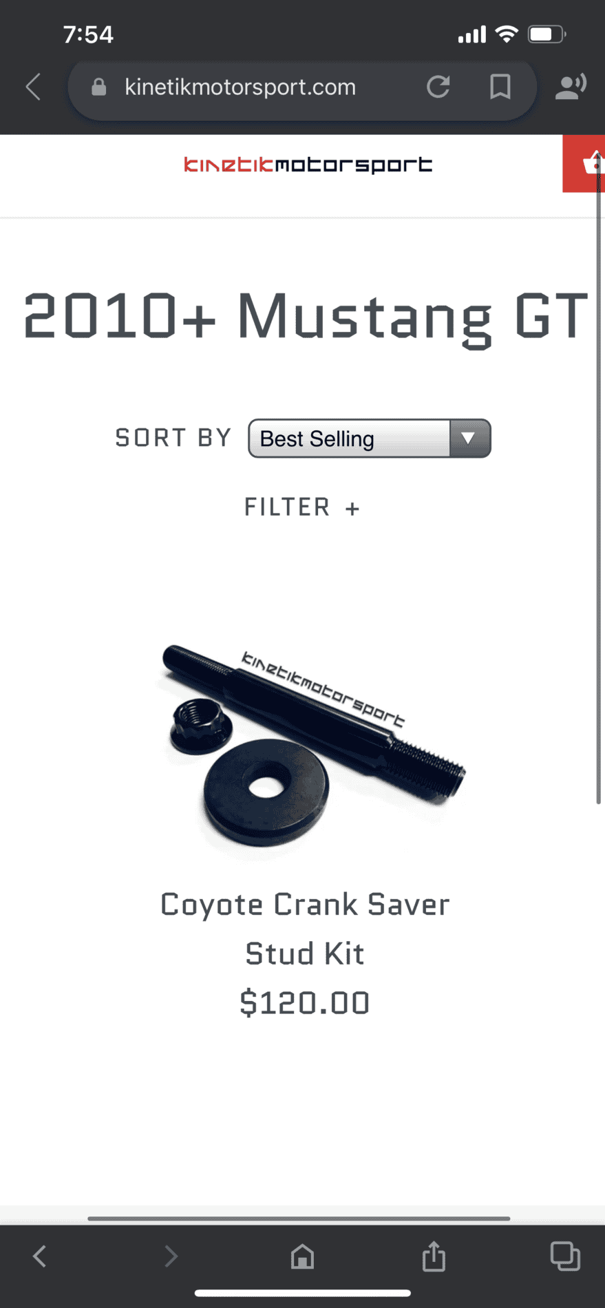

Im running the procharger crank support and the Kentic Crank saver stud… works way better than the ARP bolt
One hundred percent will be getting that too. Anything that might alleviate stress on the crank snout is a must moving forward for me. Aside from that the car ran great. Which is why I’m leaning towards a factory gen3 short block with some head studs, a new oil pump, and probably the cyl head cooling mod
