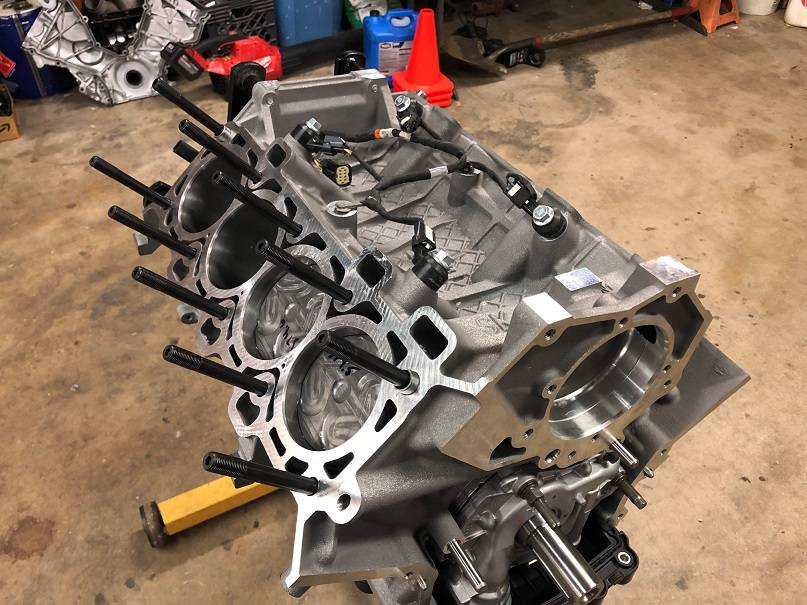

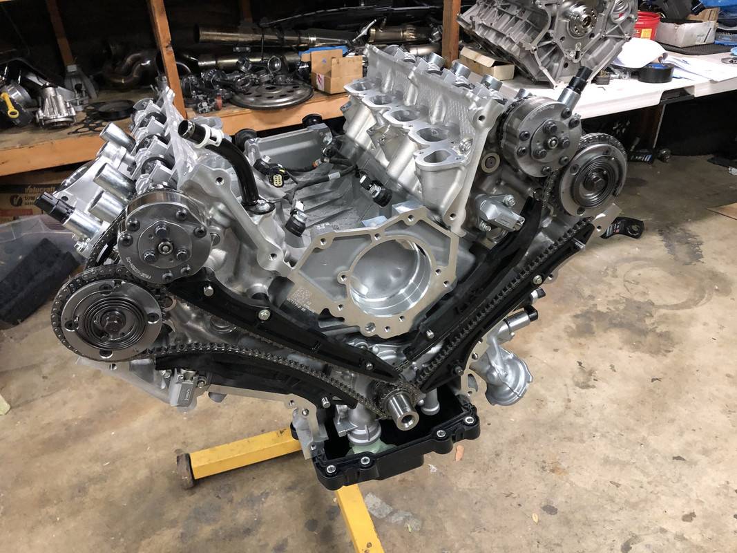

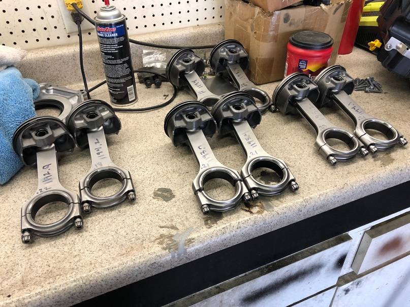

-Forged pistons and rods--$1300 (mahle drop-ins, Manley H tuff)--Got these on Christmas special in 2020, price is about $500 higher these day for piston/rod combo.
-Ford OPG--$400
-MMR crank sprocket--$200
-ARP studs--$300
-King bearings--$300
-New crank--$275
-Gen 3 block--$850
-Balancing/machining--$450
Total= ~$4100
