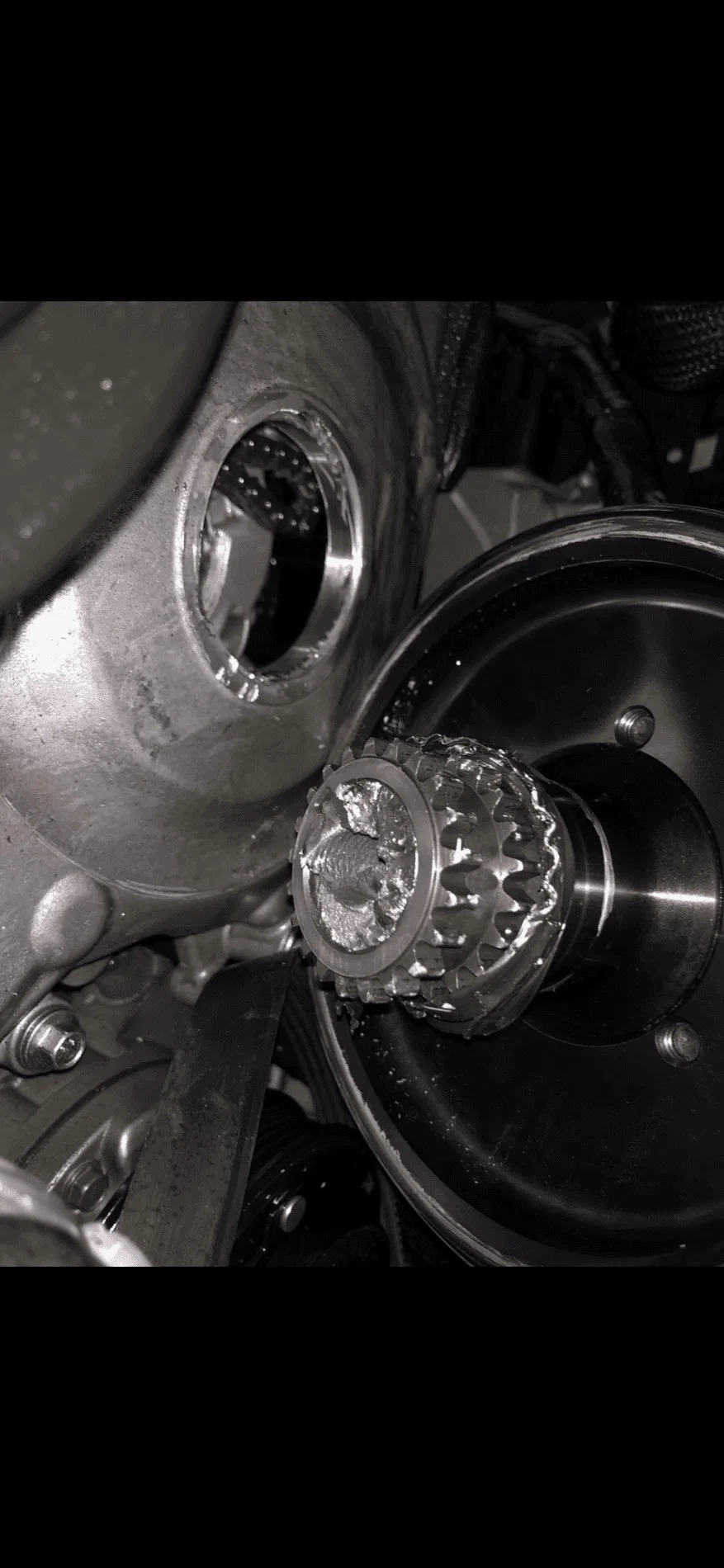

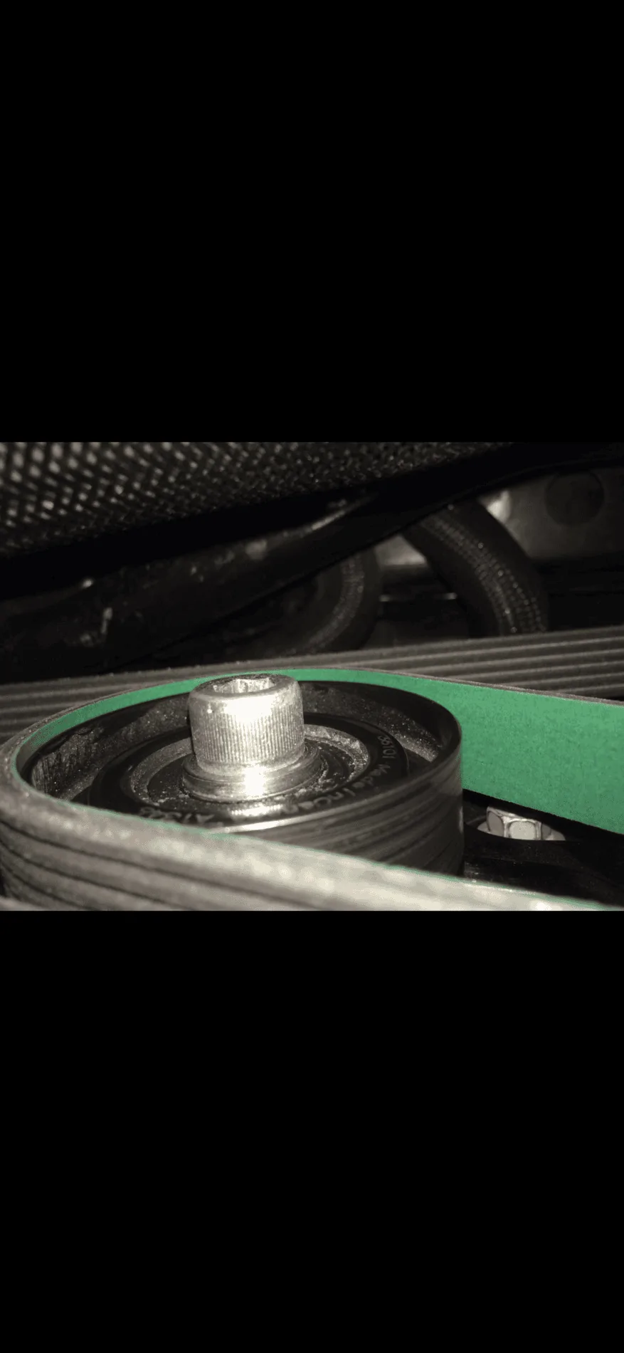

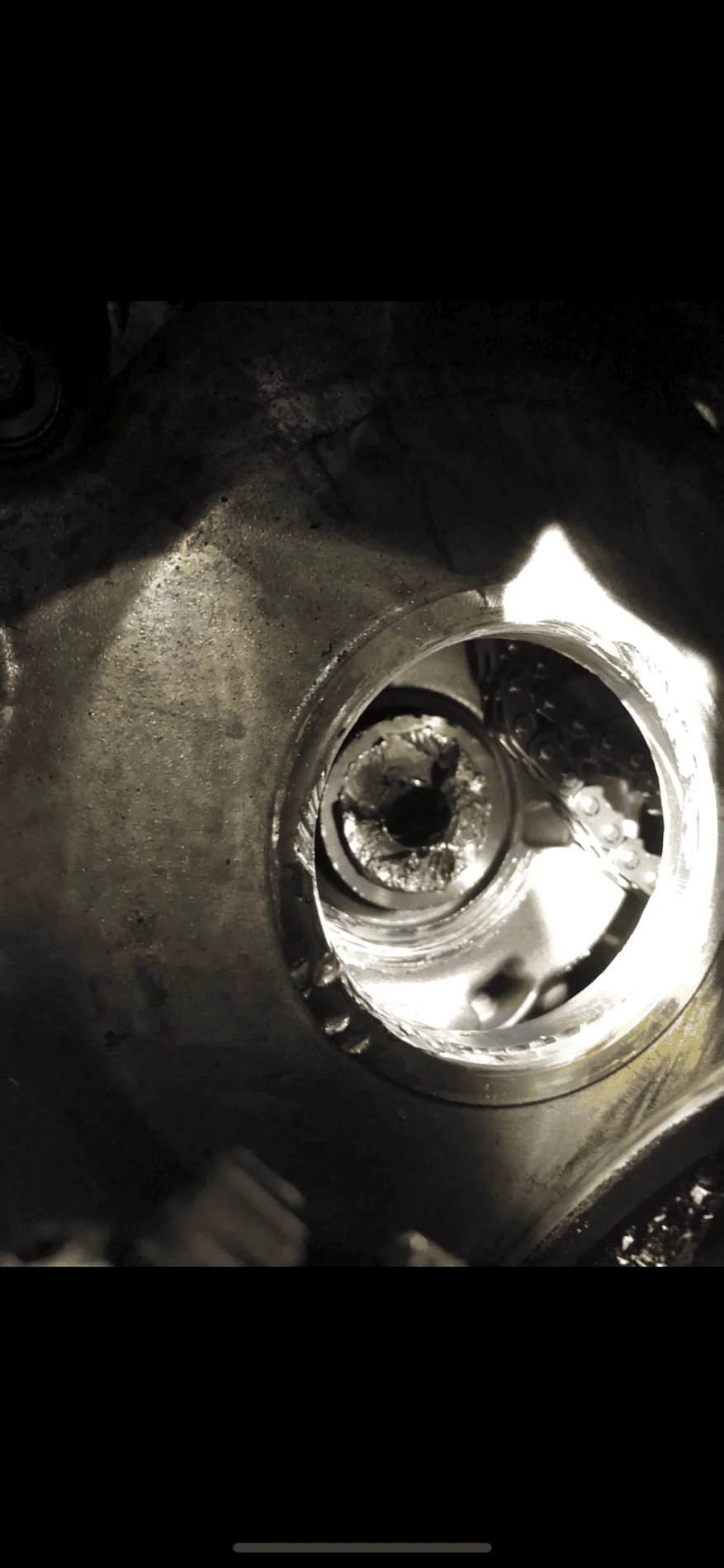

Crankshaft snout snapped
ramirj2
Jul 30, 2014
129
Bayamon PR
2015 GT premium, 2003 350z, 1978 280z
Another one bites the dust!
Whipple Stage 2 , 3.250 6rib ATI
Although torqued to spec from that old picture it seems that it wasn’t properly seated
Didn’t check interference tolerance

Welcome to the unfortunate club sir! Have you decided how you'll be fixing it?
ramirj2
Jul 30, 2014
129
Bayamon PR
Haven’t got the time to take out the heads.
I need to see if I need a short or a long block.
If it is a short block, it would be wise to buy a sleeved one.
Let’s see....

Man that sucks... heads are probably not too happy.. 3.25” pulley... that’s pushing it.
Let’s see....
Hopefully the head castings are okay as I believe they are on national backorder. Check out Sai Li or TKM
