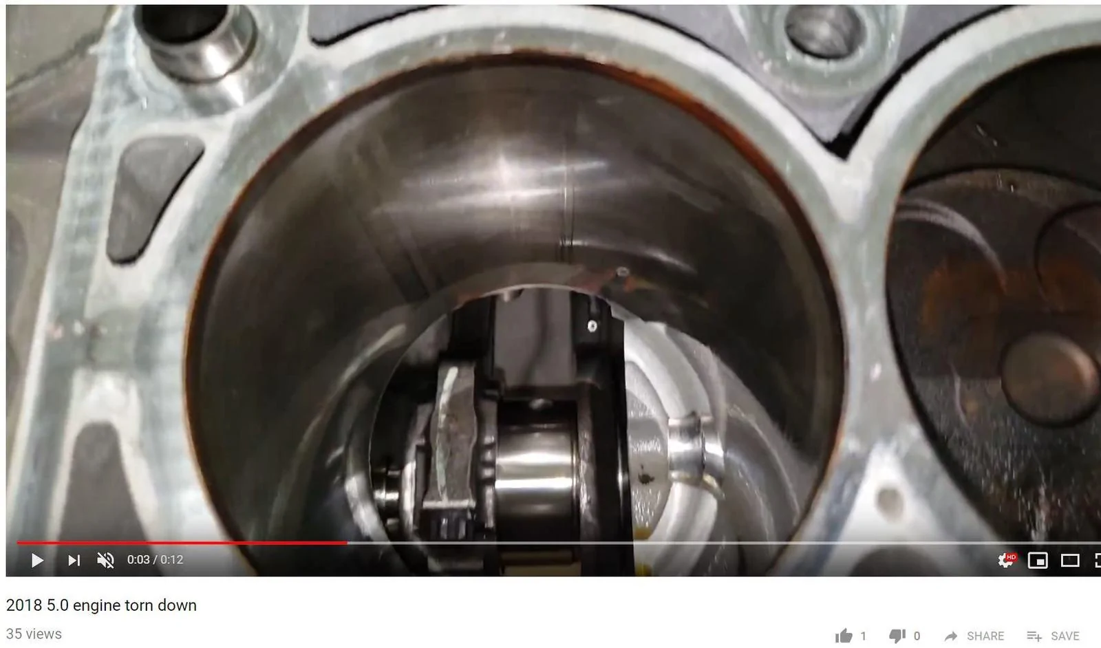

Cylinder of a 2018 that was torn down in shop. Mechanic wasnt there. Looks like some piston slap type scoring imo. Not sure if it would really be a long term problem but I think my car probably has this same issue.
What do you guys think? Other cylinders didnt have those marks.

I think marks like that can cause detonation aka knock
