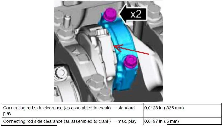

I know it's a different engine but I had a built 3 valve and it had .020 rod side clearance with Manley H beam rods, it never made any ticking sounds. I wonder if the factory connecting rod is amplifying this sound curious to know if an aftermarket rod with the same clearance would make any noise.
The factory manual "standard" spec target is around 0.013" with a max allowed of 0.020". Must be a reason why Ford specified the S550 Coyote to have that rod side clearance.
