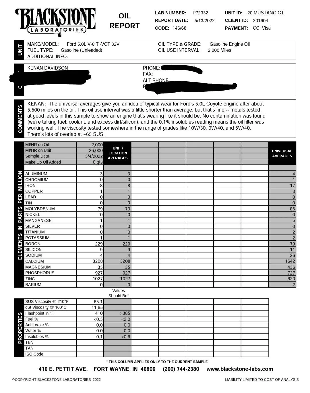

This is my second mustang. The first was a 2016 that developed the tick right after an oil change around 28k miles and ford replaced the short block later on. I lost faith in the car and sold it. A few years later I decided to try again with my 2020 GT. Picked it up with 14k miles and it had a very faint tick not that often. I put on a supercharger and sent it. 8k miles later after an oil change the tick became much more pronounced. So I decided I would change the oil again with something heavier. 5w40. At the next oil change maybe 100 miles later I noticed in the oil drain pan some grit of some kind. They were little pieces maybe 1mmx1mmx1mm. I couldn't make out what it could be. I put a magnet to them and they did not attract. I smashed them down and they broke apart even further. I broke open the oil filter and did not find anything in it. This of course alarmed the shit out of me. I put fresh oil in and thought at the next oil change I'm taking off the oil pan. I also requested an oil test kit from Blackstone. Let me say when it developed the tick I took it to the dyno maybe a week later for a tune revision and it made nearly 900 whp. So I felt pretty safe that there wasn't anything serious going on. But after finding this stuff in the oil pan we'll I was really worried again. I changed the oil 2k miles later and decided against taking the oil pan off because it looked more difficult than it was worth. The results came back today showing nothing out of the ordinary. My guess as to what this material could be is something from engine assembly. I've seen other people find plastic pieces in their oil and it's been concluded these probably came from something do with the cam chains. So anyway that's my story. Car still runs great. Tick shows up every now and then. Liqui moly did nothing. Heavier oil did nothing. I don't know if the pieces I found in the oil are related to the tick becoming more pronounced but its seems like more than a coincidence.
