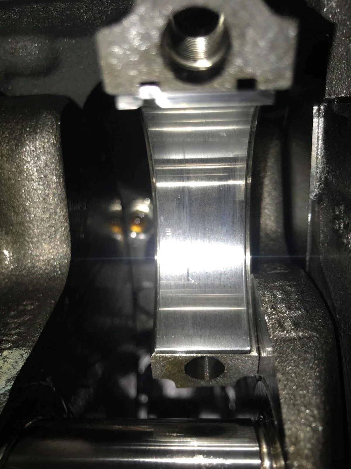

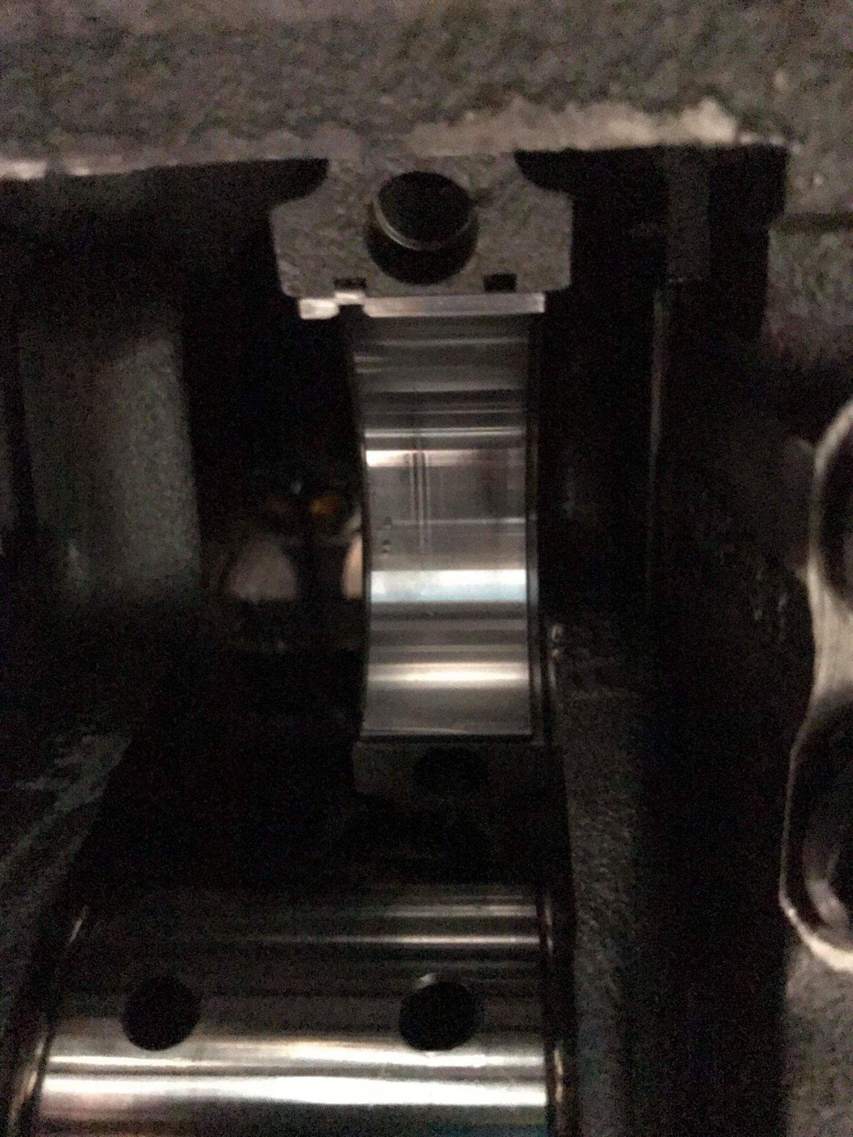

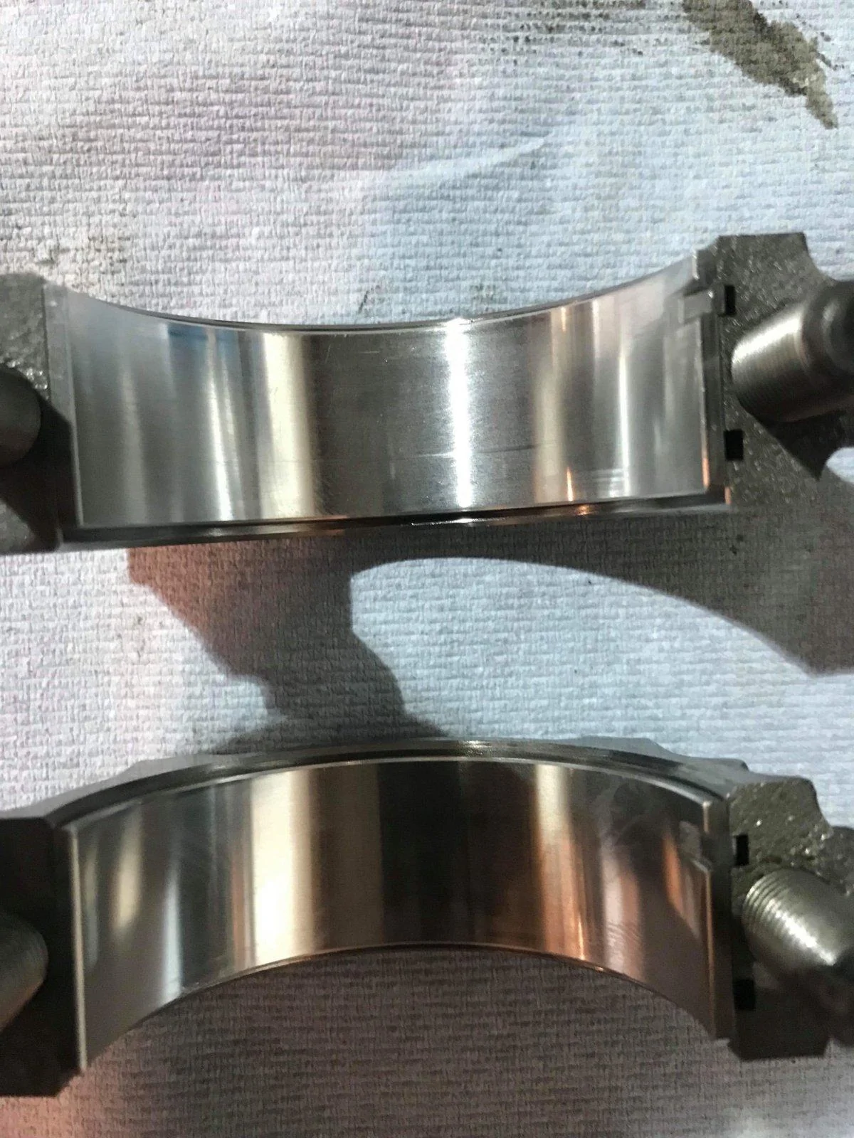

Okay bare with me these were measured in thou's
3 of them were 22 thou and the other near to the fly was a whopping 24 thou (.6096) as opposed to (.5000)
.5mm =19,685 thou, so all were over the max tolerance.
On one of the oil holes had a burr and has scratched the bearing, i will post up a couple of photos later.
spogshd
Oct 17, 2016
239
63
manchester uk
2016 convertible
photos, think you can just make out the burr in the first photo
