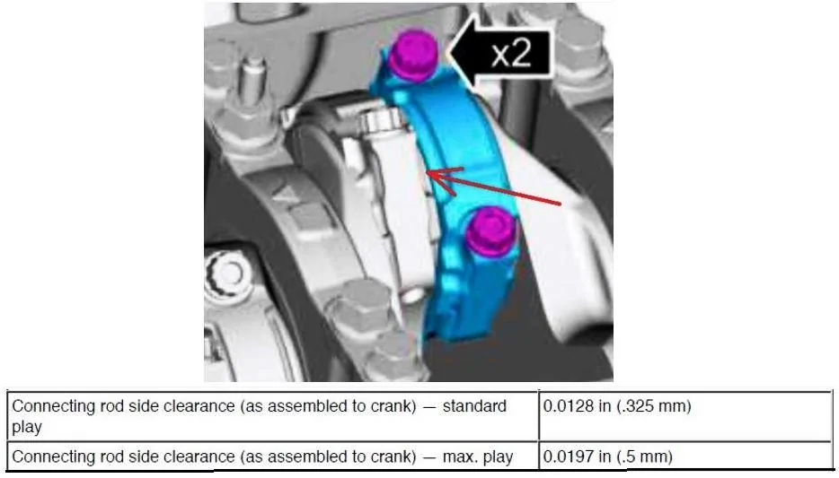

0.150mm to .500mm (.006" to .020") is spec for connecting rod side-clearance. Use some feeler gauges and measure the clearance at 12, 3, 6, and 9 o'clock.
As posted before ... specs out of the S550 service manual.
