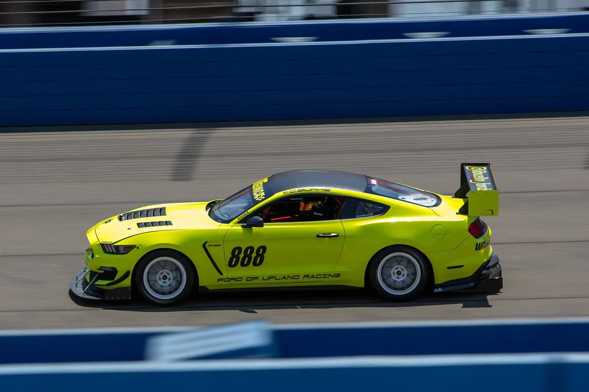

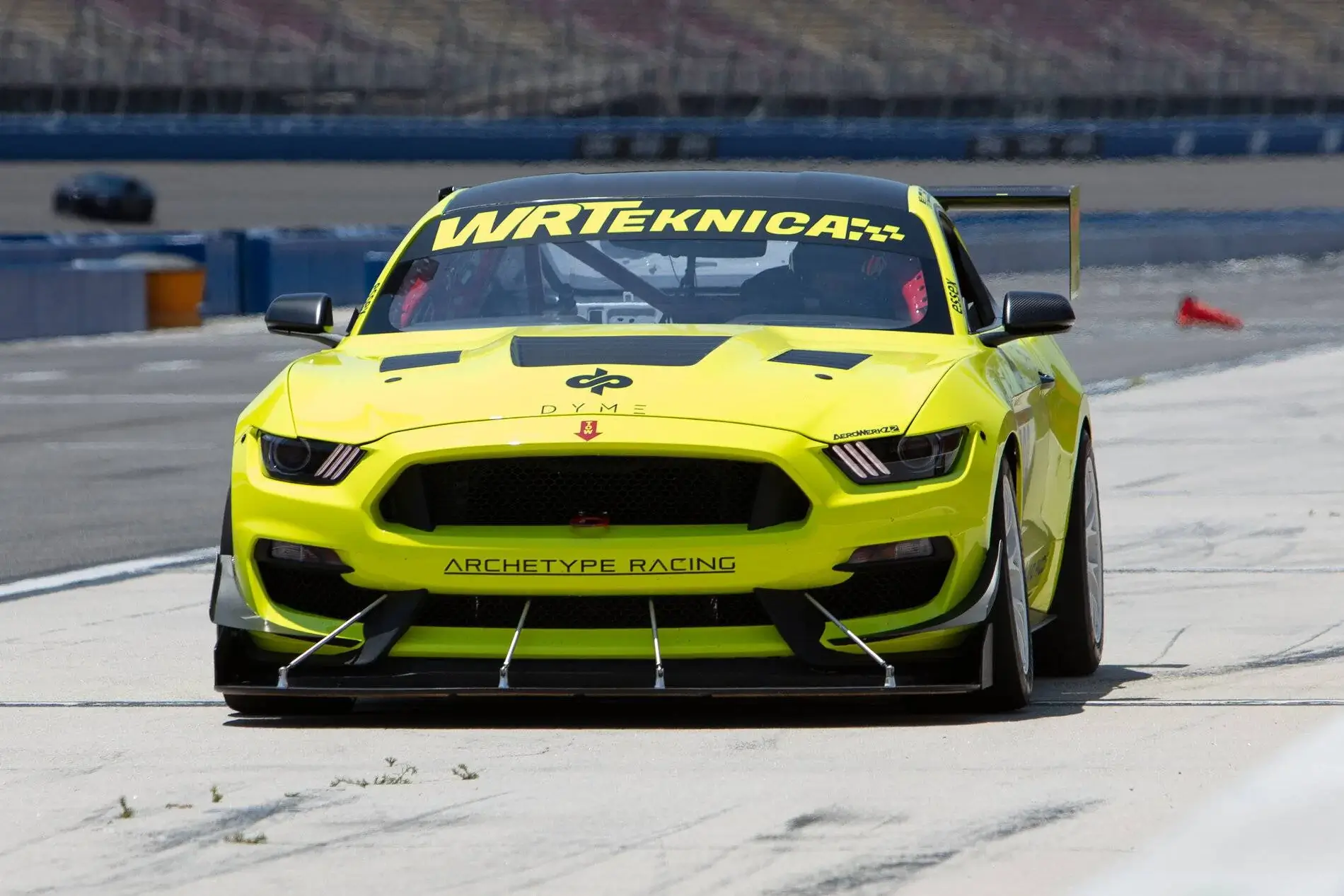

How far are you from Upland CA? reason Im asking is the owner of Upland Ford is pretty active on the Facebook GT350 forums and the crew over there knows GT350s pretty dang well....the owner had a GT350 he does a little racing with .....still has the VooDoo - I think he drives his hard all the time with no issues lol They actually do all their work on 350s at their fleet center if you want to PM me I can provide you with the contact info for who I dealt with .....
While I agree getting it to Christian and team would be a huge upgrade over these guys, I promise you he’ll tell you to CPC swap it 😂
