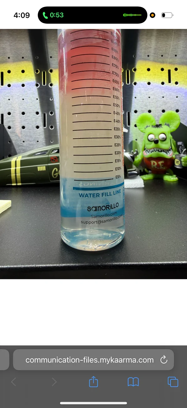

I haven't kept up with all that's happened... but contaminated fuel has to be what you focus on here. Misfires can happen because of bad fuel.

Hello; The more common ways fuel can be contaminated include sitting too long. Ethanol in gasoline will separate after a while. We have no good information on how much fuel you ran thru it after you bought the car. Two easy ways to avoid this is to run the old fuel out or add a fuel stabilizer. There are now fuel stabilizers formulated to help with ethanol in gas.
A third way is to run pure gasoline.
Water can get into the gas. A common way in the past was having too little fuel in the tank. Water would condense inside the tank during cool nights. A solution is to keep the tank over 3/4 most of the time. A WAG is the seller may have added something to the fuel. Maybe a stabilizer and it was just left too long.
Contaminated fuel can cause misfire and other poor running. a suggestion if the engine dos does not have to be replaced. Go for a long drive say once a month. Say a couple hundred miles if practical. Maybe a 50-to-100-mile trip every week. The idea is to drive it regularly.
For sure have the old fuel drained and get fresh in the tank.

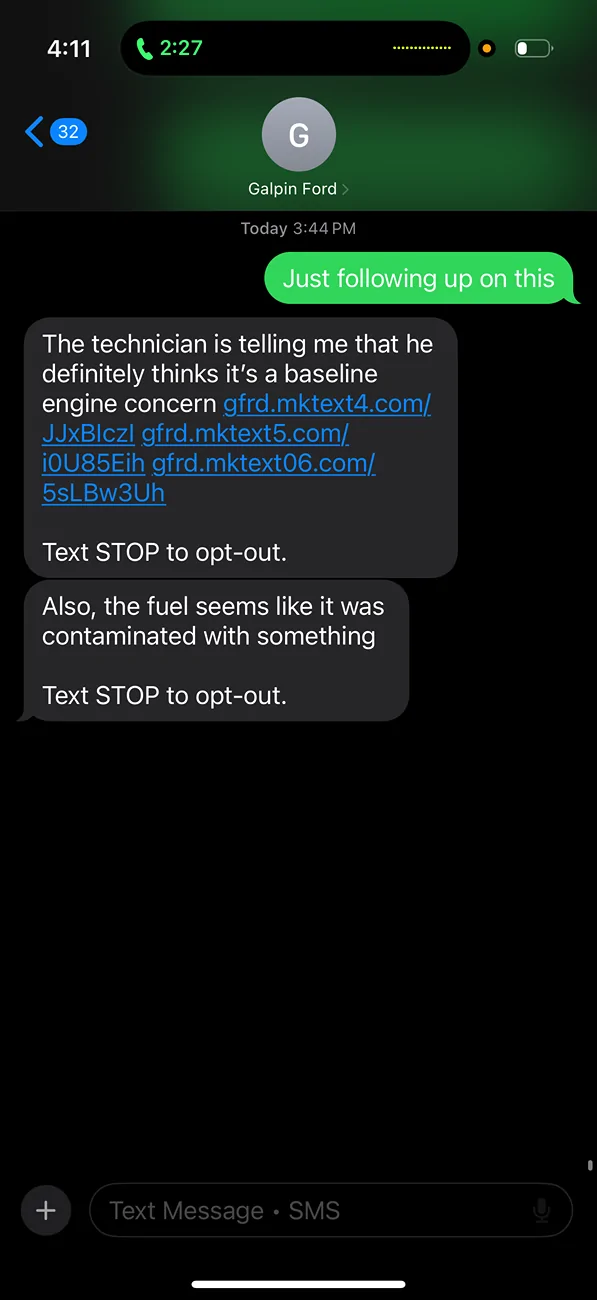

Your comment that the technician calls it a baseline engine concern is not helpful.

Good lord. this dealership is less than useful. "here's a vague statement with a bunch of pictures meant to intimidate you into believing me." Barely 1 step above trust me bro.
I'd pull my car out of there. Its clear they dont want your business unless it involves an engine replacement

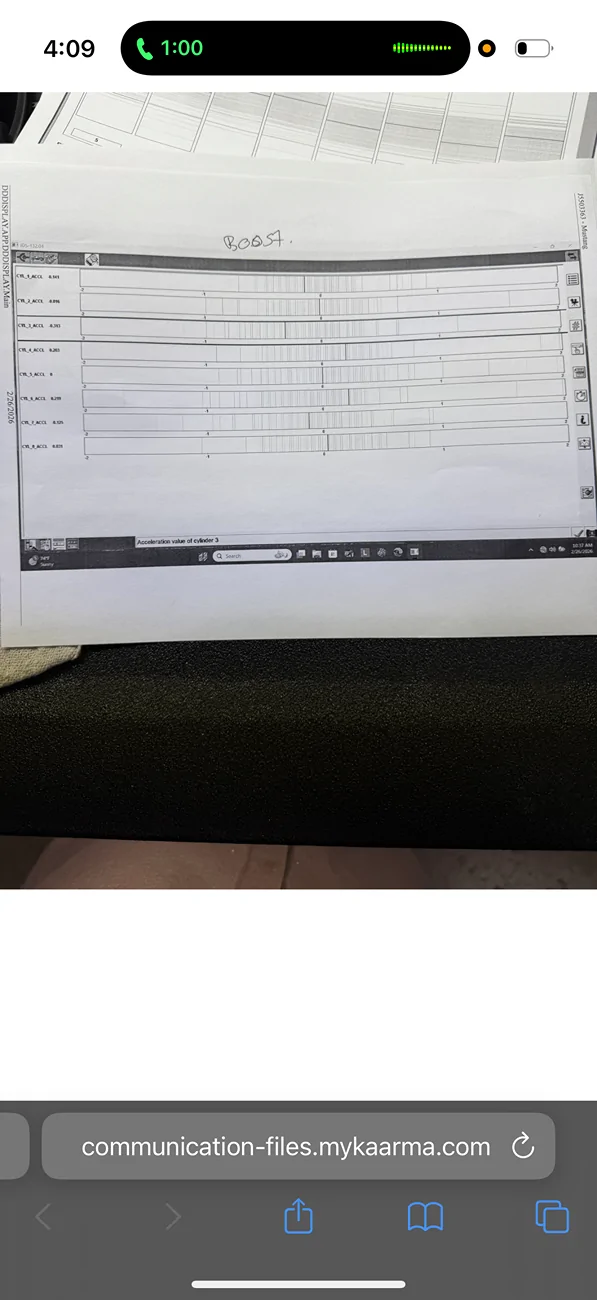

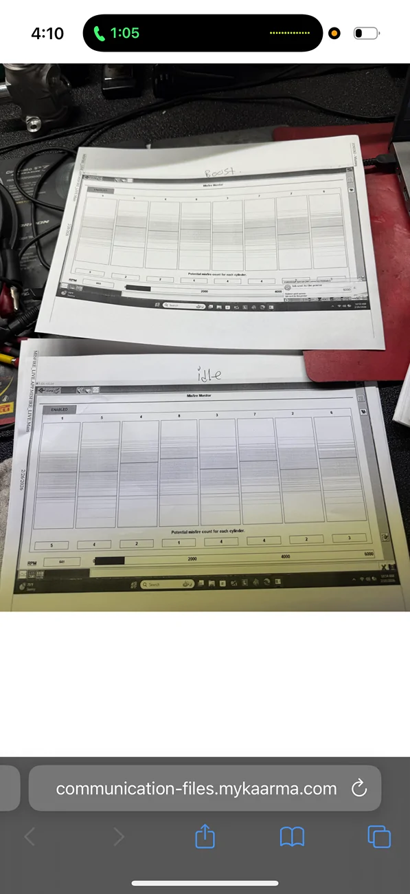

An update on the situation.
*Attached the dealership diagnostic.
As many suggested, I pulled the car out from Galpin Ford.
I took the car to Upland ford and they suggested I do a crank relearn - this unfortunately did not solve the issue. Drove the car mildly hard and all was fine. However, once under heavy load, 2nd gear WOT uphill, the check engine light flashed again.
I ordered a coil which is still on its way and ordered 8 spark plugs.
Upland ford thinks the next steps should be checking the wiring / inspecting coils.
I know others have commented that the scoring on my cylinders look mild / nothing of concern - not trying to be argumentative here. But just feeling conflicted from multiple other mechanics saying the scoring looks fairly deep and they thought it was cause for concern. Not a concern in the sense of that is what is causing the misfire / saying the engine will blow up tomorrow. But saying scoring will likely worsen and lead to engine failure.

Sounds like you’re doing the right things. I don’t think the code is from the scoring, but I’d keep an eye on the scoring issue, can’t be great. I saw your other thread too, and on Reddit. I mean, I’d take it with a grain of salt it’s mostly 350 owners telling you it’s no worries. They will defend that motor to death, and turn a blind eye to the obvious, even with its well documented reliability issues.
