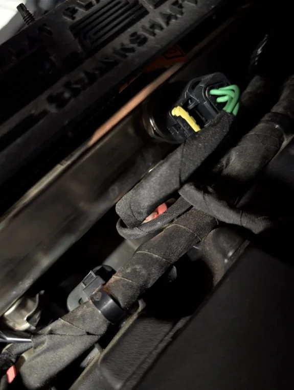

When are you expecting to have your replacement coil?
If the coil does not fix the issue then I'm going to go back to my comments in your other thread.
I've had the P0300 multiple misfire code and various individual cylinder misfire codes with it. It only showed up at higher RPM until the break in the connection was significant enough that it started showing up at lower RPM.
Attached is a picture of the fuel rail pressure sensor. It is located on the drivers side of the engine. Log and watch the fuel pressure in real time and manipulate the wires along that harness to see if you lose pressure. Check that harness carefully and check the harness going to each of the fuel injectors.
