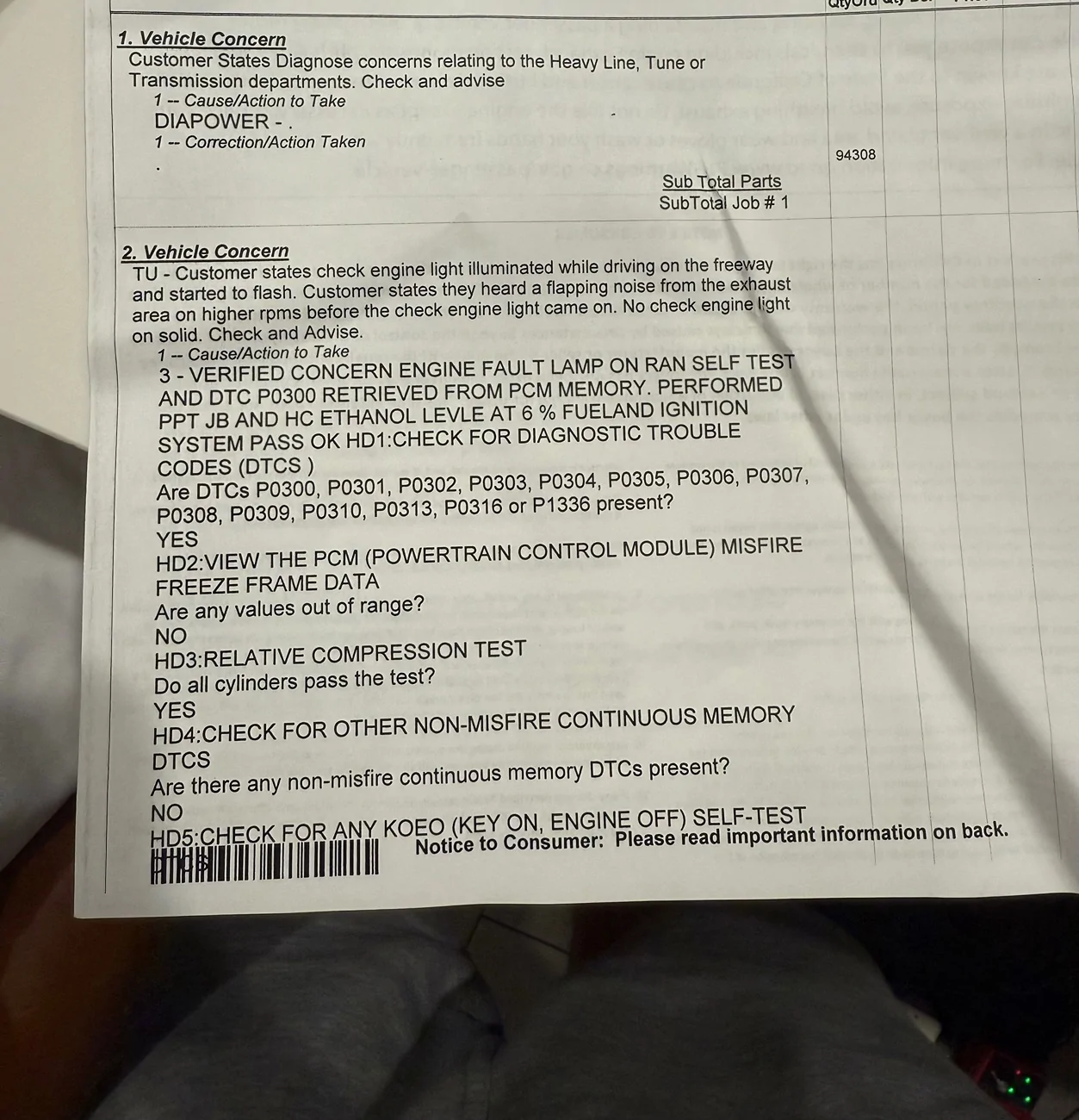

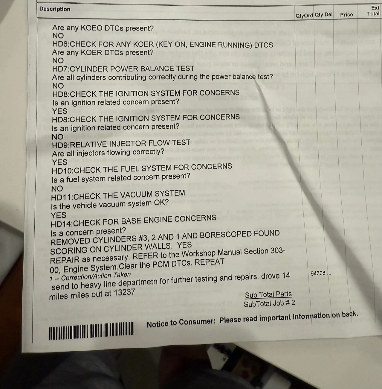

An update on the situation.
*Attached the dealership diagnostic.
As many suggested, I pulled the car out from Galpin Ford.
I took the car to Upland ford and they suggested I do a crank relearn - this unfortunately did not solve the issue. Drove the car mildly hard and all was fine. However, once under heavy load, 2nd gear WOT uphill, the check engine light flashed again.
I ordered a coil which is still on its way and ordered 8 spark plugs.
Upland ford thinks the next steps should be checking the wiring / inspecting coils.
I know others have commented that the scoring on my cylinders look mild / nothing of concern - not trying to be argumentative here. But just feeling conflicted from multiple other mechanics saying the scoring looks fairly deep and they thought it was cause for concern. Not a concern in the sense of that is what is causing the misfire / saying the engine will blow up tomorrow. But saying scoring will likely worsen and lead to engine failure.
Is this report from gallon or Upland? If the 2nd dealership confirms scoring I do not understand why you are not pursuing a warranty claim?
Hello; First- Scoring at any level is not good. Had you posted the images of the scoring before purchase I and likely many others would have advised you to not buy the car. But it is now your car, so the question becomes do you try to live with the scoring or spend big bucks to replace the engine.
Some key bits of information are not yet known by me. A main bit would be a compression test of all the cylinders. If you have presented such then I missed it. A compression test might give a clue about the severity of the scoring. Low compression in a scored cylinder can mean too much blowby air getting past the scratches.
NOTE- Low compression can be caused by other things such as a bad valve seat. Such is why another thread follower asked you for images of the valves & top of the pistons.
NOTE #2- Problem diagnosis is conflicting for all of us often. The sure way to know the seriousness of the scoring is to start tearing down the engine. That is difficult work if you cn do it yourself or very expensive if you hire it done.
SECOND - The scoring is a real problem. The scoring will likely get worse. Eventually could become bad enough to be a major problem. Yes, light scoring can be lived with. Maybe lived with for a very long time.
You may wind up carrying a few quarts of engine oil around all the time. Even now I suggest a routine of checking the oil level before every cold start. If possible park in the same spot and check the oil when the engine is cold.
I cannot tell from the pictures for sure about the scoring. As another mentioned a way to check is to see if the scoring catches a fingernail. You cannot get a finger to it without a tear down at least to head removal level.
My guess, a guess I do not have confidence in, is the scoring looks light. Why? because of the visible crosshatching.
THIRD - The scoring will allow some blowby. Especially at high RPM's and heavy engine loads.
Last- Not clear how far with non-tear down testing you are willing to go to. If the scoring is on your mind, I still suggest a compression test, a leak down test and getting images of the valves in the heads & images of the tops of the pistons. An oil analysis could prove valuable within the realm of considering an engine replacement
