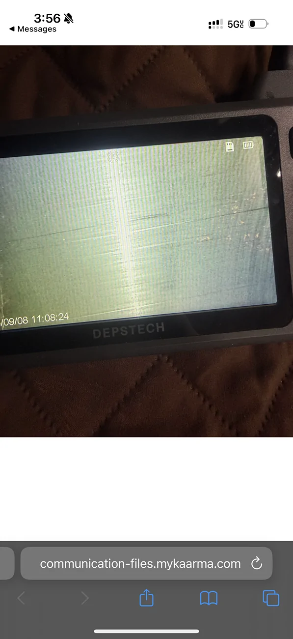

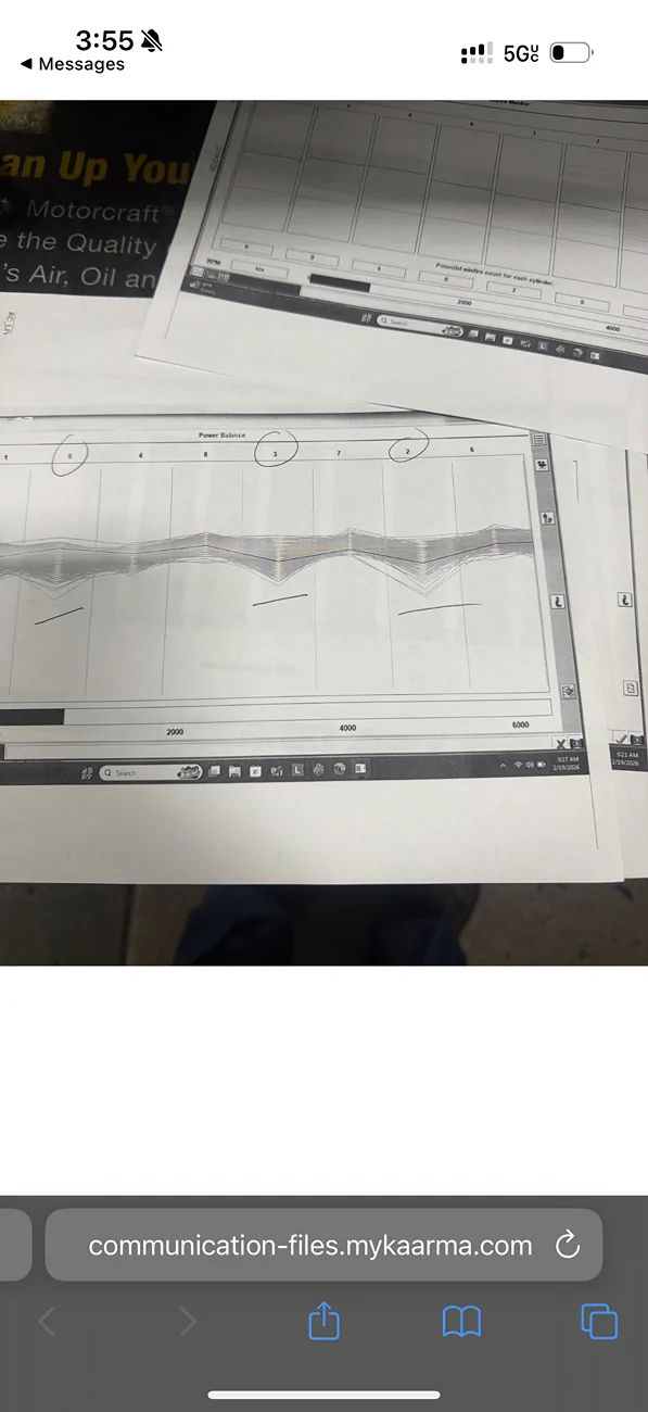

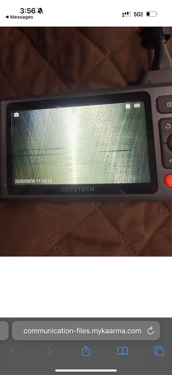

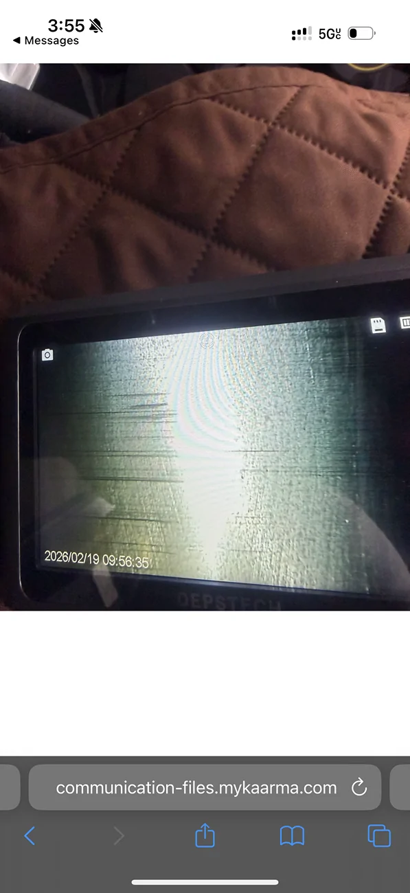

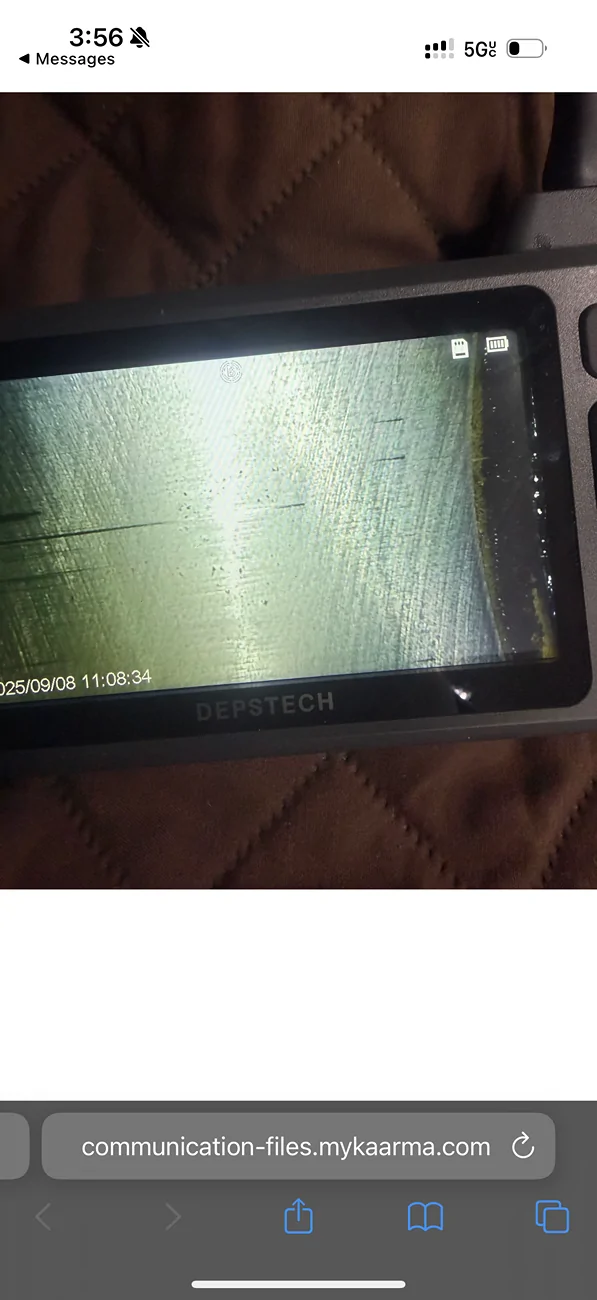

Ford is still running through their diagnostic. I went in person today to grab something from my car. It was just sitting in the lot and not on a lift.
The tech showed me a picture on his phone and said our initial read is that the engine will need to be replaced. There are multiple cracked cylinders. I asked him to send the photos but he has not.
I guess it's possible he heard me say I just bought the car and assumed I have warranty and wants to make some money. But it is a reputable ford shop so I doubt he's being dishonest.

Hello; Likely the word "cracked" should have been "scratched" or "scored". From the pictures looks like something scratched a groove into the metal of the cylinder walls.
On many GT-350 V8's the cylinders were lined with a very thin lining. That means the engine cylinders cannot be bored out to clean up scratches.
Fair chance something or many somethings have been circulating thru the engine. I am a bit anal about a new to me used car and would have changed the oil and filter right away. If the oil has not been changed have the shop pull the oil filter for a look see. Maybe have the oil drained into a clean container and look for shiny metal in the oil. Gold or copper color indicates bearing material. if the stuff is picked up with a magnet, then indicates a ferrous metal.
Too bad for your new-to-you car if any of these things are true. Of course, many other possibilities.
I do not know what others have done when a GT-350 engine has gone bad. A replacement will be expensive.
