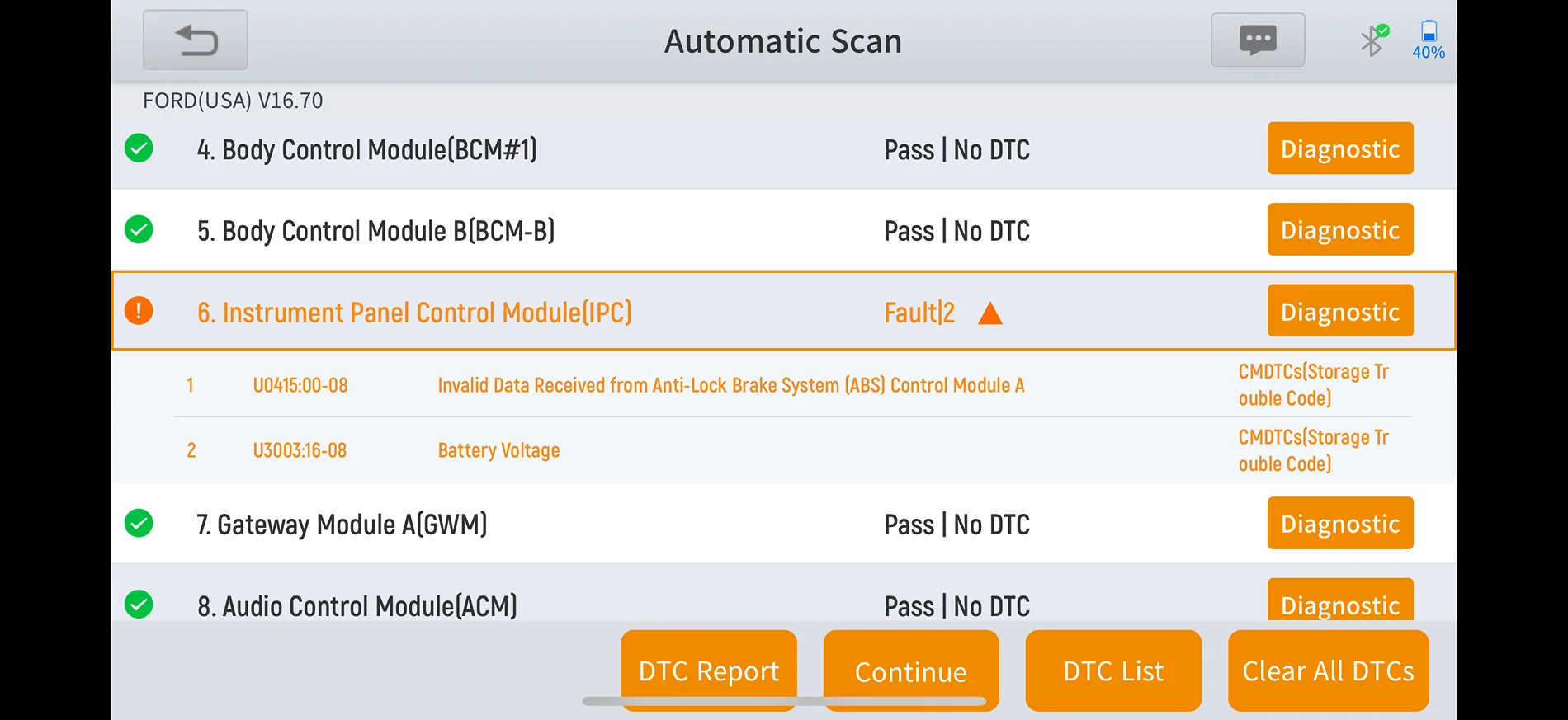

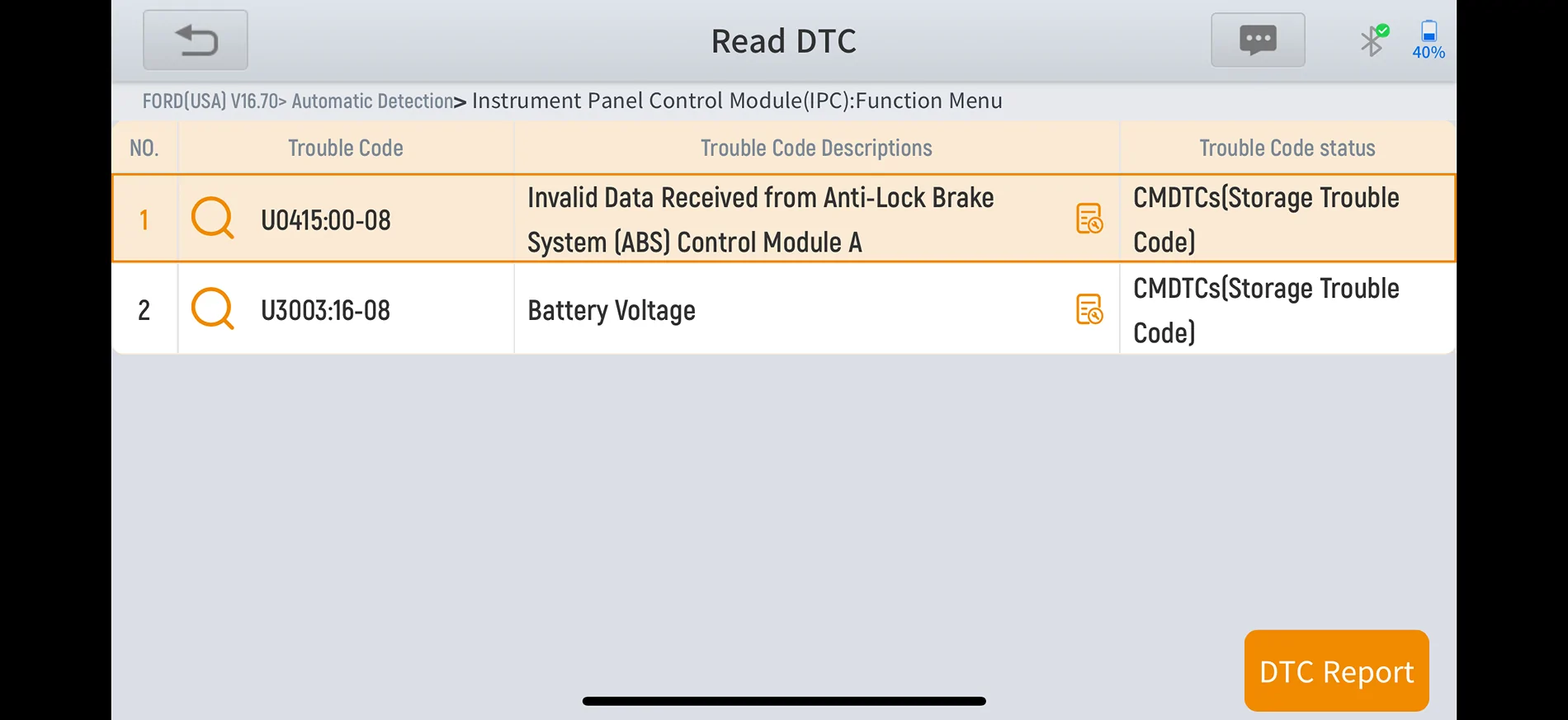

Just bought a Bluetooth obd2 scanner. It had two codes. The P0300 random misfire and this code.
I just cleared both codes. So I know drive the car and click the data recording button?

I know im late to the party and kind of beating a dead horse but id personally change the bad coil with a ford oem coil and do the same to all the spark plugs, you also had a code for the battery if it looks like the original id swap that out ive read people on here that also have 350's saying they get temperamental if the battery is going bad. best of luck
