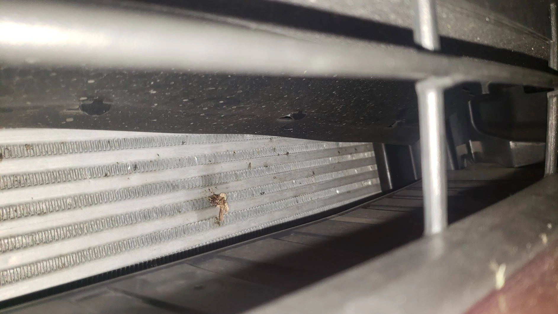

before i dive in and take the bumper off, is this black piece hanging down on the top side of the lower grill standard across all cars? is it something to take off when doing aftermarket intercooler? also i believe there is a piece of soft foam ontop of the underbelly tray / below the interocoler.

My '18 PP1 had that flap - actually had that flap covering about half the IC... one of the little clippy things was missing or never installed and it was probably blocking a lot of airflow. I either buttoned it up or got rid of it when I did the ATM install last year. I think non PP cars had shutters in the grill, but the PP cars don't have the shutters.

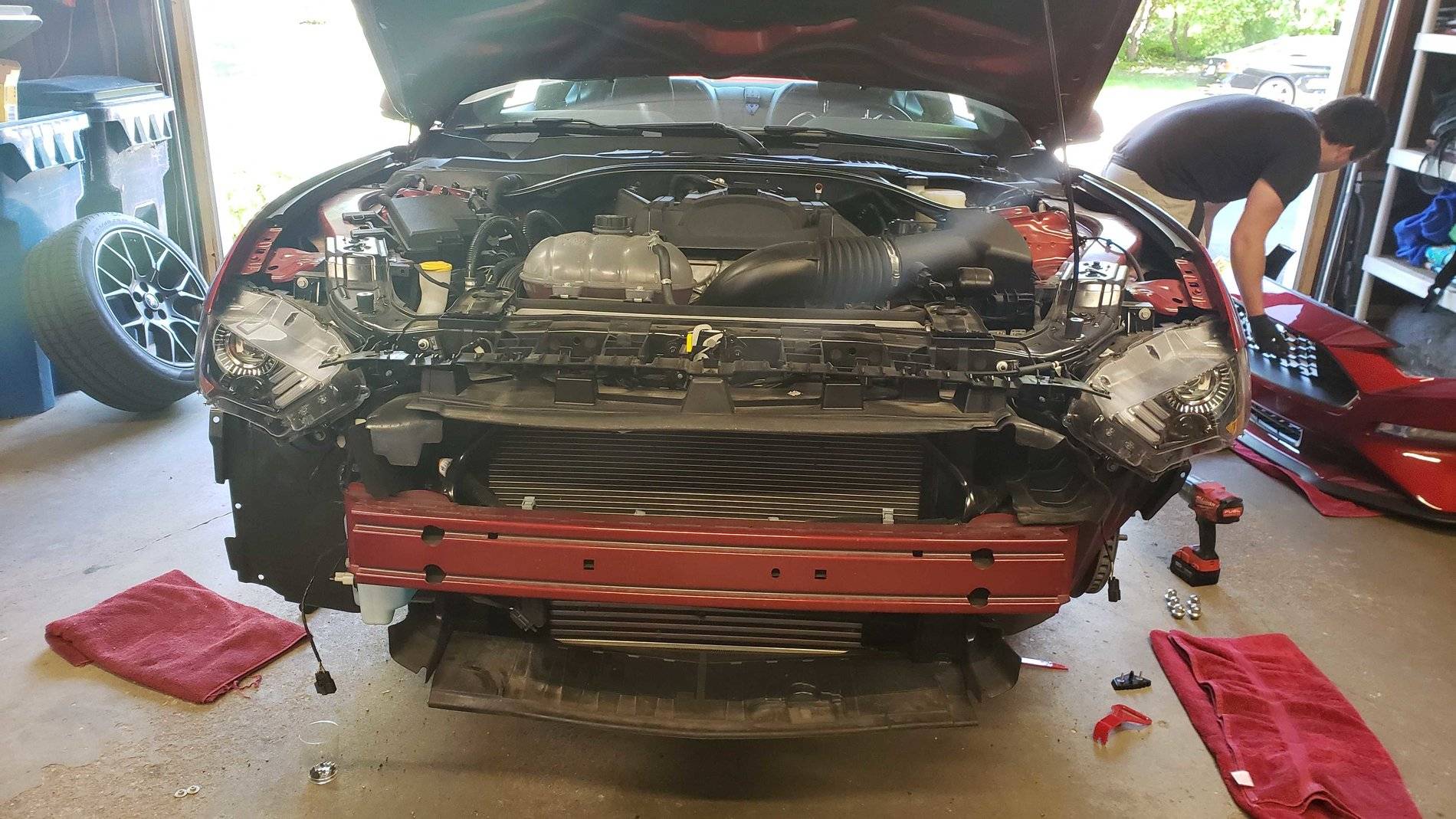

got my cvfab street intercooler installed today.

I installed a Mishimoto intercooler in my 2020 Mustang Ecoboost HPP. I decided to try to do the installation without removing the bumper cover. I removed the stock intercooler without any problems but could not get the new one in by myself because of the cover being a little too close. I removed the cover, which only took a few minutes, and installed the intercooler with no problem. This car has 2 bolts and 1 push-pin on each side to connect the cover to the fender so there are no clips to worry about breaking.
The Ford manual calls for the inlet and outlet clamps to be torqued to 48 lb in but it felt like it might strip at over 30 lb in. I check the other same size clamps and they were at 26-28 lb in. I used 2 different torque wrenches to confirm the wrench accuracy. I may replace them with T-Bolt clamps.
I compared data logs before and after. Not a real good comparison because the ambient temperature was 3 degrees cooler with the stock intercooler and I ran it a little bit harder.
The difference in the max IAT2-IAT went from 58 to 22.
With the stock IC the max ITA2 was 149
With the new IC the max ITA2 was 118
