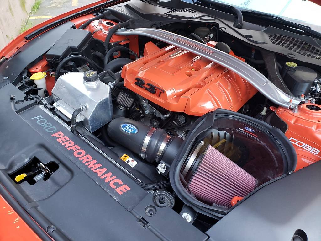

Have an arm filter and Airaid tube. Loving it. Decided that the stick box was just as good as anything else on the market.

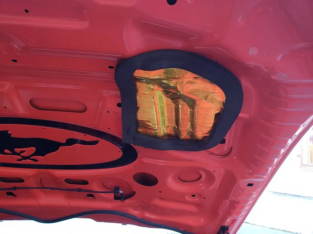

I got a steal of a deal on a FP gt350 airbox thanks to @Radiation Joe, so, due to boredom, made it fit.
not a direct drop in, had to trim some pieces to make it fit the Air Raid tube and the cpe charge pipes.
initially made a hood seal, and then made a.plexiglass cover which are both seen in the pic.

See my last post?
Don't do that, the intake temperatures are nuts even with the seal and Plexiglas cover.

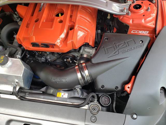

say hello to my new friend, Mr. Injen.....

That Injen is a very nice looking system. How do you like it? Comparisons vs. stock airbox and Airaid tube?

So far so good, a nice sounding system, get lots of intake whistle.
much lower intake temperatures and recovers very quickly after idling.
Not sure if there is any difference between the stock box and air raid tube. Probably not.......

Absolutely no decrease in performance. I'd say even.

So far so good.
There is a noticeable increase in intake sound compared to the factory/airaid setup.
I replaced the resonator with a y pipe at the same time, so more exhaust whistle as well.
Intake temps are also equivalent.
I can't really say there is.a power increase.
I did a datalog and sent it to my tuner (tune+), and he said no revisions were required.
Looks very good under the hood.
