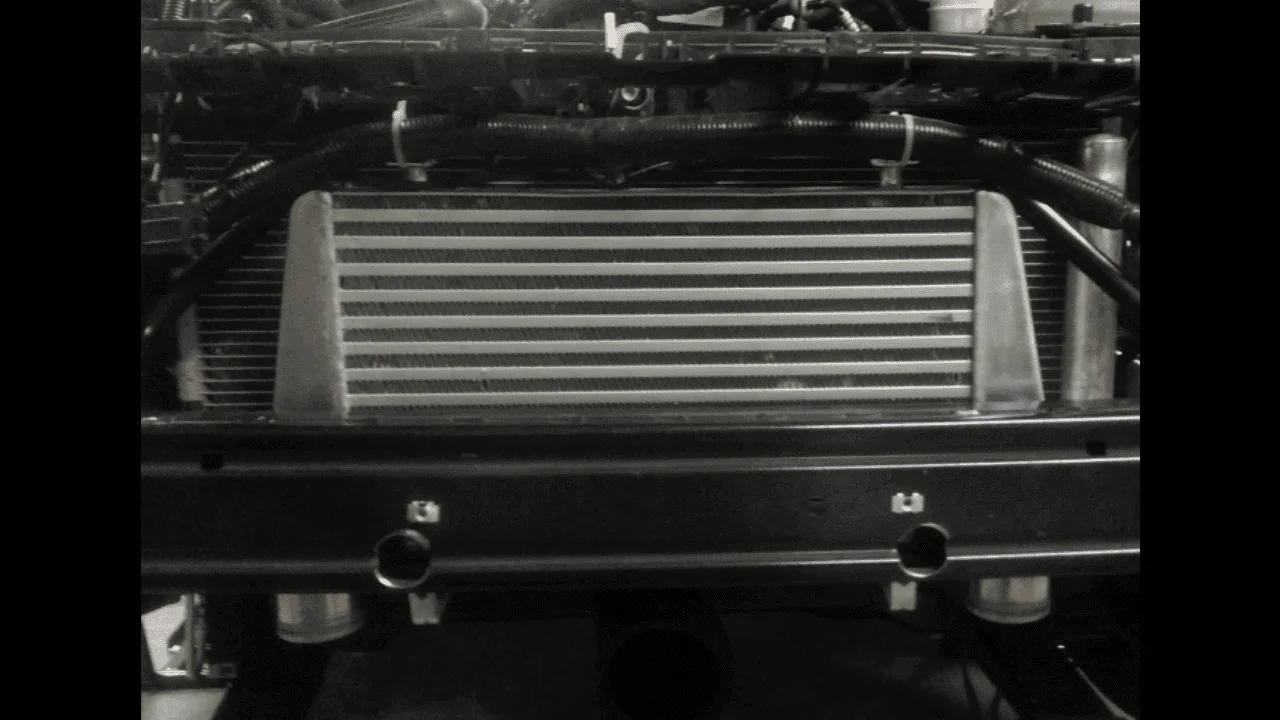

I know this mod isn't for everyone... But, "I like to build stuff!" One of my off season projects is replacing and relocating my intercooler to the upper grill opening of my 2018 EB Mustang.
This leaves the lower grill opening for a 4" Intake Air System!

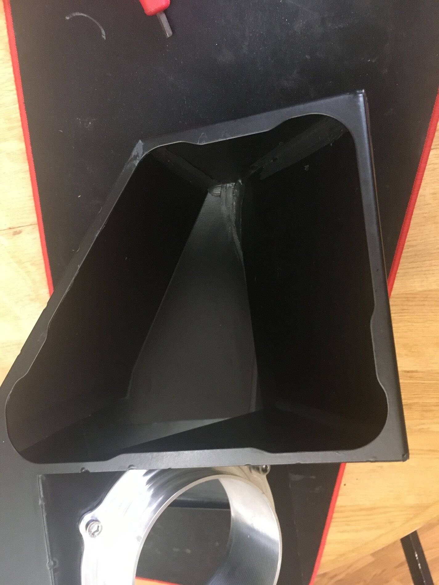

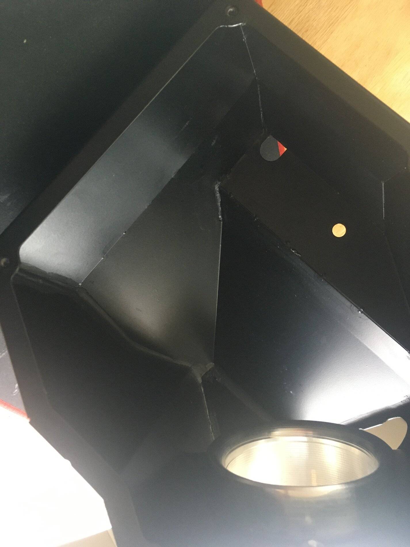

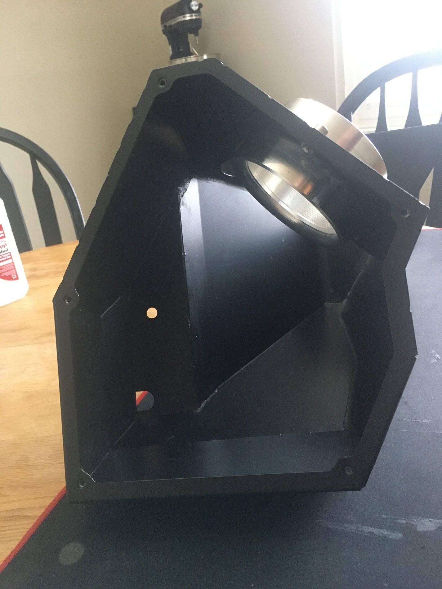

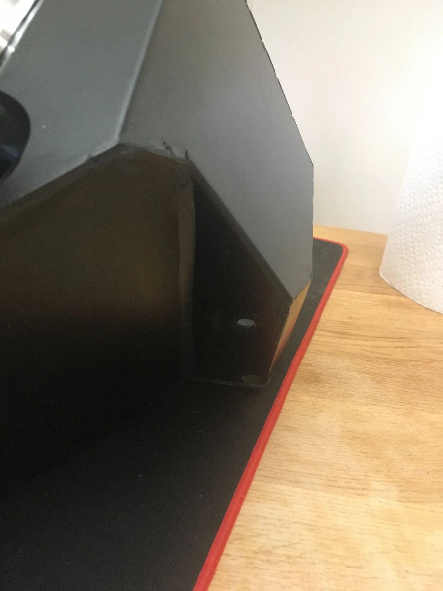

All done. I filled every weld line, once it’s on you shouldn’t see anything exposed. On bottom etc I didn’t care no one would see it.
Looking good!
weird they didnt fill the joints. Having a metal airbox will retain heat more. If you like DIY stuff you could pick up some inconel sheets to insulate the box. Wouldn't be too bad because of all the flat sheet metal pieces

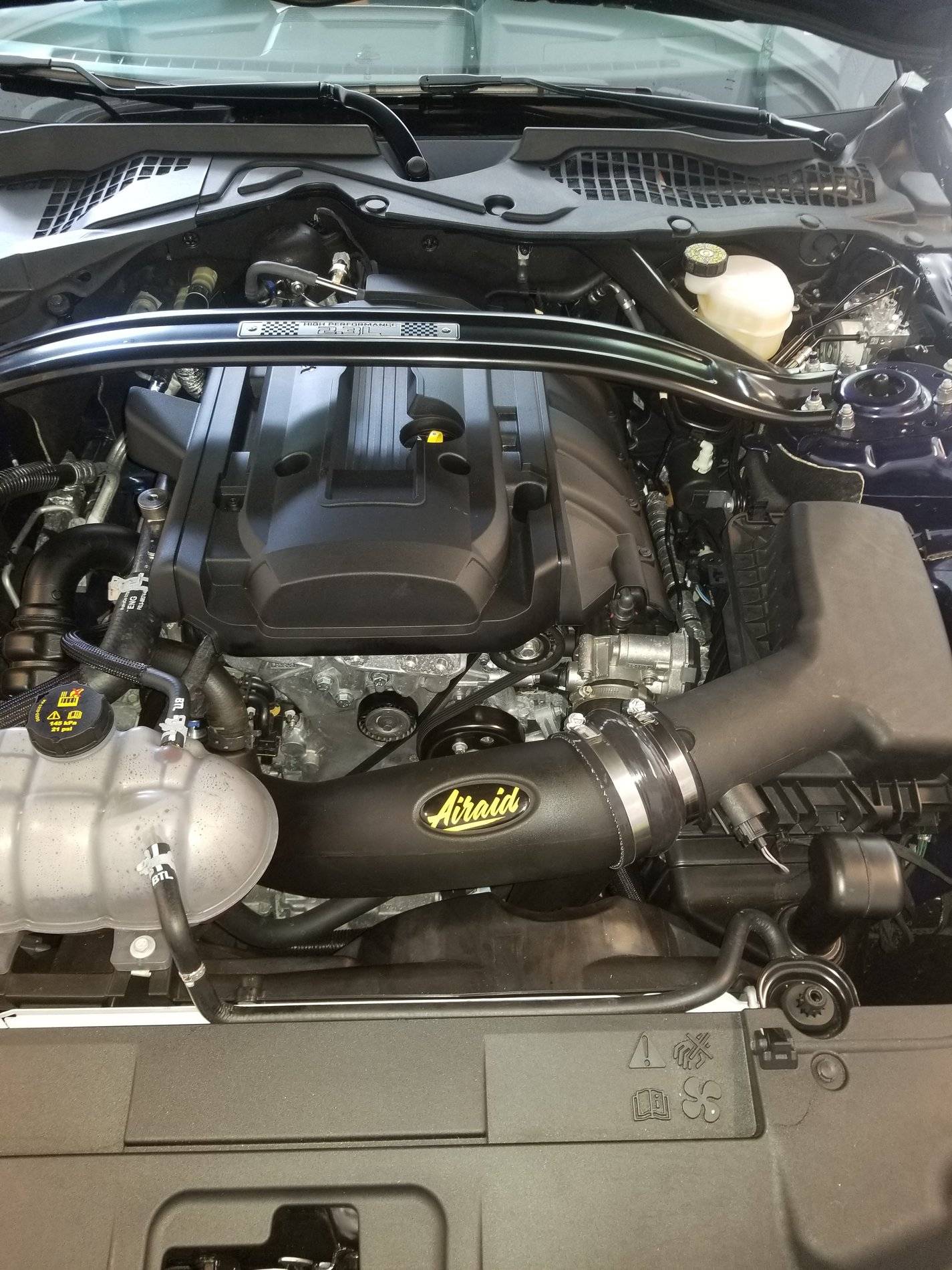

Will install the Airaid tune on my HPP shortly with cleared ECU history see how it is in conjunction with Garrett IC knowing I'm prepped for a Tune if desired when warranty out.
S550HPP
Jun 6, 2024
1,954
1,026
PDC
2022 HPP Vert

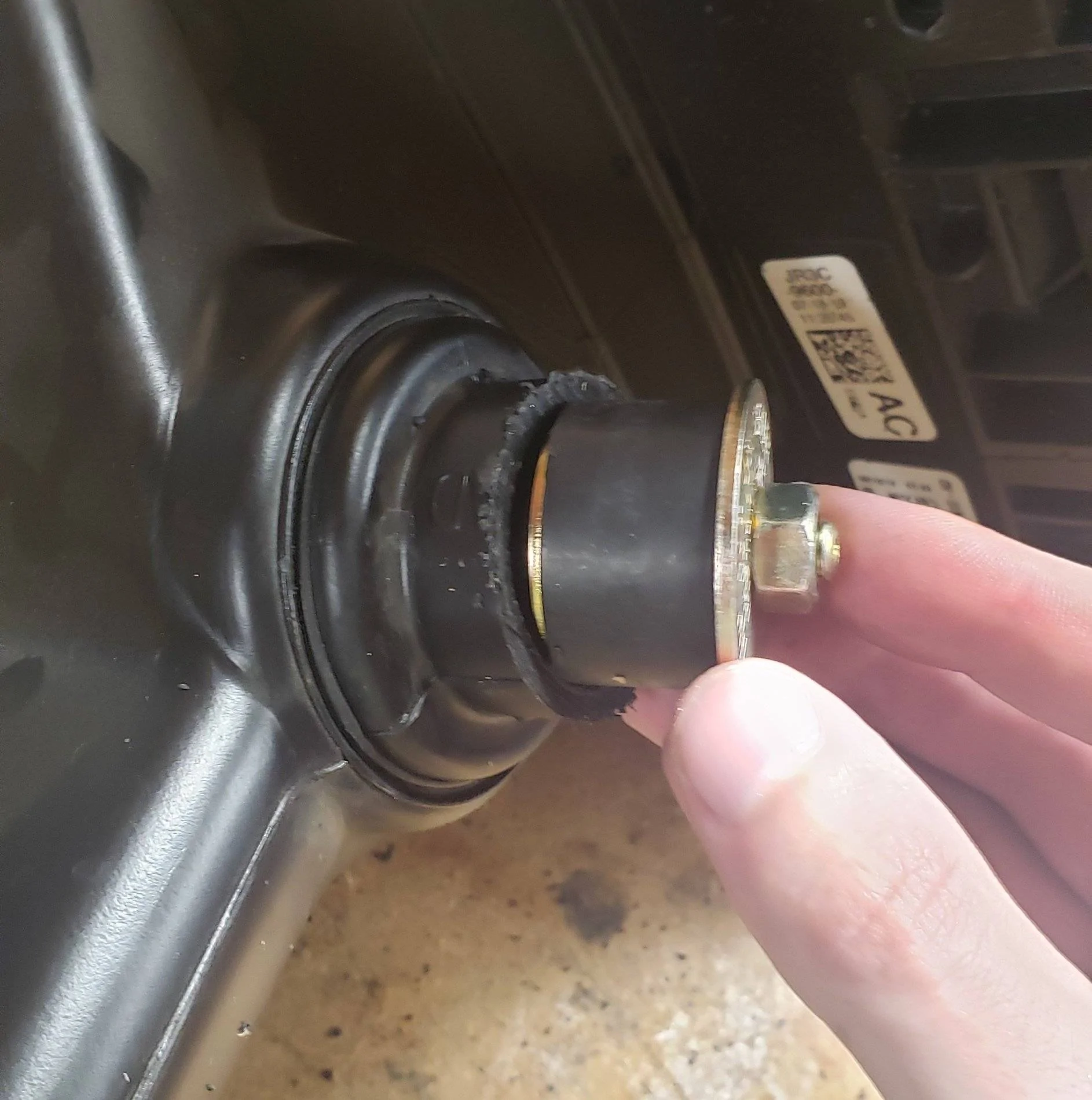

Disconnected the battery while did the install. Happy with the spend... idle smoother, breathes more easily, and throttle response is better, seems to effortless now....works well with Garrett IC. Seems to have cured the high pitched whistle was occasionally getting under high load at 2700-3500+ RPM.
Hard to believe this is from a simple tube that looks like it costs $10 to make.
Grommet hole was too small for the ALU insert alone ....and too close to edge of the contour change.....had to bore it out so grommet and ALU insert would fit at all. Took 15 min max to install.
Have an AEM dry filter on the way.
