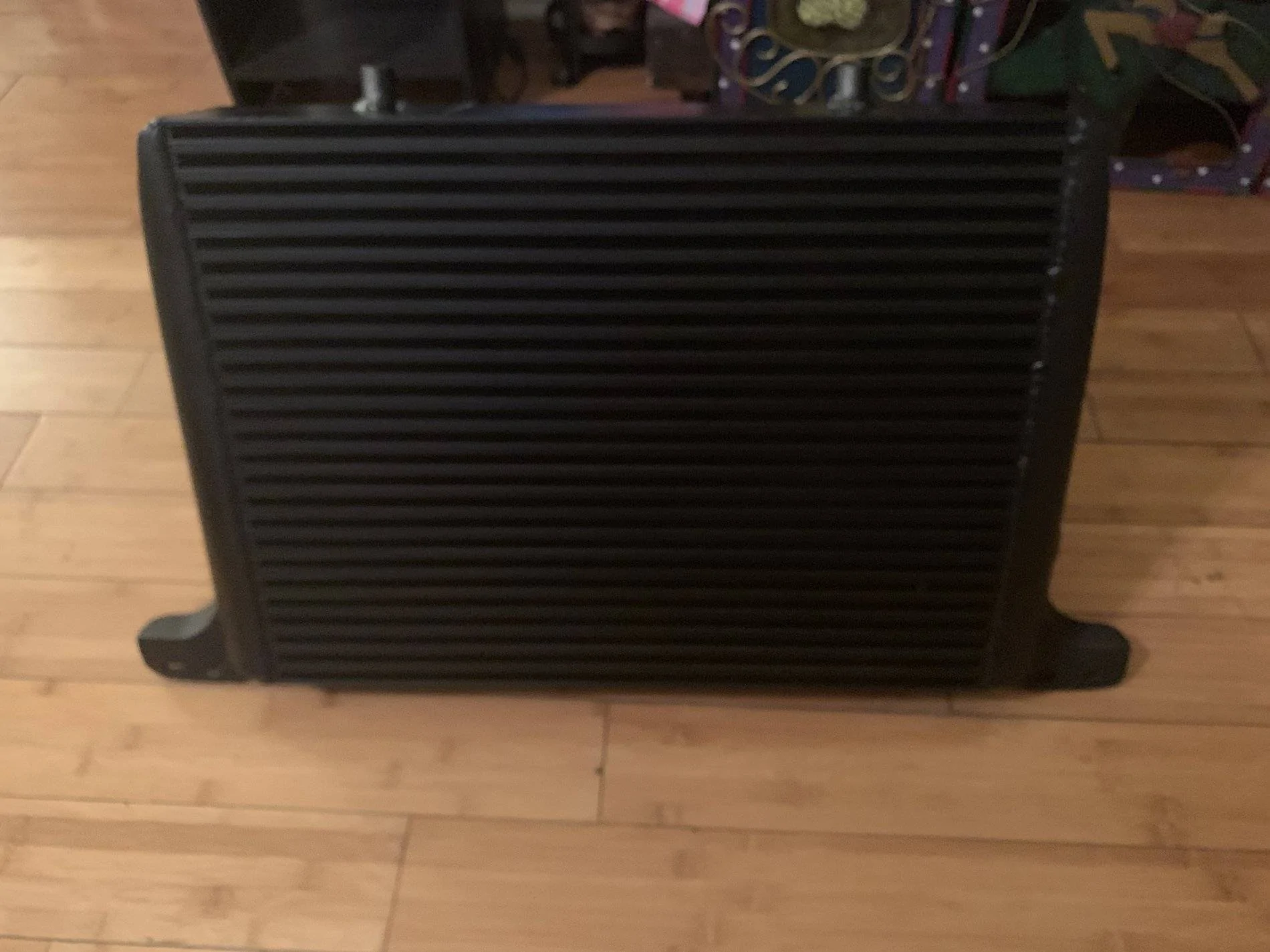

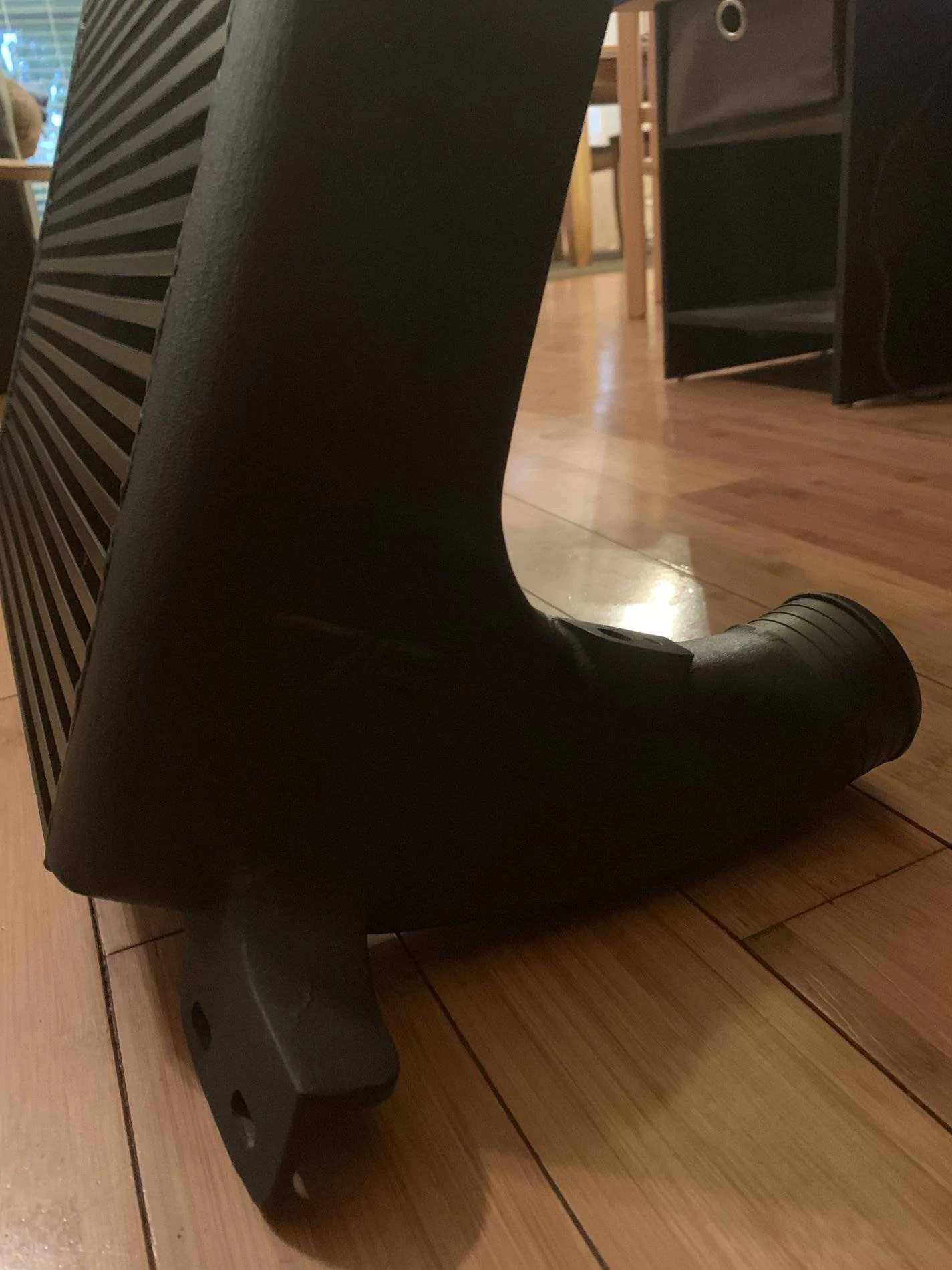

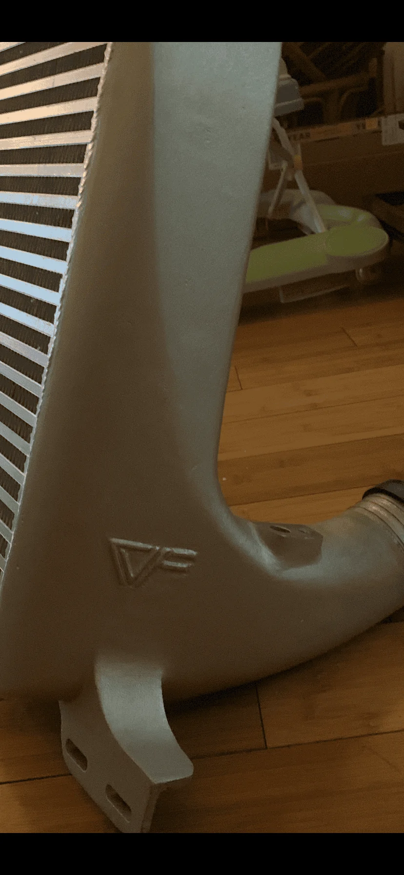

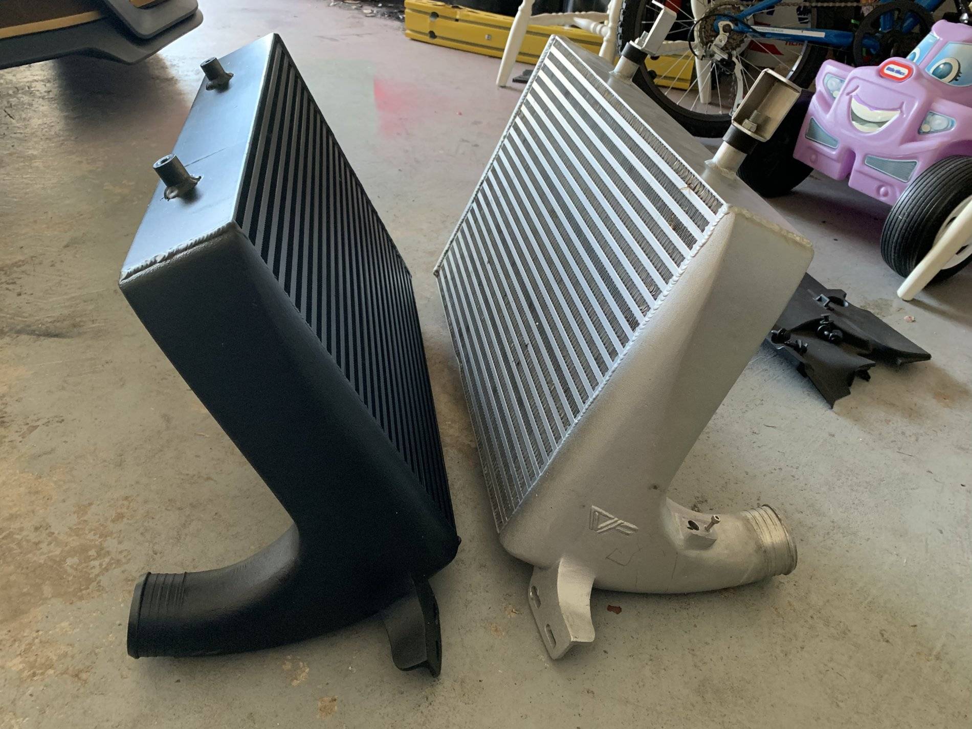

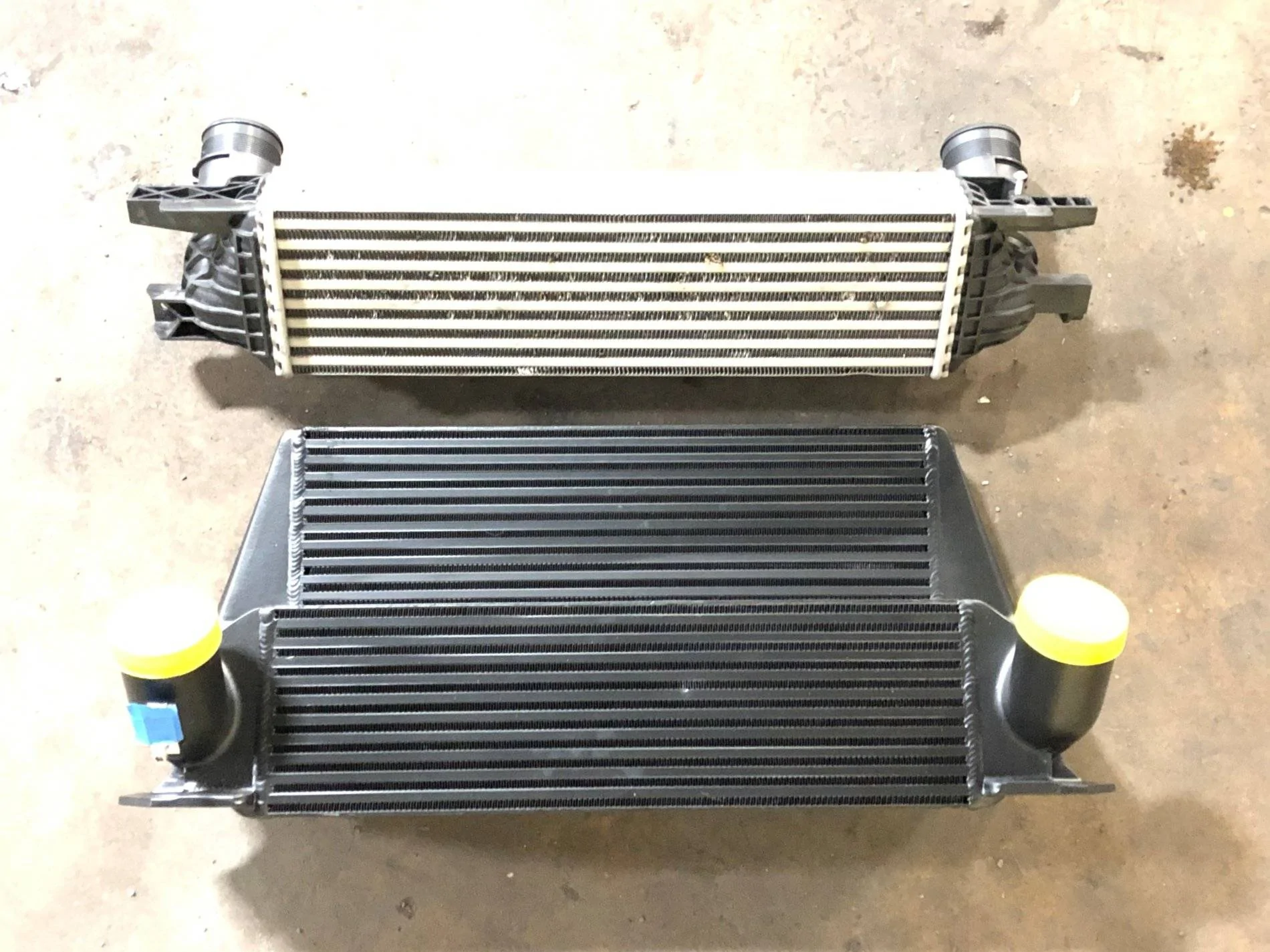

I have now installed 2 CVFab race core intercoolers on my car. The first being a test unit and now the “final” product. The test unit had perfect fit, great build quality, and excellent performance. Even tho i was told the final product would have a “better” performing core... i didnt believe it could be much better. I was wrong.
Build quality... its built like a tank. The mounting points are rock solid and also has some bushings to keep shock/vibration stress off of each point. Cast end tanks... not welded sheetmetal.
Fitment... its an absolute beast. CVFab has managed to produce an intercooler that takes up every bit of usable space, and maintain perfect fitment.
Performance... Jason Anderson has all the data so ill leave that for him to post up. But i will say that it is pretty amazing. And yes, the core being used in the final product does actually perform better than the test unit i have been using for the past few months.
Bottom line... if you are in the market for an intercooler, this is the IC you should be looking at. Top notch fit, finish, and performance for under $500? Its really a no brainer.
Silver is the test unit. Black is the final product.

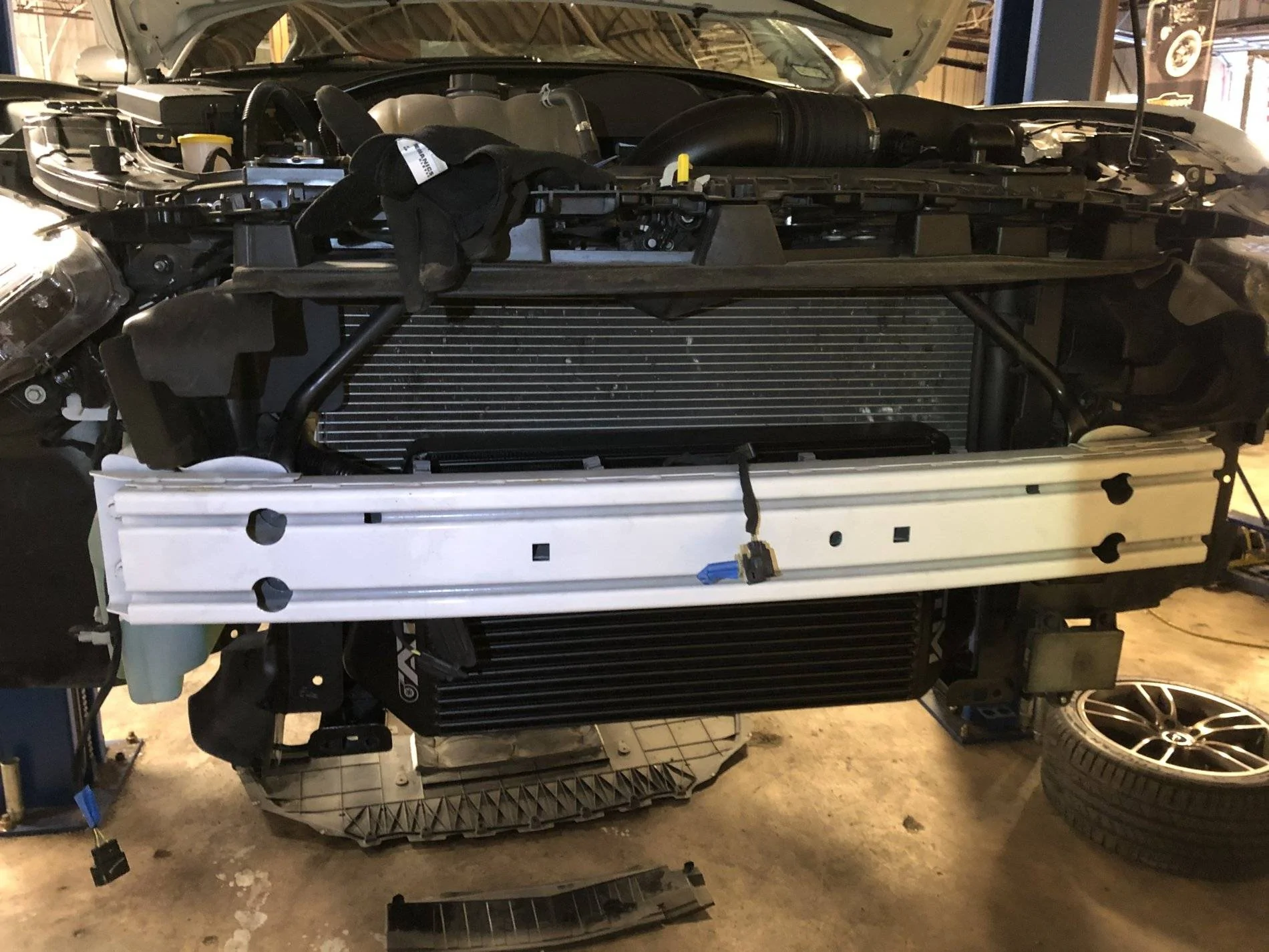

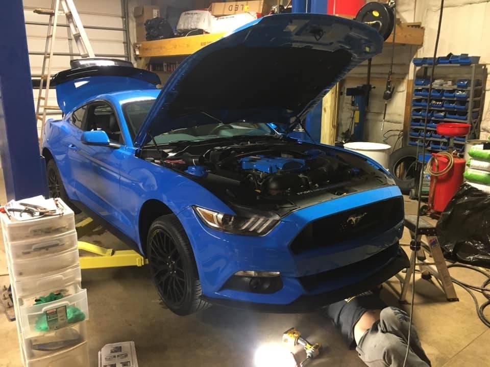

Got my ATM installed today. Took a lot longer than I anticipated, but I haven't taken a new car apart before (lots of 60's cars), and since this is my daily driver I needed to be sure everything was 100% right. Found several things on my '18 that were different than the videos show for '15-'17, so that was an issue, too. Overall, it wasn't a bad experience and it's running great. Haven't had chance to compare performance by Track Apps yet, but she's definitely not suffering in any way.

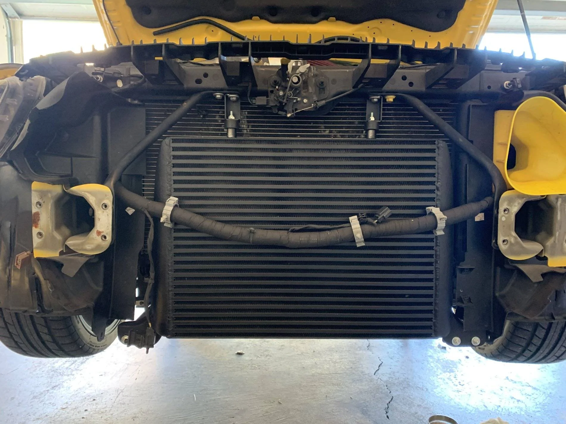

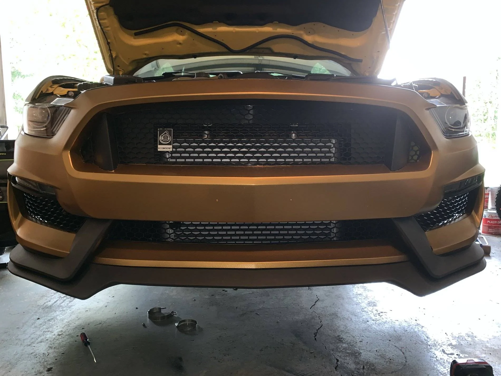

Installed the Cpe intercooler through belly pan on my eco, wasn’t bad took about 30 mins

About 7 hours for my job... but I probably could have done it in 6 if I had rushed...
Didn't know that was even possible... I was under the assumption that you must remove the front bumper cover to access the FMIC.

nope. Slid it right under. I needed like 1/2 an of clearance on the passenger side (put driver side in first), the very very very tip of the IC was bumping the GT bottom grille that I have in the car just a hair, so my friend just put a little force and pushed the bumper grille part outward and it slid right by. didn't hurt the car at all.
Pulling the stock intercooler out was cake, it fell right out. its just the new one was beefier, it was like playing Tetris, you had to figure out what direction and angle to slide it in to make it work. took us about 2 minutes of trying/rotating before we realized, shove the driver side in first, then pushed the passenger side up.
we also didn't hook the brackets to the intercooler before install, we did it after we had the intercooler up there, that way it was less things to be in our way pushing it up in there.
My car did not have AGS from factory. so if you have those, I doubt it'll be possible.
pull that belly pan, and its literally, full access to the IC. 4 bolts on bottom metal piece that goes across bracing it in, unclip the little sensor on driver side, and it pushes up and out, little clip looking mechanisms.
Interesting....

So literally slides up in there, just need a slight of flex on one side it was so small that it could very one car to the other.
I refuse to take my bumper off, I do not want those bumper clips I see a lot of members have from bumper accidents
So if you don’t have active shutters, be aware you can make it work. Fmic anyway
unfortunately, I do have the active shutters. guess its bumper off if i decide to change out the FMIC
