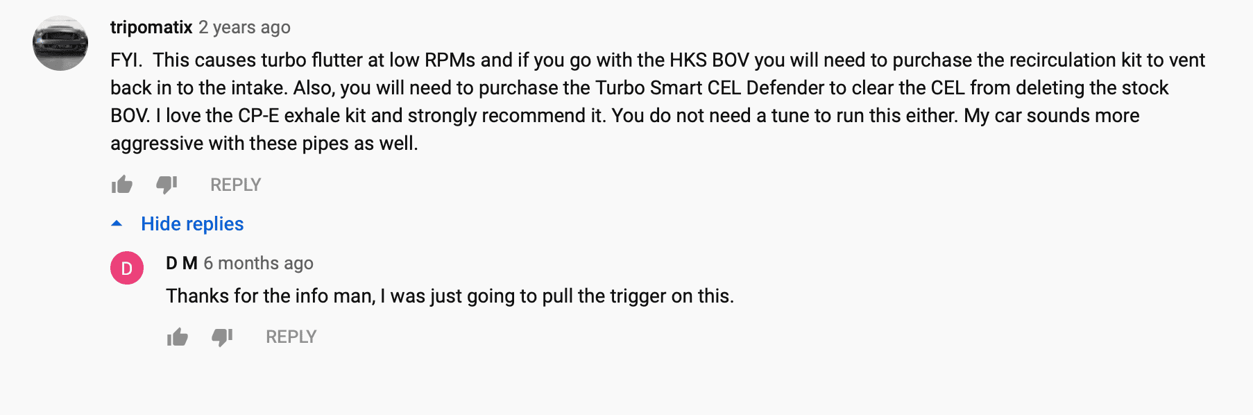

I have HKS bov / cold side CPE kit currently. my hot charge pipe is stock plastic. If I am replacing the intercooler to CPE this week, should I order a cpe hot side pipe? I can get it for 170 including the tax on top of order since CJPP has 75 off 500+
I looked up a video about the pipe on YouTube and a guy commented this under the video.- link below
What the hell is he talking about? I don't have any flutter right now, why would I get flutter by changing the pipe to a slightly larger pipe? So there's minimal pressure drop on the CPE intercooler, would adding the larger pipe, add more pressure drop? My cold side is already 2.5 inch, would mating the other side to 2.5 benefit me or hurt me performance wise?
Thanks!!
I also don't like wasting money, but if it would have any type of benefit and nothing negative, I'd toss it in since it will all be apart anyway.

Chef jpd
Apr 1, 2016
63
2,989
3,121
Brooklyn, NY
John
Your setup will work perfectly.
You will experience no loss.
Ignore the "maybe" or "should".
With what you are getting, you will realize the full potential of the tune.

I went ahead and ordered the pipe, figure if the cold side is 2.5 and the intercooler is 2.5 might as well make the entering hot channel 2.5 to match the set.
I ran the cp-e Exhale Cold pipe and cp-e HOTcharge Hot pipe on my 2015 with zero issues. In fact, it reduced flutter and was more responsive due to moving the BOV over to the cold side. I first installed the pipes with the OEM intercooler, then a month later upgraded to the Mishimoto intercooler. Again, no pressure losses and more power since my timing wan't being pulled due to heat soak like was happening with the POS OEM unit. Whoever posted on AM about the cp-e pipes causing flutter had something else going on with his setup.

I don’t have any fluttering or anything w the cpe hks cold side, so that confused me wondering why just changing the pipe from plastic to slightly bigger metal would cause flutter.
I do read people having flutter using hot side tial/hks though. But may be isolated.
